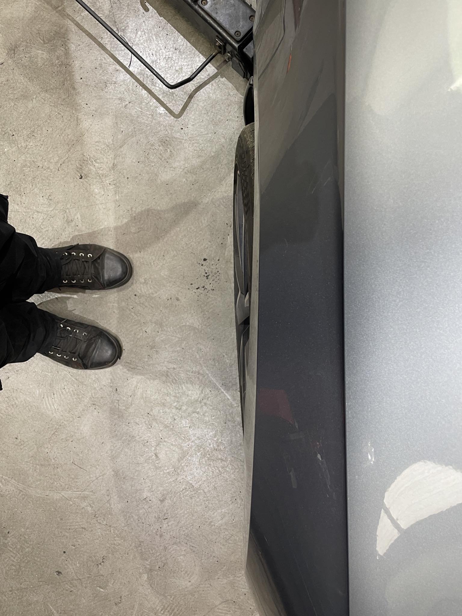

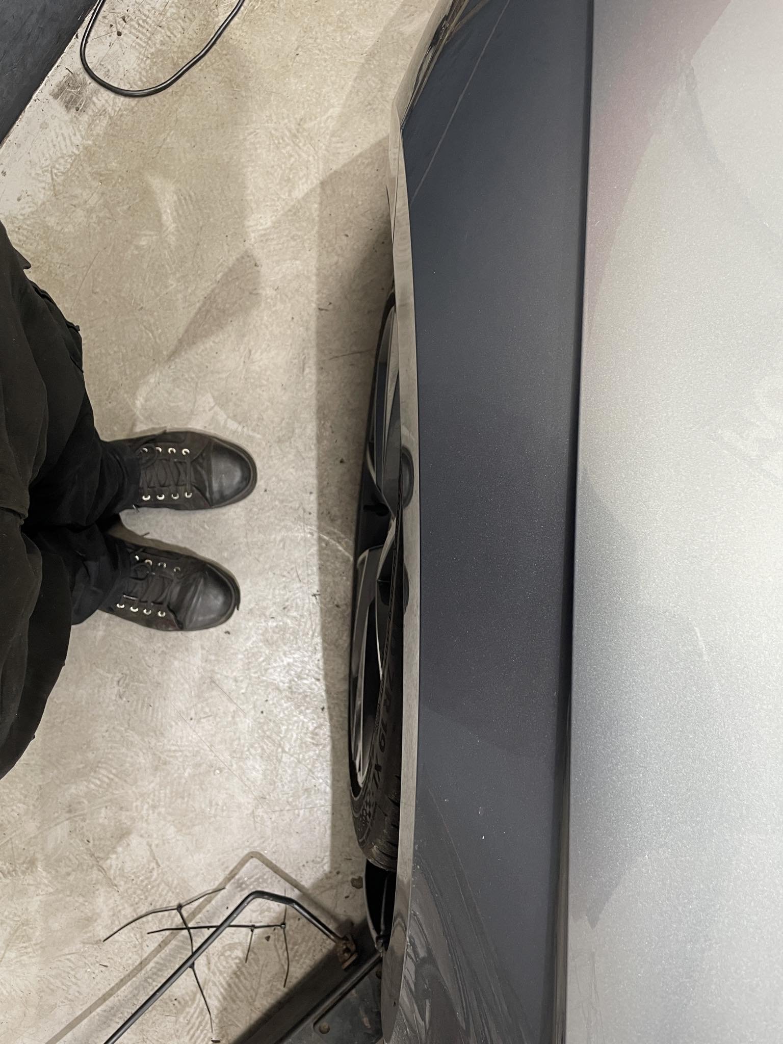

Wheels toed in too much after replacing front suspension
Having my Sportline 280 in garage for lot of suspension work, fitted H&R sway bar kit (front and rear) Bilstein B6 shocks, strut mounts and bearings , heavy duty adjustable droplinks front and rear and Superpro lower arms TRC1070.
Everything has fitted fine but mechanic just called me to say front wheels are toed in quite a lot!!! Wheel alignment has not been done yet but it shouldn't be out this much or am i wrong? Is alignment likely to solve this or the arms are shorter? I know few people fitted them on superbs without issues

Yeah so it seems 🤔 i know there is a member here who got it aligned and it's working fine but few had issues with them... it's going for alignment tomorrow. Worse case scenario I'll just use the oem ones
Yep 100% super pro arms are shorter for the golf so you’ll lose a load of track width which in turn will pull the toe in until it’s aligned. Then it’ll look silly because it’s 12mm narrower on each corner.
