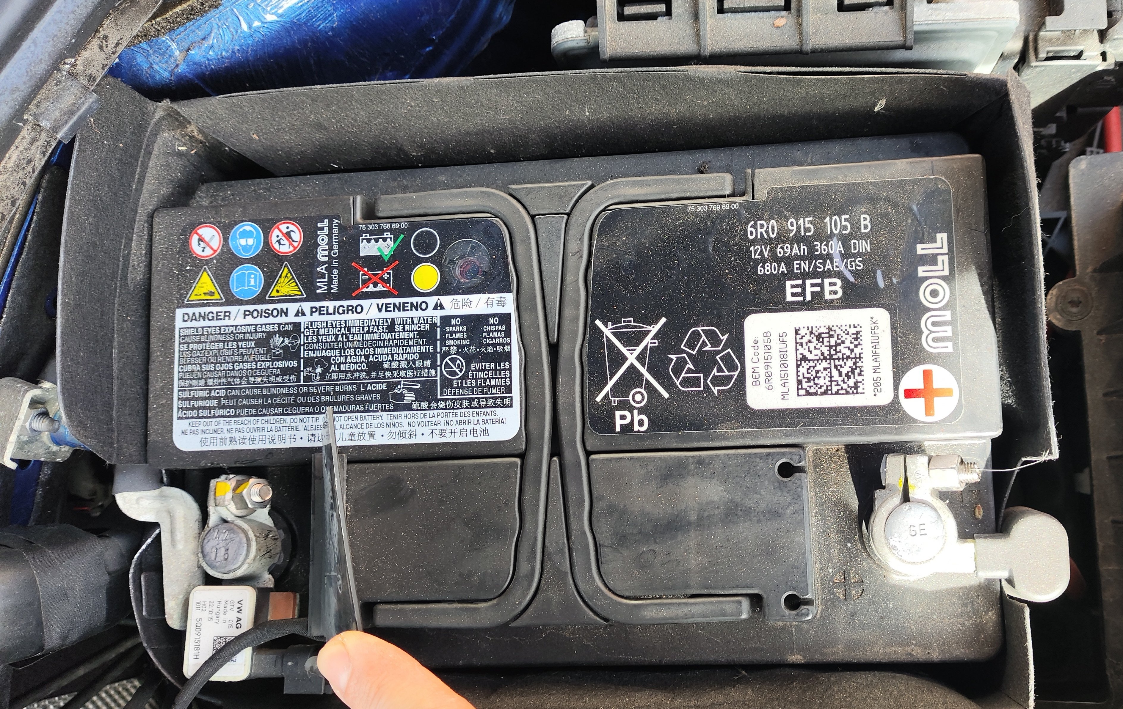

So my 2015 Octavia VRS was supposed to go in for an MOT yesterday but the damn thing wouldn't start, as soon as I got in the car I noticed when I turned the ignition that all the dash was very dull, turned the key 1 click sound and nothing, great!. Have a little CTEK charger pack so hooked that up and left if for a few hours, but even then turned it on the dash was bright again but turning the key just resulted in multiple and rapid clicks now. The entertainment head unit informs me of low battery and looks on the battery itself the yellow indicator is showing still even after being charged for 6 hours.

Have attached a photo of the currently fitted battery, not sure if that's a stock battery or no but have that car like 6 years and never replaced it

Good morning, that is probably the original battery and it is most likely that it has failed. Prior to this failure, was the idle stop-start working as normal?
Replacement battery will require adaptation (coding) - this really should be done even if replacement is exactly same spec and chemistry type as original. You will require EFB battery as a minimum.

No, no issue with start stop at all. Only thing I did notice was when I went to the car it was unlocked and I'm certain I had locked it the few days before. Can any garage code the new battery?
Will I notice any difference going with an AGM over EFB?

AGM life and performance is superior to EFB, but will cost more.
You will definitely need to get adaptation done if changing battery type to AGM - even if the replacement battery is exactly the same as original, you should still get the adaptation done, as it is probable that the smart alternator control unit settings will have altered to cope with any battery errors detected.
Not all battery suppliers have the equipment (or are even aware of the need) to do the adaptation - ensure that you ask - walk away if they say it's not necessary.

I think the CTEK one i have just has  modes, Bike, Car and Cold Weather don't believe it has this restoration mode you mentioned. I guess i could get some jump leads and jump start with my works vehicle and leave it running for a hours or so maybe this would give it enough juice?
Regarding getting the new battery adapted/coded could i not get the battery and then get the adaptation done a few days later? or will it not work at all without this?
Ah, so no "RECOND" option on your CTEK.
Bottom line, as usual "needs must" if you can't get this battery into a useable condition, then you might not have an easy option, running the car for a short period in terms of days, is not going to cause a big issue, but, do prioritise getting this done as it should improve the service life of the new battery.
That should not be an issue - especially if your replacement is another EFB. Make sure you do get it adapted correctly asap though.
