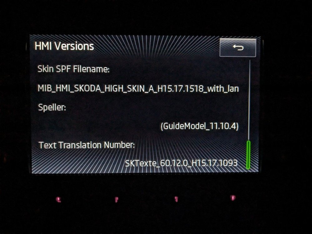

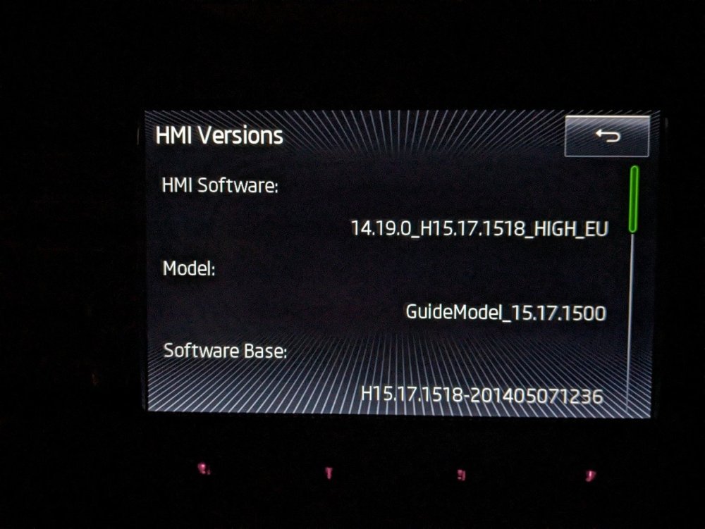

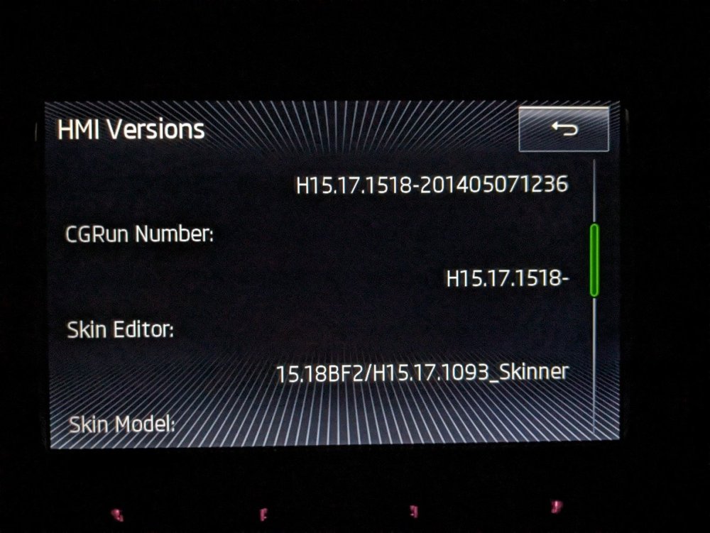

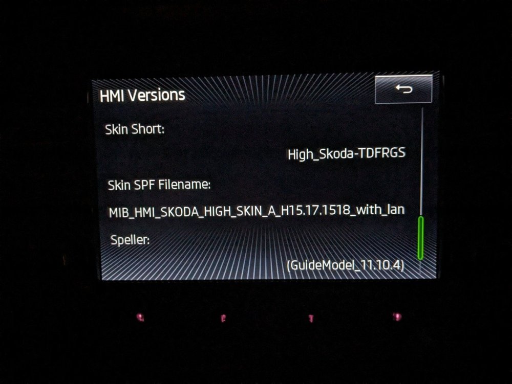

Earlier today I took it upon myself to install the latest firmware 0411 on my Columbus MIB1 with Canton. When returning to the car this evening I couldn't help but notice that, when muted or on a low volume, I can hear a static like 'hiss' sound.
I don't know if it's related to the firmware; but after hearing this issue I scanned with OBDeleven and got the error 'B201A00: Checking software version management' which apparently relates to the Canton AMP - I followed the process on mib-helper and cleared it via OBDeleven and unfortunately, even though the car no longer reports any errors/issues on rescan, the hiss is still there.
Is there something I need to do to readjust the Canton system given that I've updated the firmware? Can I even revert it back to what it was previously on? I literally have to turn off the radio to get the noise to stop.
