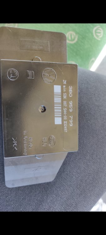

two door control units (dismantled from an octavia identical to mine with the same phase 1 dashboard and the comfort module identical to the one installed in my car (from a 1997 Passat)
Neither by changing the two control units nor by changing the comfort module can the door work.

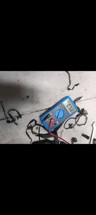

I have disassembled the bellows and I have not seen anything broken even after removing the tape. In the connector of the passenger door control unit, the CAN line arrives correctly (3V as well as the pillar connector (purple cables) and 12V voltage through both the red and yellow-red wires😔

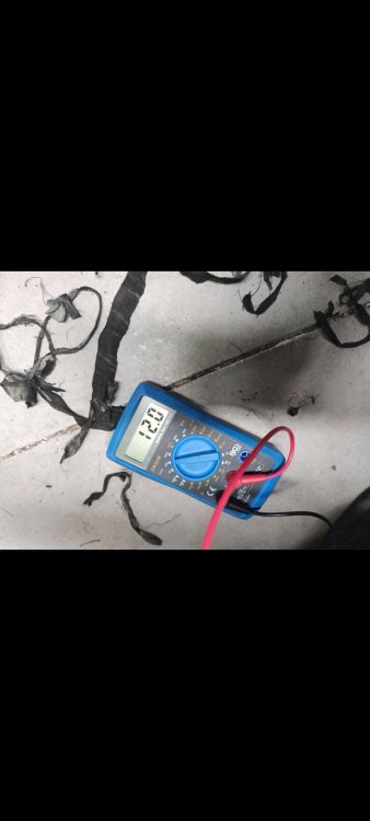

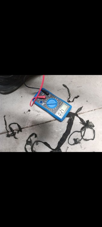

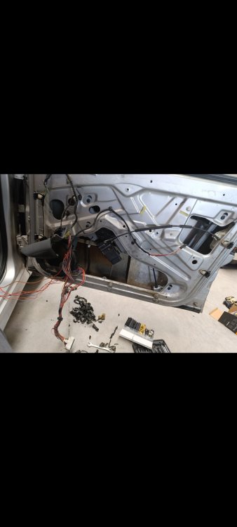

I have removed the door panel and removed the installation, I have checked continuity in each of the cables and they are all good, they all have continuity.
I took it out from the pillar of the car and cleaned the connector as well.
 for the operation of the door there are 5 cables, 2 positive, 1 ground (checked) and 2 can line cables. I have checked the power and both positives get 12V and line can 3.8V.

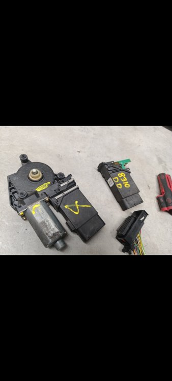

I have even tried with 2 other door control units that I have.
I have also replaced the lock with a new one in case that was the problem and the door still does not work at all, neither rearview mirror, nor window, nor central locking. this is exasperating....

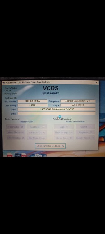

Could it be that this comfort control unit is not suitable for my Skoda? When I bought it I had it set to scrap and it is from a Passat B5. I replaced it with the same one since it only has 1 connector and the ones in the Octavia scrapyard all have 2... my car is like a unicorn
