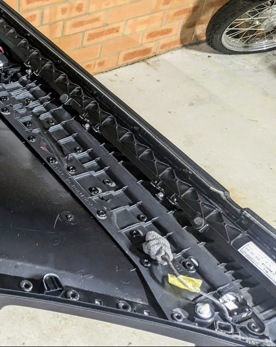

The ambient lighting trim bit is plastic riveted to the door card.
U can see it in the pic below.  This is my rear door card.
Well that's.... a lot of rivets. That's what I thought. I wasn't sure if I wasn't applying enough force when trying to pry off the trim or if it was riveted. It's going to be a nightmare to replace that panel if it ends up being the optical fiber. At least the LEDs are easily accessible. Thanks!
The trim piece with the LED strip incorporated can be had new for around £150, you’ll need the replacement metal rivet caps to fit it after drilling out the OE plastic ones.
Fairly straight forward process
