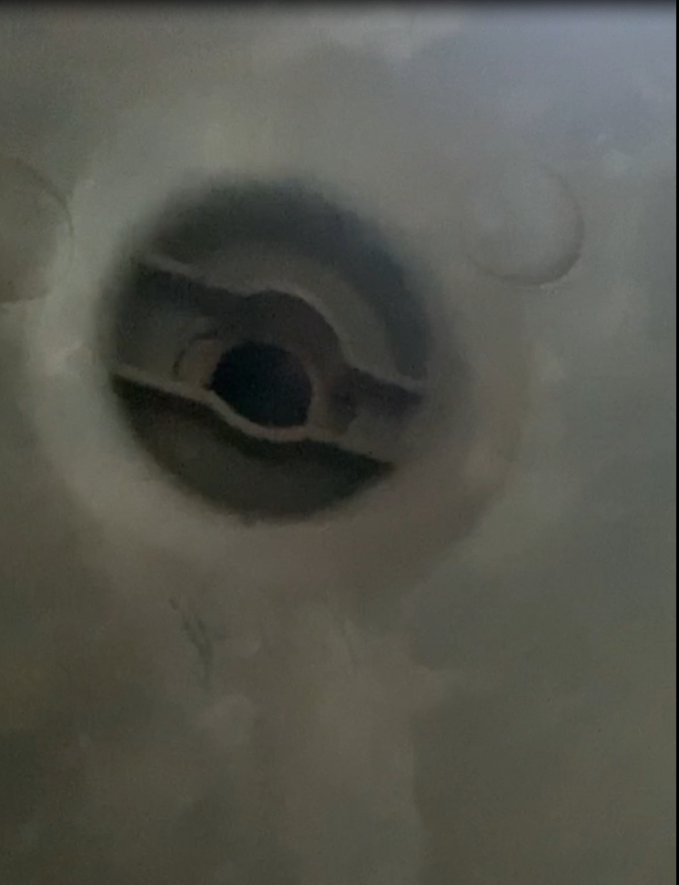

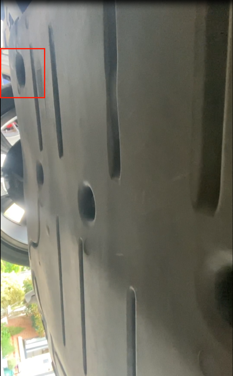

I finally had a good look underneath today. The under tray directly between the front wheels appears to be missing two bolts/clips leaving the under tray to flap around at the edges and rattle when driving.

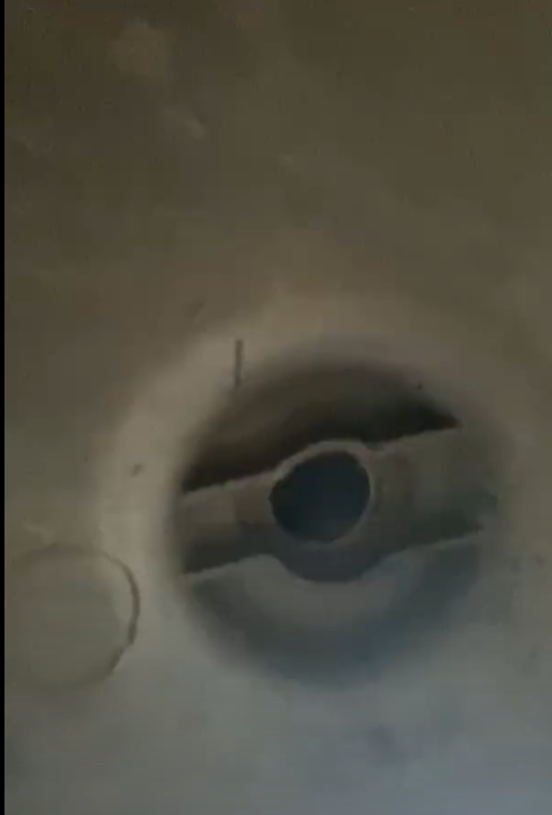

I have highlighted the place in question on the first image (same thing is actually missing on both sides) and in the subsequent images have shown the hole where the bolt/clip should be.
I am wondering if anyone can help identify the bolts/clips i need to secure the under tray again?

The two that are missing seem to be unique among the others. They are towards the back edges of the under tray between the wheels. As shown in the images they have a distinctive bar type inset across the hole.
I think after a process of trial and error that this is a "spreader rivet" fixture. Number 5 on this diagram.
https://www.lllparts.co.uk/product/5WA825267A/spreader-rivet
