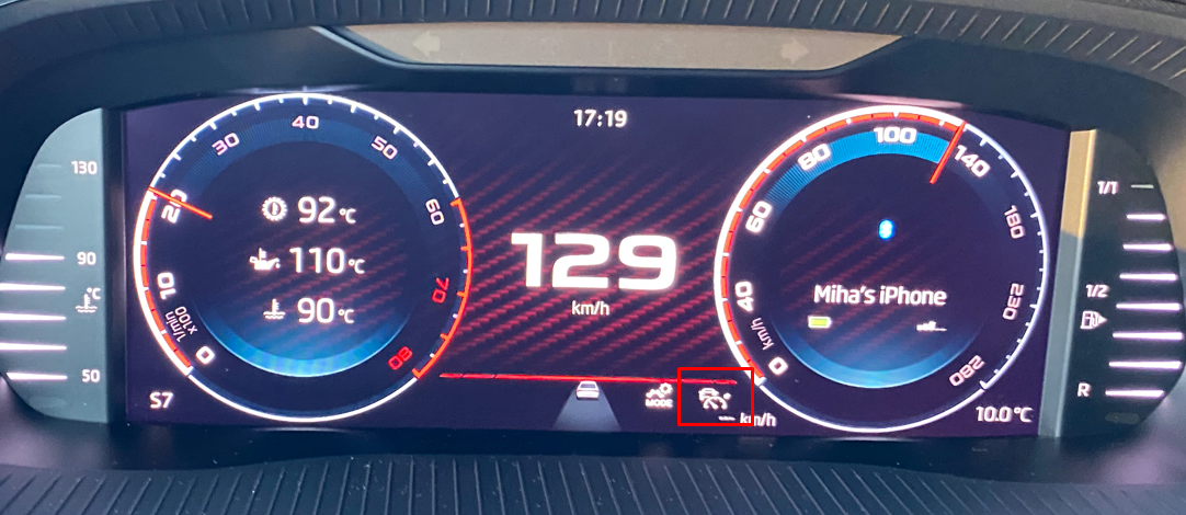

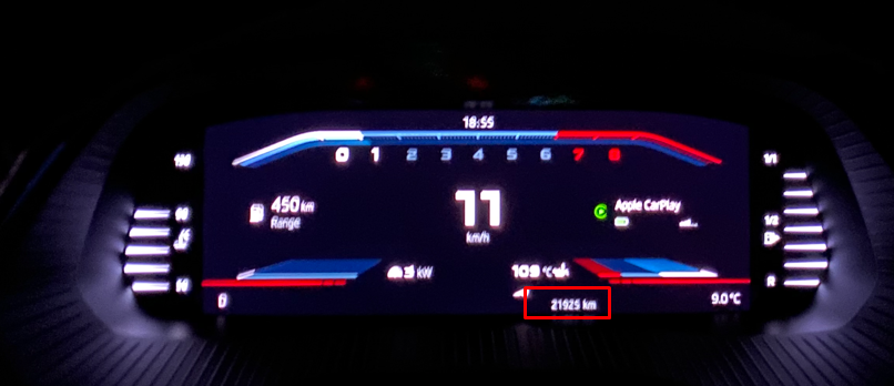

Do you have digital instrument cluster? If yes, you need to disable ACC by pushing ACC stalk away from you. By doing this, instead of ACC icon total milage will be displayed.
ACC enabled
ACC disabled

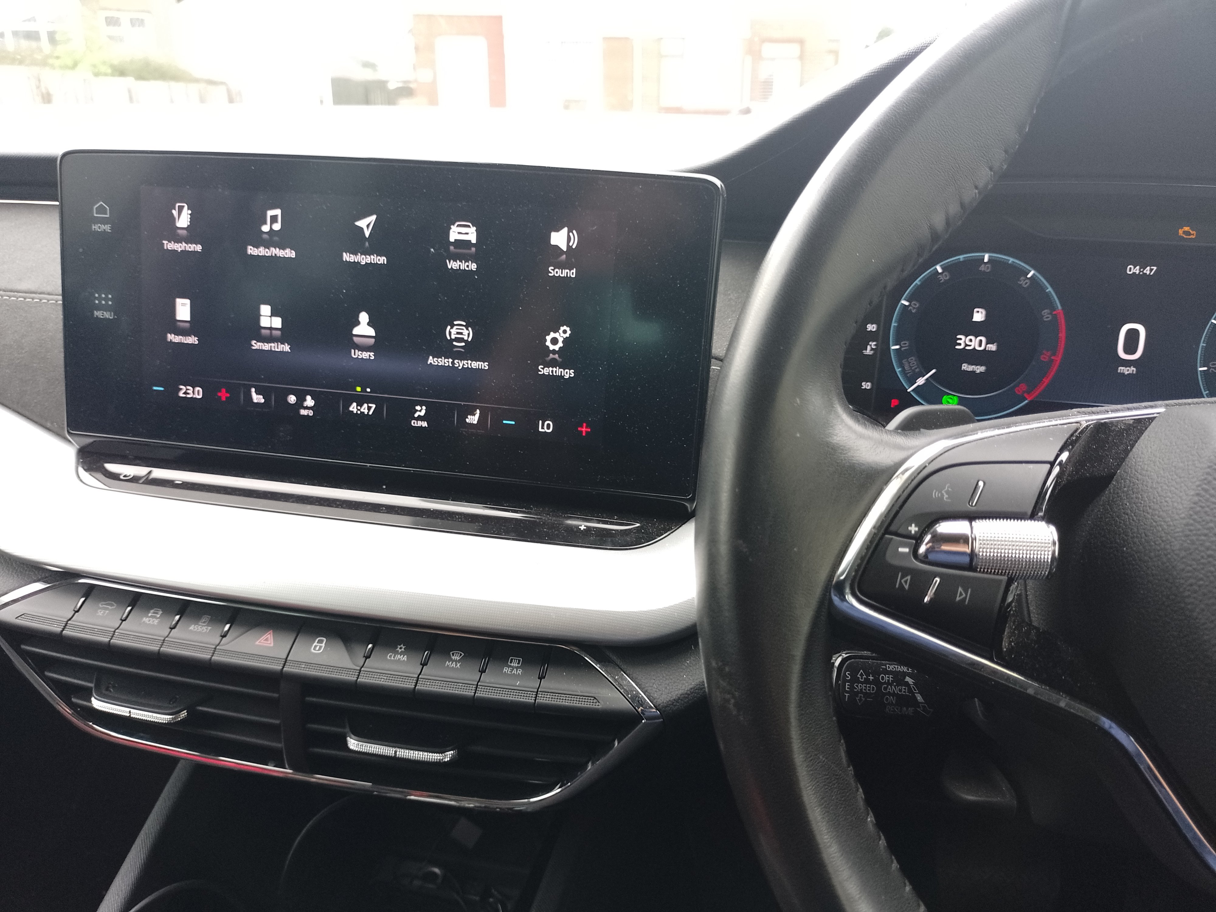

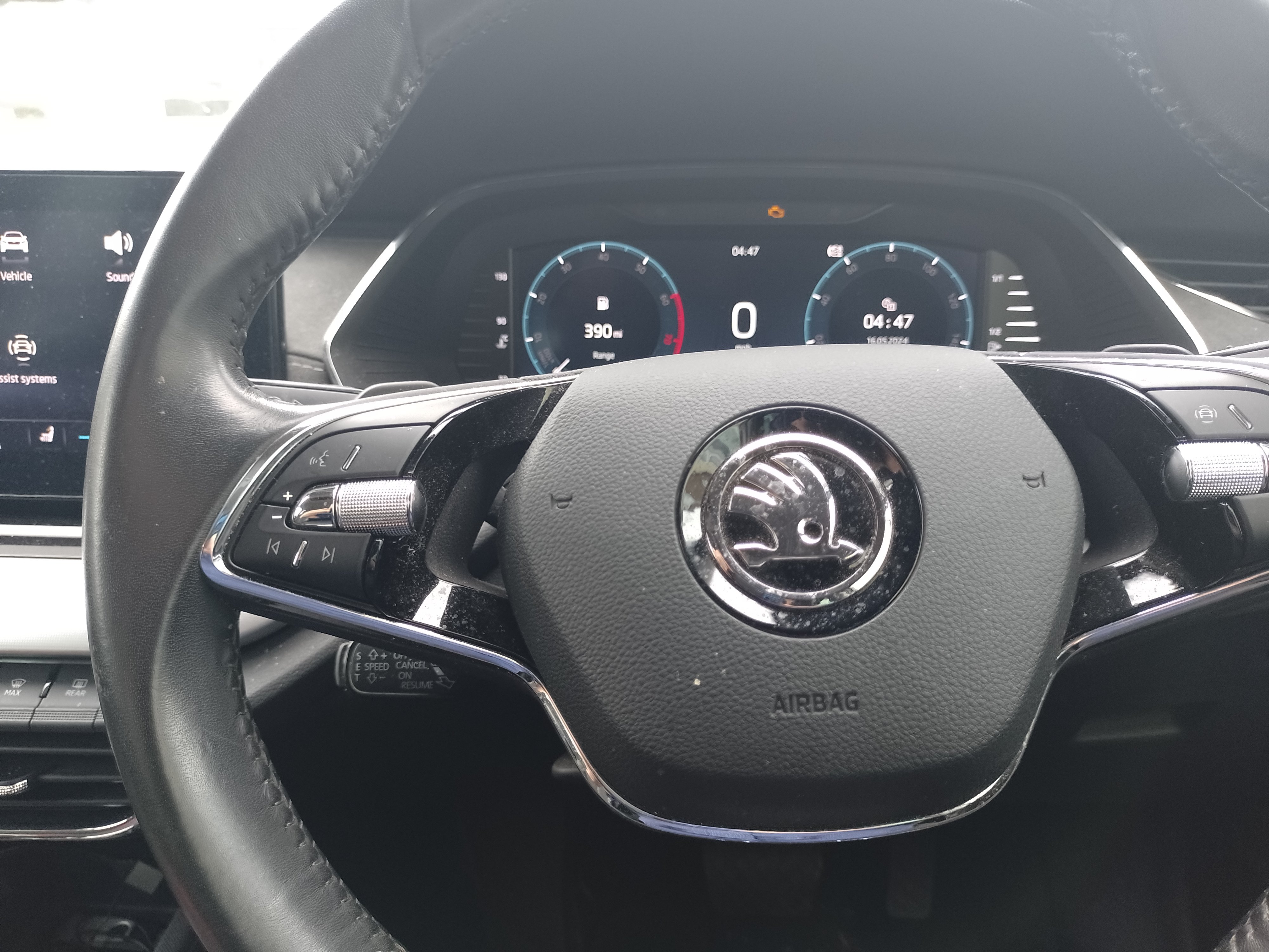

Thanks for the responses.  I'm trying to find the total mileage since new.  Two photos of dashboard attached.  Thanks

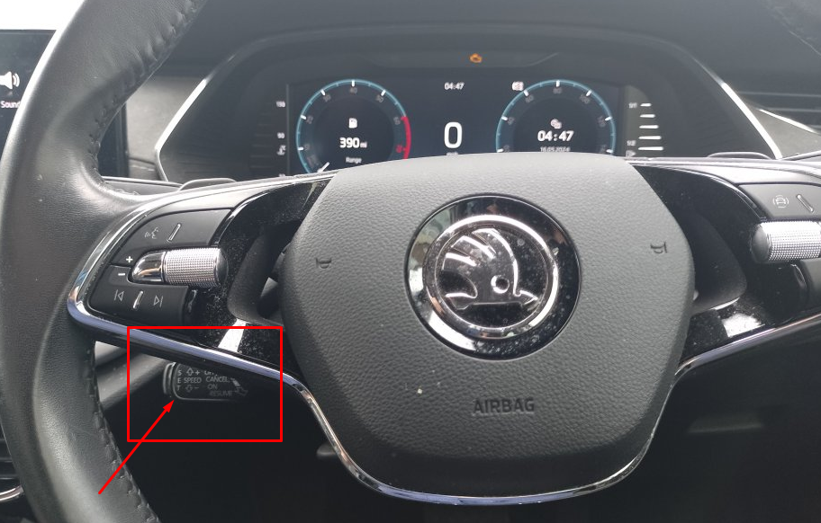

Please read the previous post as he told you how to do it, and when you take a photo make sure you take the whole dash, not half covered with the wheel
Push this stalk away from you and the total milage should appear in the bottom of your digital instrument cluster. The one in front of you, behind the wheel.
