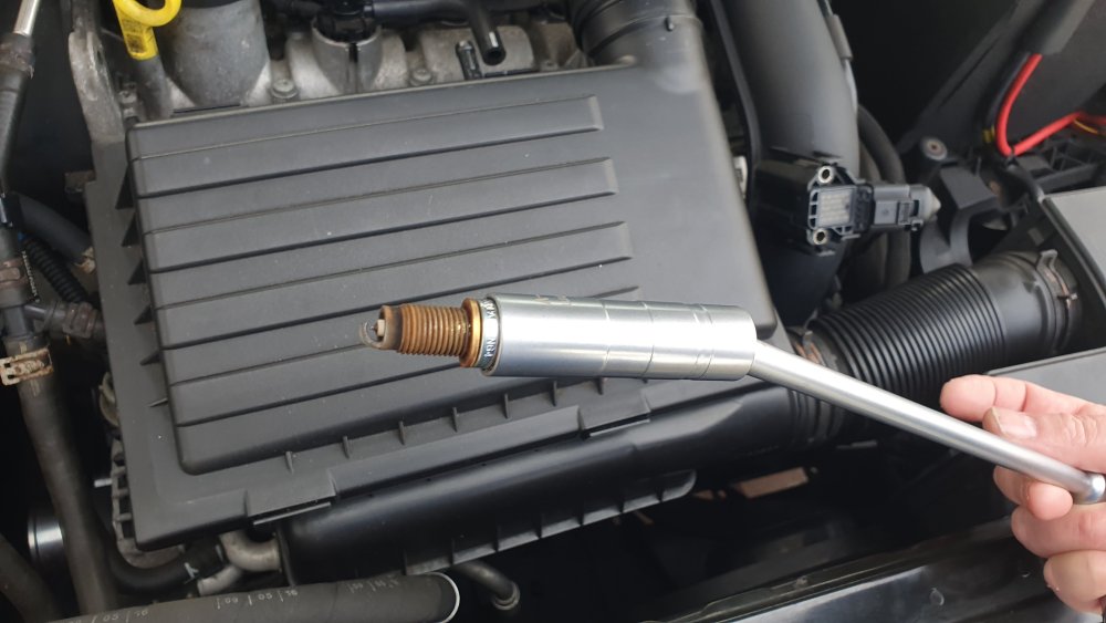

I changed them in my 1.2 TSI Yeti after 4 years. Can't say by their look they really needed it but for £40 I changed all 4. You need a thin wall spanner to get in there.
So I don't think changing quicker is necessary.
