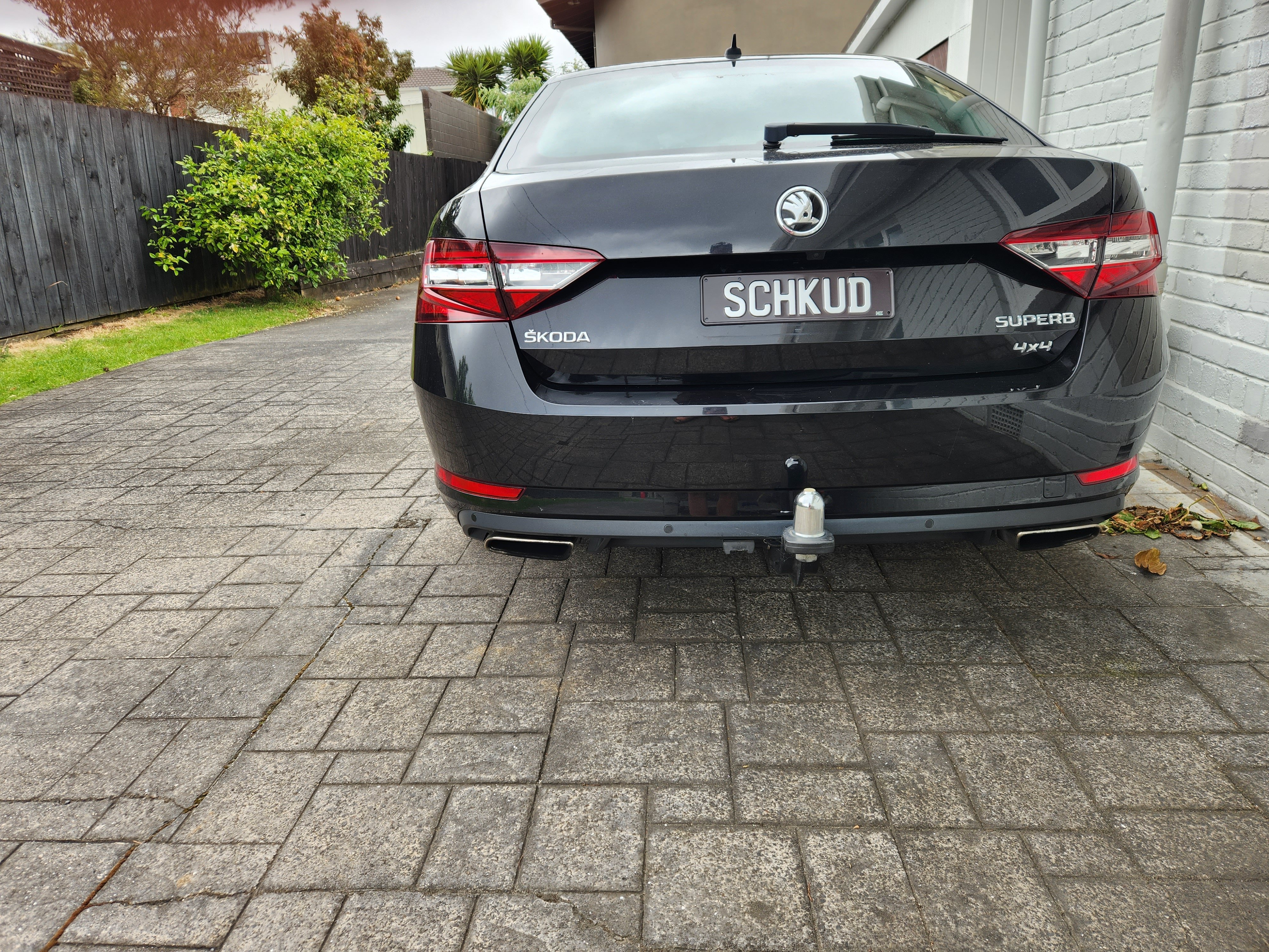

Bought my first Skoda, yet bieng half Czech its clearly been too long a wait!
Since I have a fully worked large turbo Golf R '16 that isnt so family friendly, I found the cheapest Skoda Superb 206kw in the country and bought it sight unseen.
Black on black sedan
Plate = "SCHKUD"
I knew it wouldnt stay stock for long. Im ex motorsport engineer so always mucking with the cars. But for the SCHKUD it wasnt an open checkbook do everything possible, just make it much faster and make it enjoyable to drive. Love the active cruise and Canton sounds. Like a nightclub on wheels.

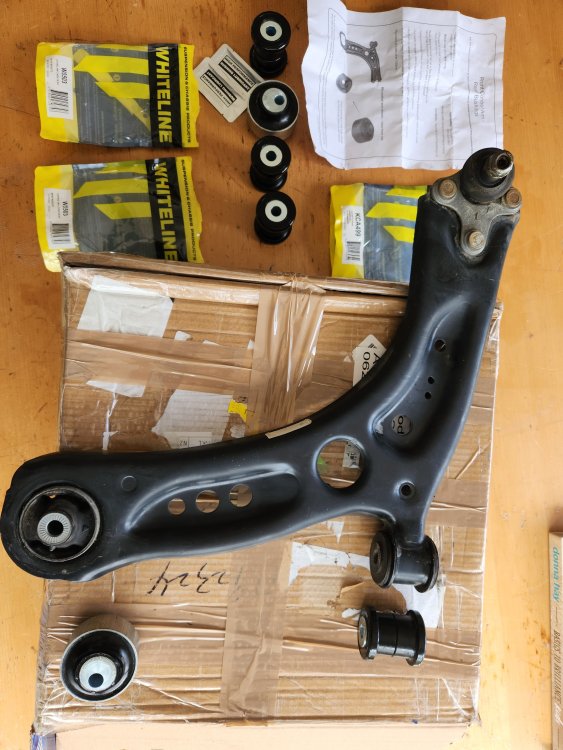

Car felt big and sloppy to drive despite the DCC.

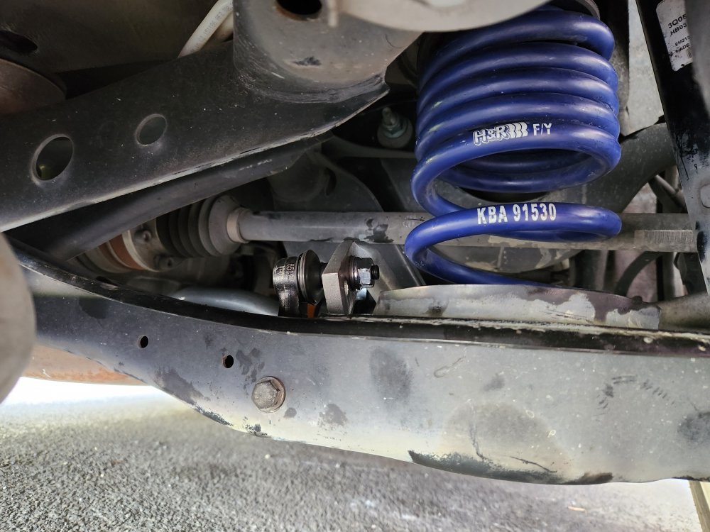

Whiteline lowering springs, Whiteline swaybars, billet end links, Whiteline front anti-lift & bump steer correction bushes have helped no end! Stock control arm bushes had started to rip.

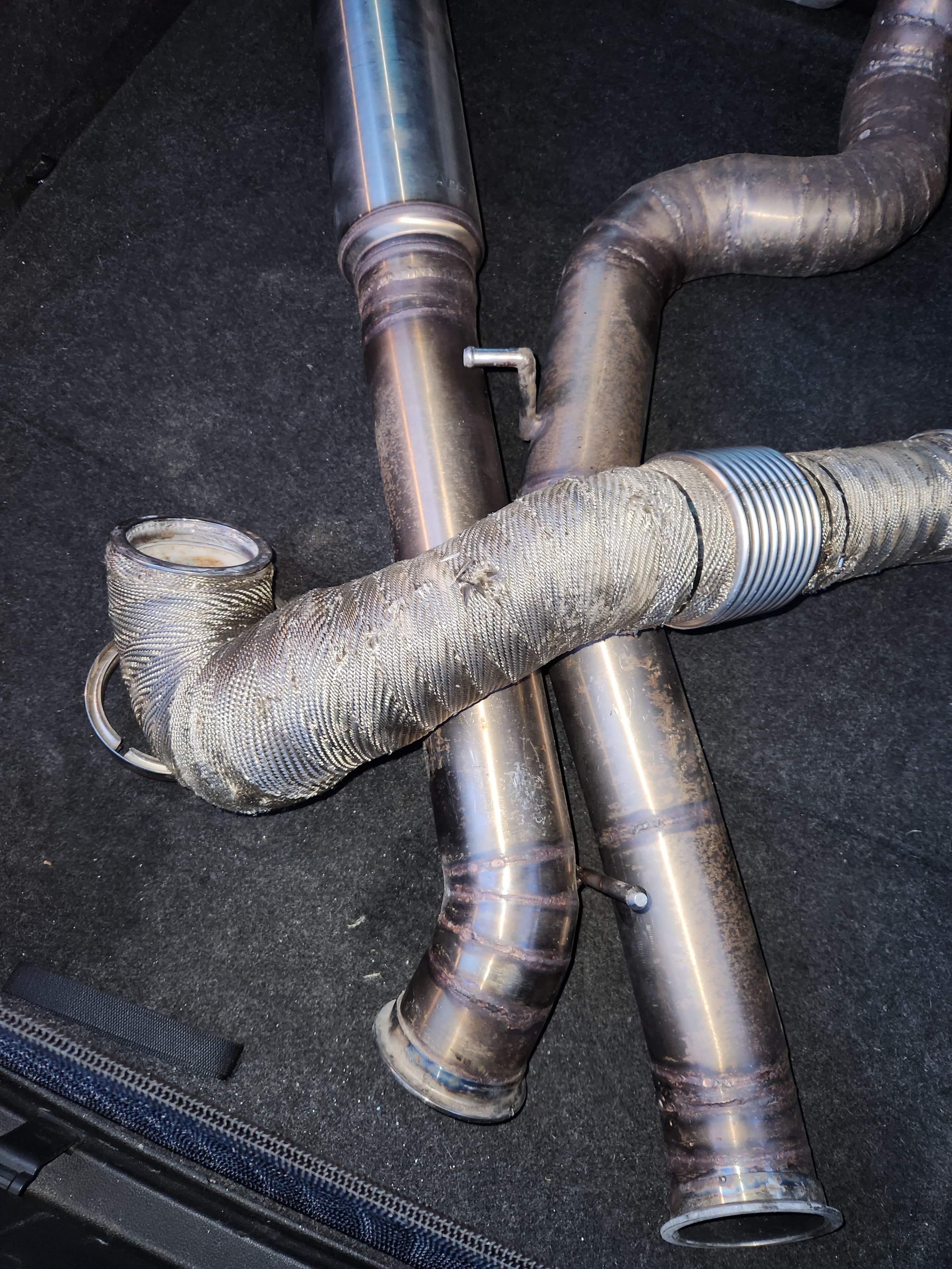

Got a custom stage 2 tune from an Audi engineer in Germany using Alientech hardware for the upload. Custom DSG tune. 4" pie cut down pipe and full exhaust to stock OEM rear box.

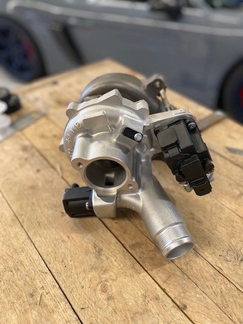

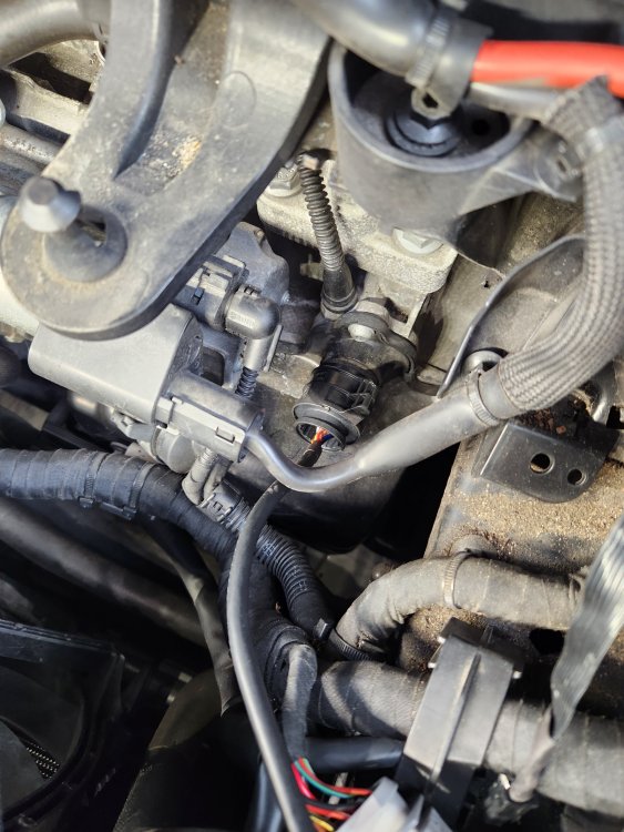

Now preparing for the power part, Garrett G25-660, Autotech HPFP, RS3 LPFP and RS3 EKP and 1050cc MPI injectors and wagner tube fin larger intercooler inc. a meth spray kit sitting on the dining table.

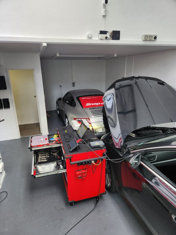

Will make use of a local dyno for the tuning for the stage 3.
Will run a fairly conservative tune to soften the mid range to help the engine, see how long the DQ250 lasts.

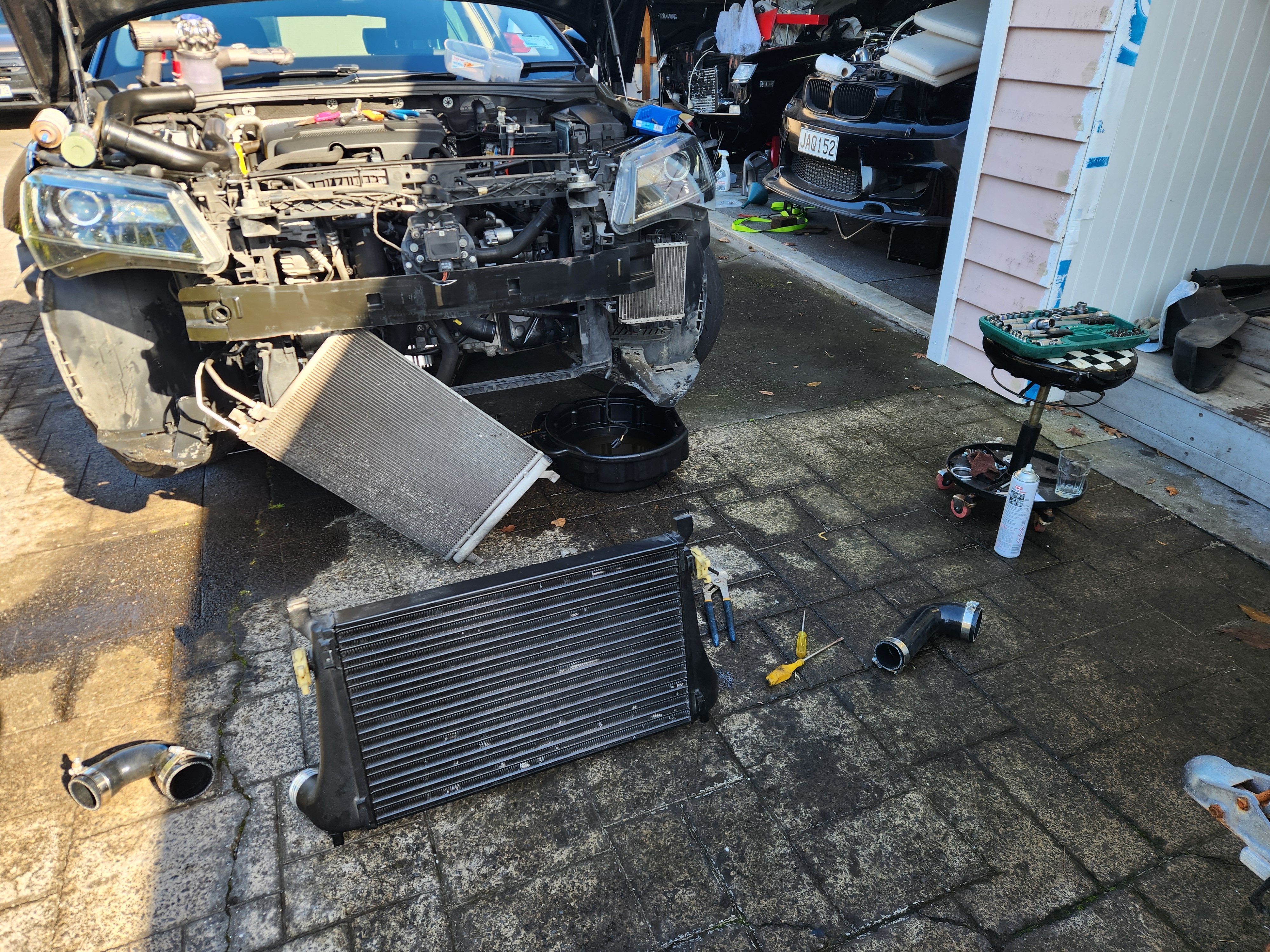

Intercooler upgrade done, tube and fin to keep it light. Did the alternative method of install, left crash bar on, took radiator and fans out method.

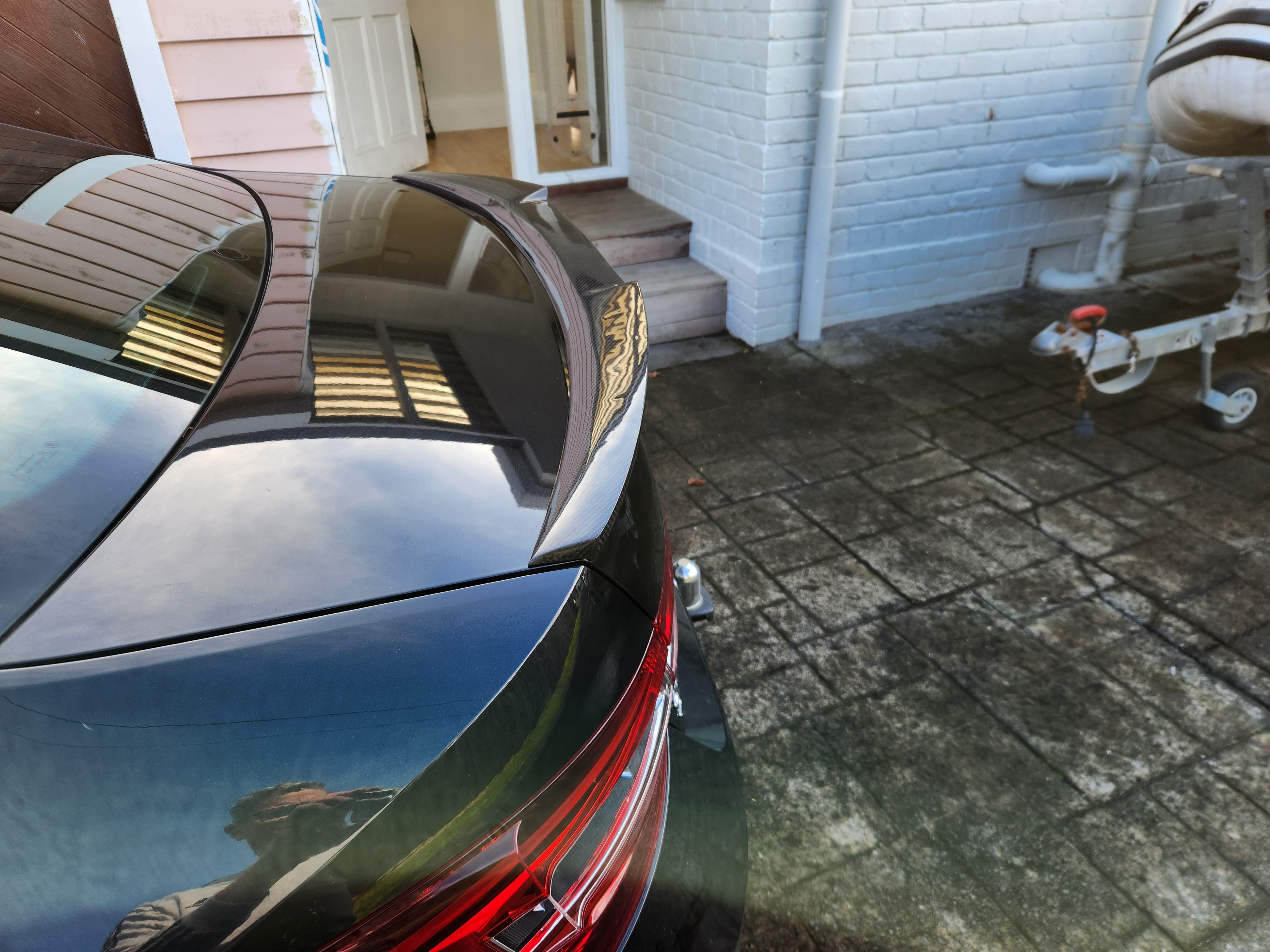

Rear carbon spoiler on

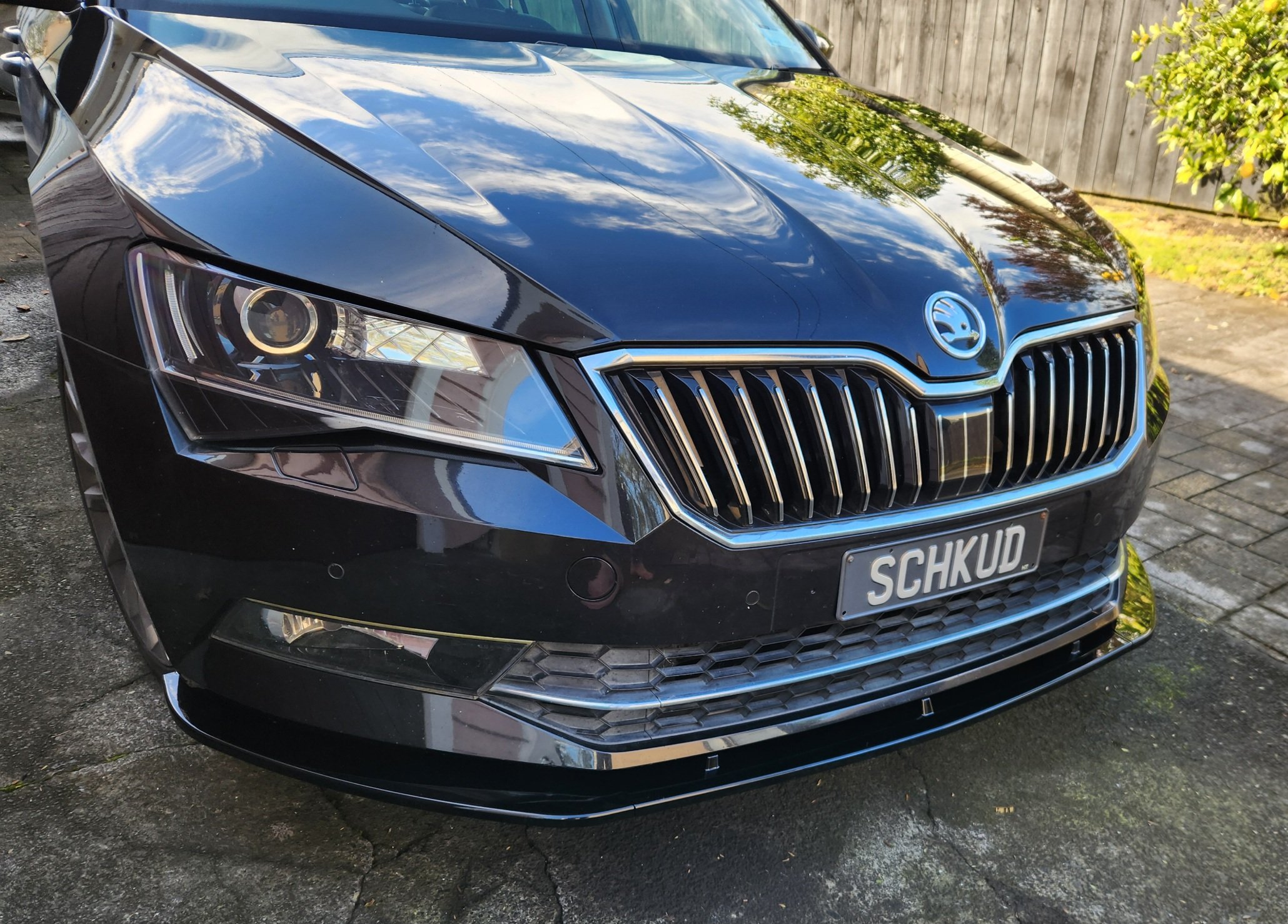

Front splitter installed

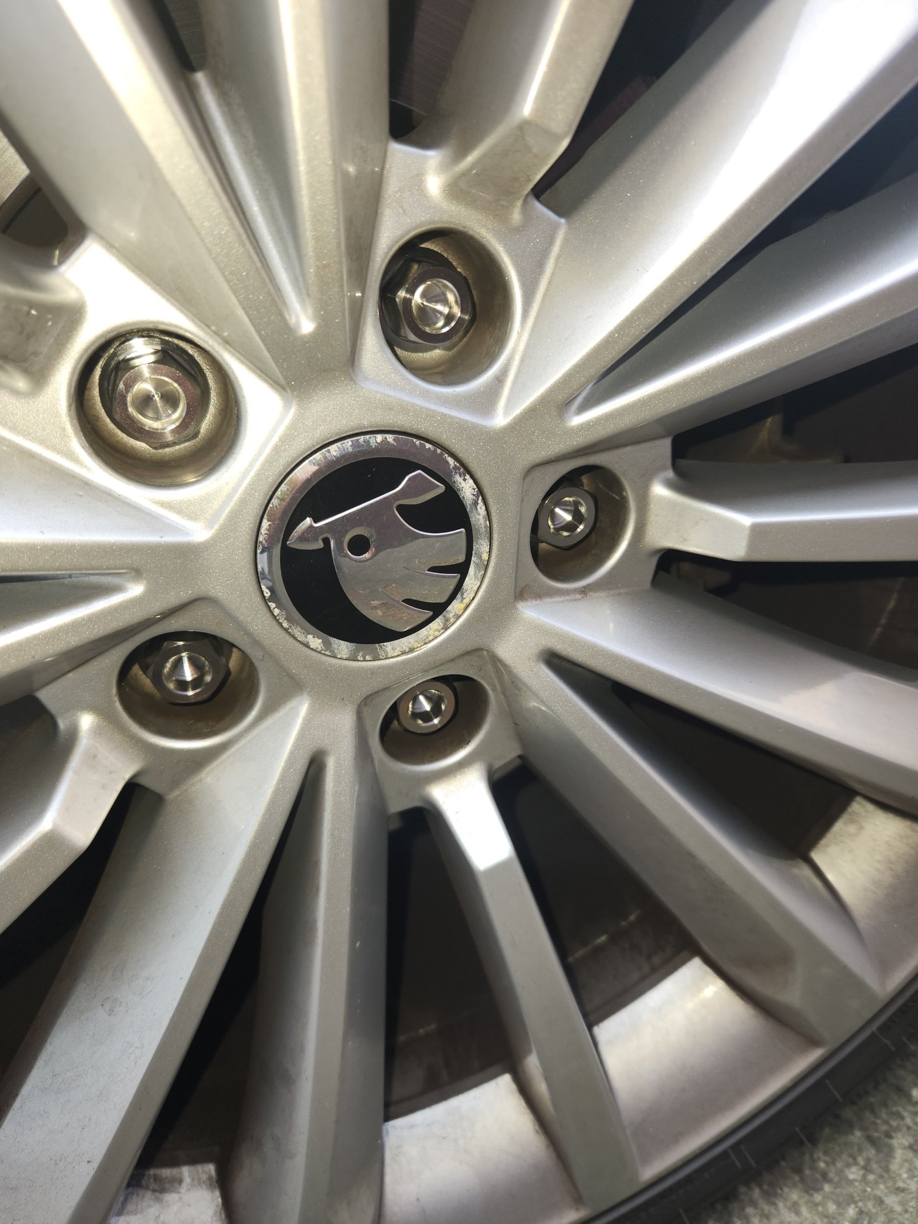

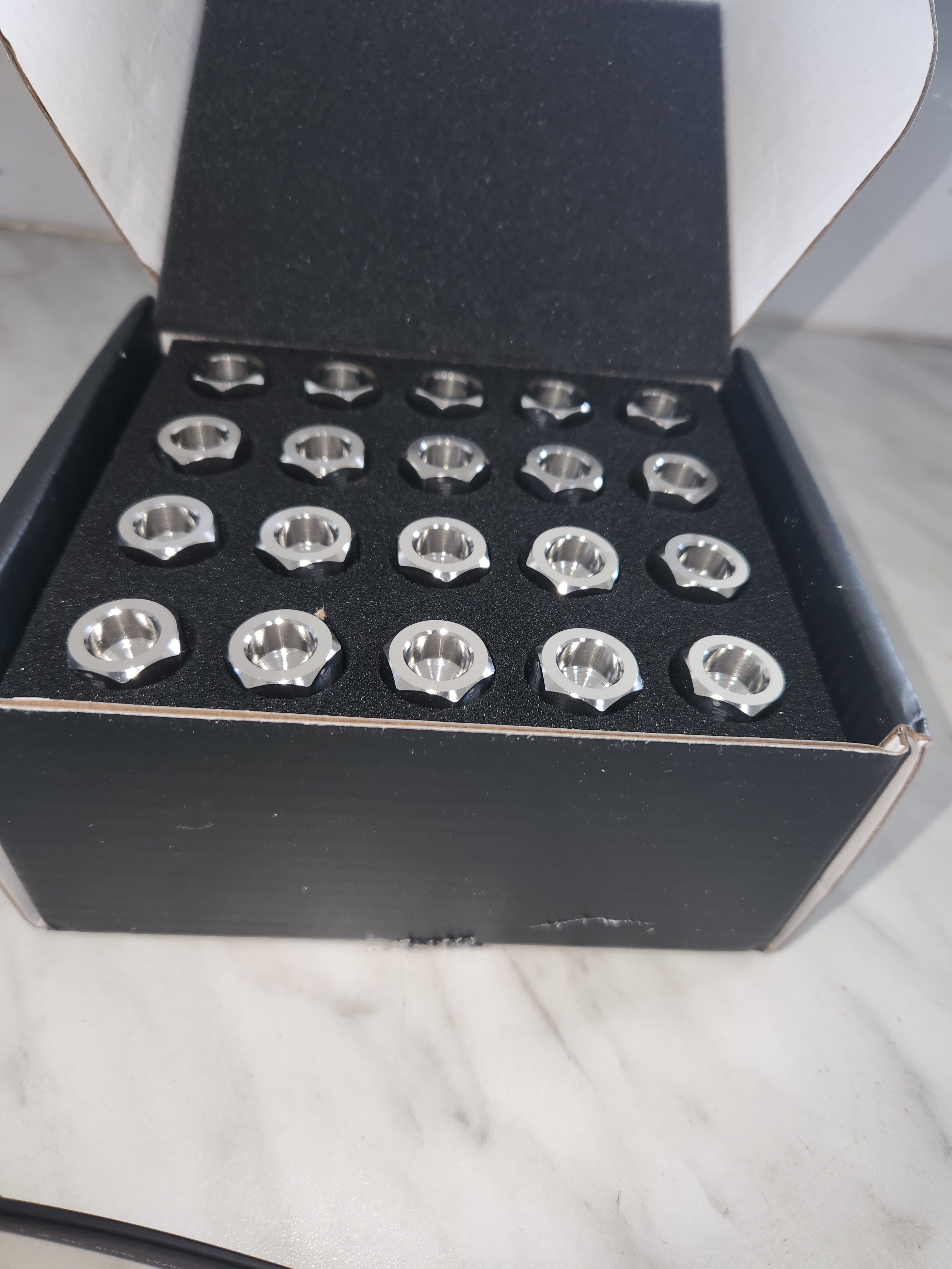

Custom longer titanium wheel bolts and 15/12mm spacers fr/rr

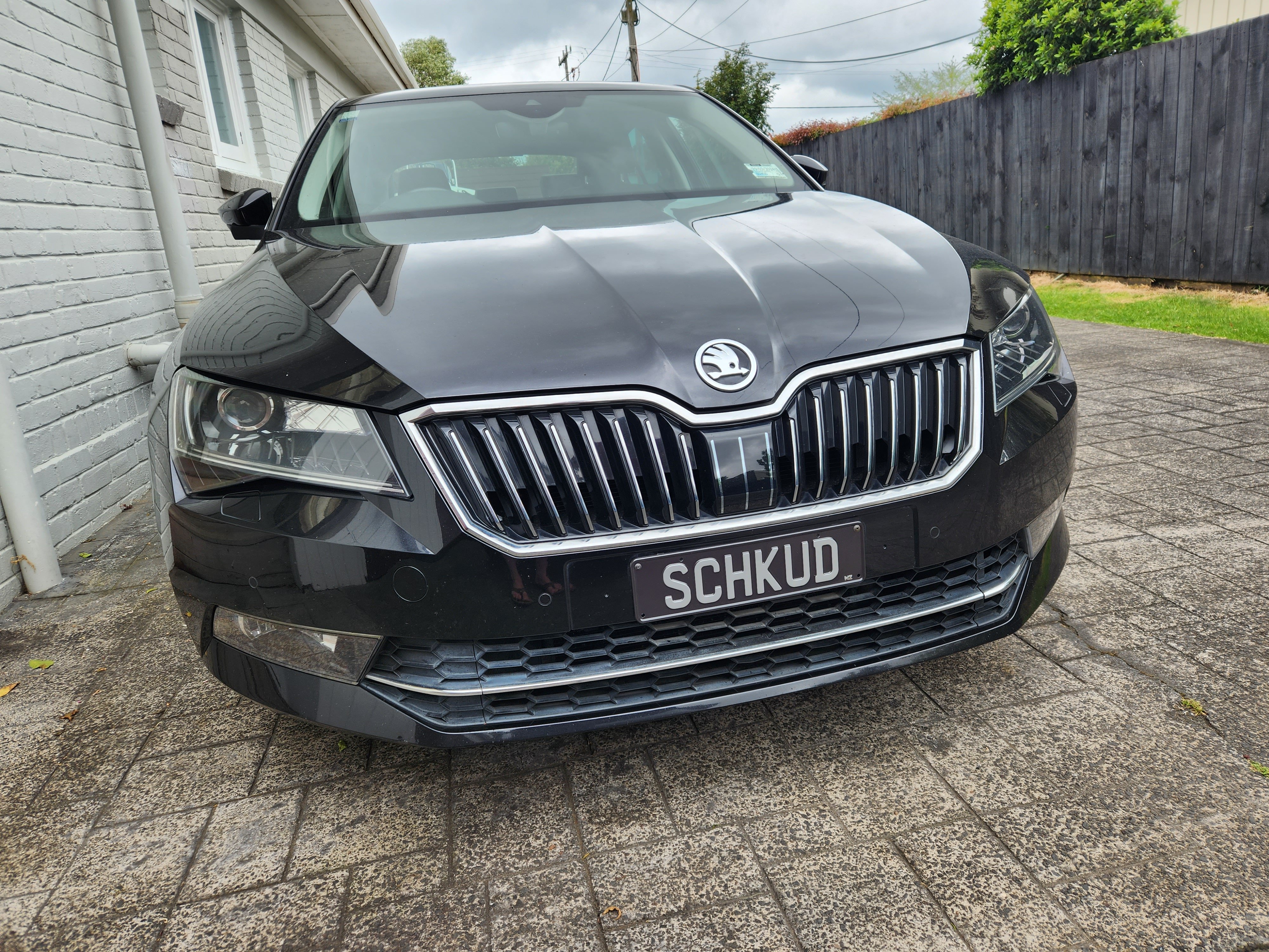

Need that black grille huh
i did a "Hybrid" version on mine - got the black Sportline grille frame, and kept the original inners with the chrome fins.
the chrome fins match nicely with the DRL whiskers in headlights.
i even did the same with my Skoda round badges - made the outer chrome ring black.
did it to the bonnet & boot lid badges.
Edited by JR RS
That's a sweet mix in-between, without going total blackout. Very nice!
I did the same thing
Ti studs installed
Felt such a difference in acceleration
