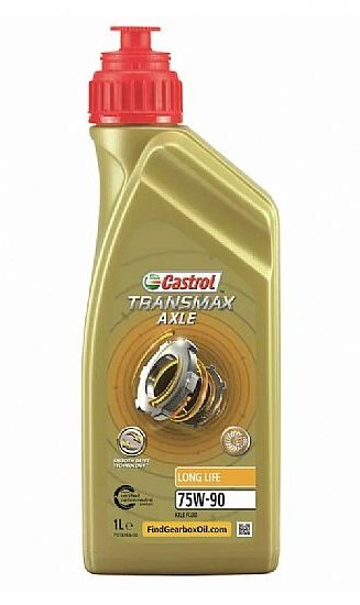

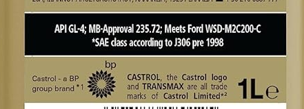

Castrol Transmax 75W-90 Synthetic gear oil, covers the API GL-4 specification.
I didn't has time yesterday, i had to buy new gear oil because the car was already inside the repair shop. No time for extended search, wait for shipping etc. This gear oil is Synthetic, the previous Motul that i had was Semi synthetic.
As i said i had no options, the car was inside the repair shop, gearshift seal and expansion tank was ready to pick them up from another parts shop.
In few hours yesterday afternoon i had to find gear oil GL-4 so there would be no 2nd visit to the repair shop, now was the chance were the car was lifted for the coolant change.
I searched in 2-3 shops in the area via their website and the best option was this Castrol or the previous Motul.
I had to decide and buy in 3 hours, i ordered via phone and left my job to go there, buy and return fast as i could.
First impressions from the new Synthetic gear oil: One click quieter changes that before, very positive feeling, tested in  reverse too.
Although it's too early i am very happy, Skoda says change after 60.000 Km but i will do a change after 30-40.000 Km.

Good news.  Mileage is only a guide there are many variables that could mean earlier changes could be better, low mileage town/city driving being one example.
Most/all? car mechanics and car engineers will tell you your impressions are all placebo.  The oil you put the photo up for, a Castrol long life, would be a a basic quality nothing wrong with it but they and other do better for not much extra cost or even less cost depending on when you buy.  The one you bought if like in that photo is previous labelling so hopefully you might have got it at a lower price.
The gear changes are smoother and the ''click" sound every time i engage is much lower than before. The original gear oil (i don't know what brand) was worst than Motul and that Castrol is better from both of them.
The new is Dark Green but still in GR the majority have that ''olive beige" one.
There is another one, the No Transmax and the Syntrax but they told me this is discontinued.
