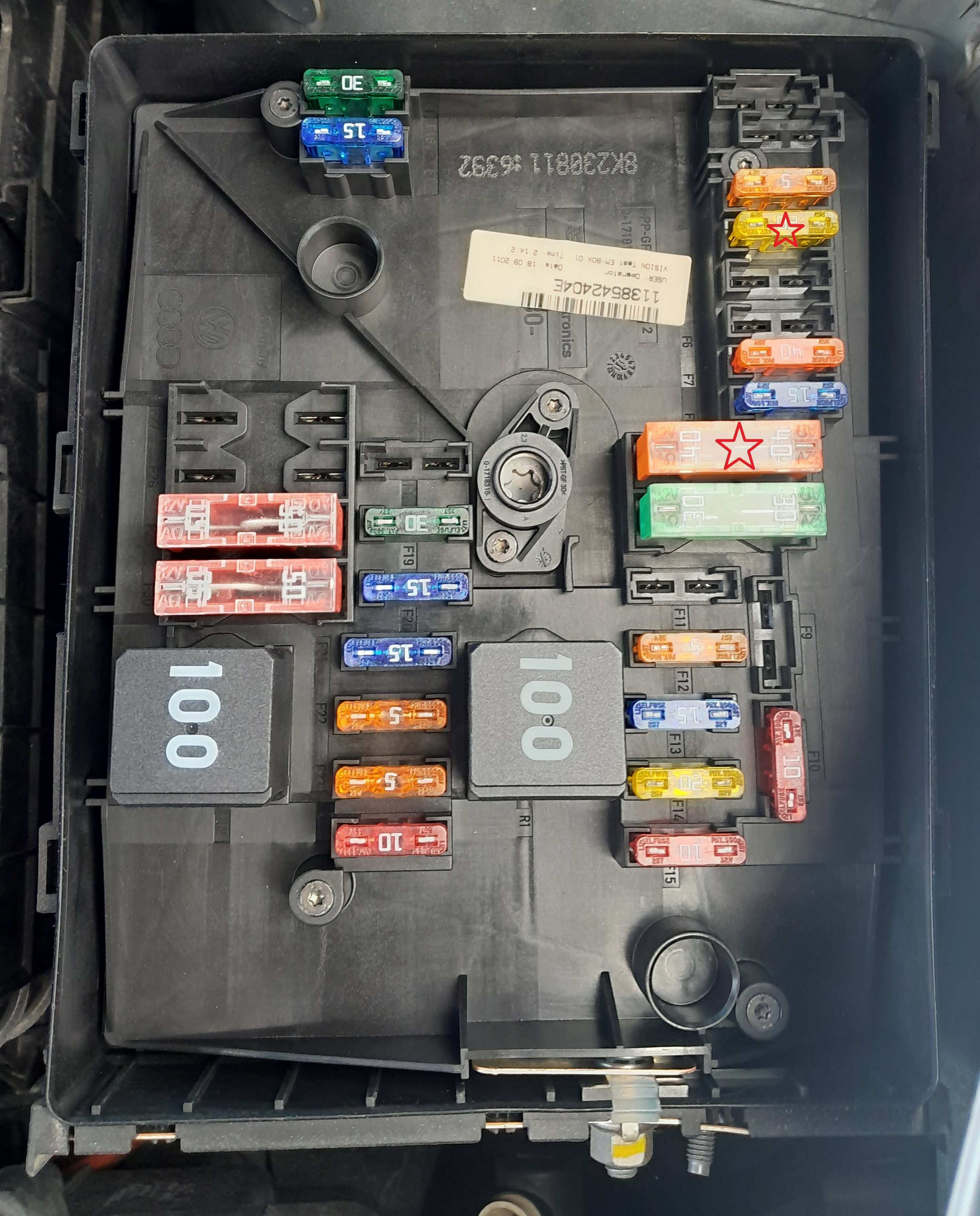

There's probably another blown fuse, one associated with the ABS module.
I can probably tell you which are good candidates a bit later.
  • Sponsor
Check cabin fuse No. 2 (5 Amp), and under bonnet fuses No. 4 (20 Amp) and No. 25 (40 Amp).
Check cabin fuse:
No. 2 (5 Amp)
Check under bonnet fuses:
No. 4  (20 Amp)
No. 25 (40 Amp)
The # 2 cabin fuse was ok.
Are these the right ones under the bonnet ?
If yes, they are also ok.
