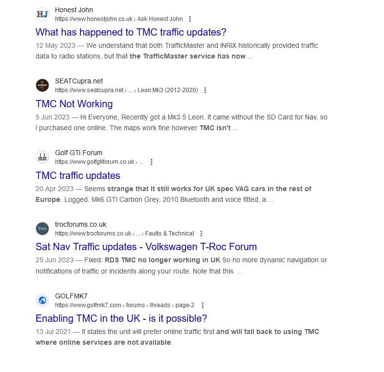

"Just had a dig around google and the only people who appear to  be losing TMC are VAG customers??"
Screenshot2024-06-16at15-45-38Doestmcstillworkinuk-GoogleSearch.thumb.png.037130bda30347aaa06995f98b9f9e10.pngScreenshot2024-06-16at15-45-51Doestmcstillworkinuk-GoogleSearch.thumb.png.b0ba9525642a6c1ba89b4390c182af59.png

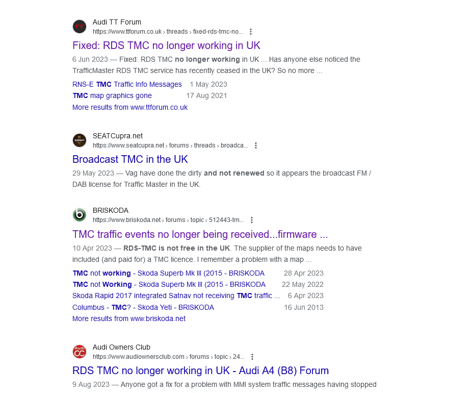

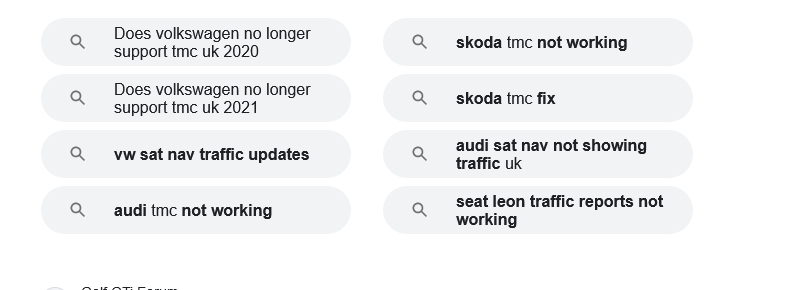

But i think it will be pointless New Volkswagen group with latest maps have lost TMC.
Screenshot2024-06-16at16-12-17doesvolkswagennolongrsupporttmcuk-GoogleSearch.png.f61f845e3911279a9d7bcdf5cd144bb7.png

INRIX isn't new. There were always (afaik) two systems, until Trafficmaster shut theirs down. Which one was used is/was down to the manufacturer. VAG have never used INRIX. TMC has disappeared from VAG cars because they used Trafficmaster, and the service doesn’t exist anymore - it’s got absolutely nothing to do with licensing, cars are set up to use one or the other.
VAG could move over to INRIX - see that link to the TT forum I posted, that suggests a simple coding change can be done (which I suppose means a software update could do the same, maybe). Whether or not new VAG cars now come with that change and use INRIX, I have no idea - but the fact that someone got it working in an old VAG car suggests either the license fee has been paid by VAG and new cars do use it… or there’s absolutely no technical enforcement to check if the receiver of the information is from a manufacturer who has paid up.

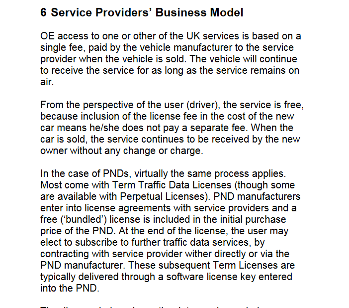

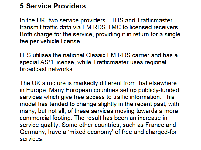

In the UK the system has always required a license
Screenshot2024-06-16at17-50-44TrafficandTravelServices-Traffic_and_Travel_Report_1__pdf.png.af0c46b12d2861fa446b4a4e889fc12d.png
Screenshot2024-06-16at18-05-13TrafficandTravelServices-Traffic_and_Travel_Report_1__pdf.png.d368c5951ec87133e62bc63a1ead2a46.png
Edited by Stonekeeper
I'm not disputing that. But your assertion - or question - about it disappearing from VAG vehicles due to licensing is wrong (or if it was a question, the answer is no). It's got nothing to do with VAG not paying for the licensing anymore, or anything like that. The service simply ceased to exist, therefore any cars that used that service (i.e. all VAG cars to that point) no longer receive any information because it isn't being broadcast - not because they don't have a licence.
And just because a service requires a licence to use it legally doesn't mean it's technically impossible to receive that service without a licence. See also the TV licence and the ability to receive and watch broadcast TV without one.
I have a feeling we are both correct
The licence would be a coding to interpret the data.
The TMC messages appear in the satnav system. So it is possible that the licence for the data would be held by the map provider. The code for access would be held by the system, If the car was set up with a system using only one of the providers it would cease to function when the provider stopped.

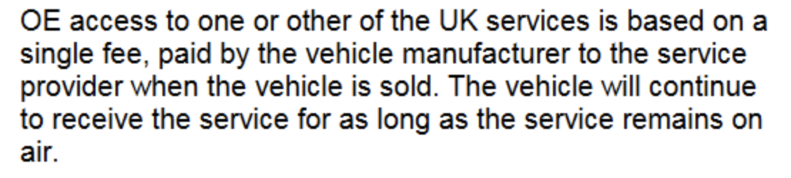

Nope. The licences were paid for by the vehicle manufacturers. The document you posted about licensing even says that explicitly. It even states, in the very next sentence, how long the vehicle will continue to receive the service for...

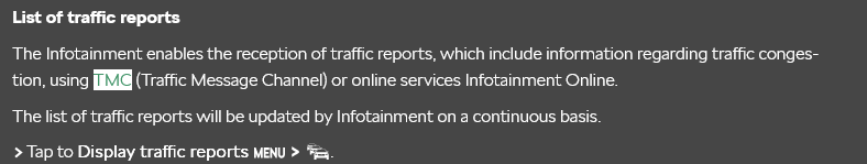

the thing is when I use my phone to connect it comes up. so it gets the data that way doesnt one of these provide this
Infotainment Online sub
Care Connect - remote access sub.
The signal is broadcast along with Classic fm
Thread about how to get it back
You can pair your phone and use your phones data to use waze or googlemaps in compatible vehicles.
The subscription for on-line services is why Vag are saying the service has been discontinued. (It hasn't but it will cost VAG to put it right)
