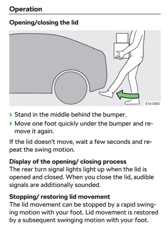

Where do you wave your foot, under the right exhaust?
In the centre, and you don't wave it, just move it under and back out again.
This might help.
Well what a massive fool I am, that works perfectly, 5 times out of 5 and counting.
I’m sure the dealer said under the right exhaust!
Thanks @Neily03
