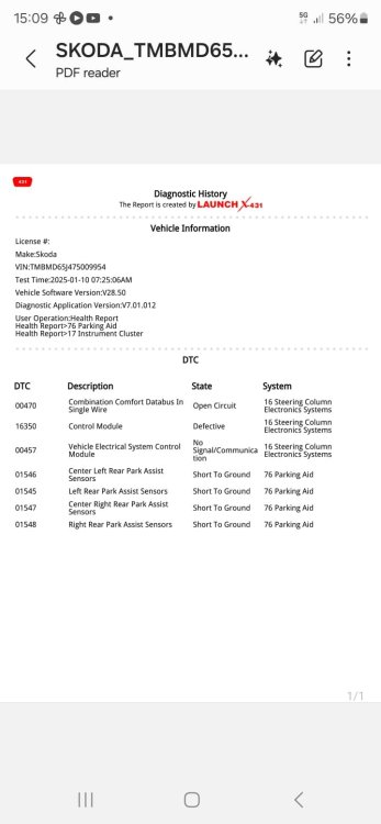

The parking distance sensors do not work, according to the Skoda dealer, they were all defective.
After replacement by the village garage, he got the attached diagnostic.
When switching to reverse, the car's outline briefly appears on the radio screen (most of the time).
The entertainment CAN bus should work, as the instrument panel displays the radio station.  Another weirdness is that the garage could not reset the "service now" indication. He blames it on a software update of his Bosch tools.
I could do some raw CAN debugging, any tips as this would be the first car I look at.
If it is really a wiring fault, where can I find the loom for the sensors?

To Robjon:
Disconnection of the battery did not have any effect 😞
Another detail: the car display only shows once, accompanied by a long beep. After that, it does not show anymore when switching to reverse.  After switching of the contact, this repeats,
