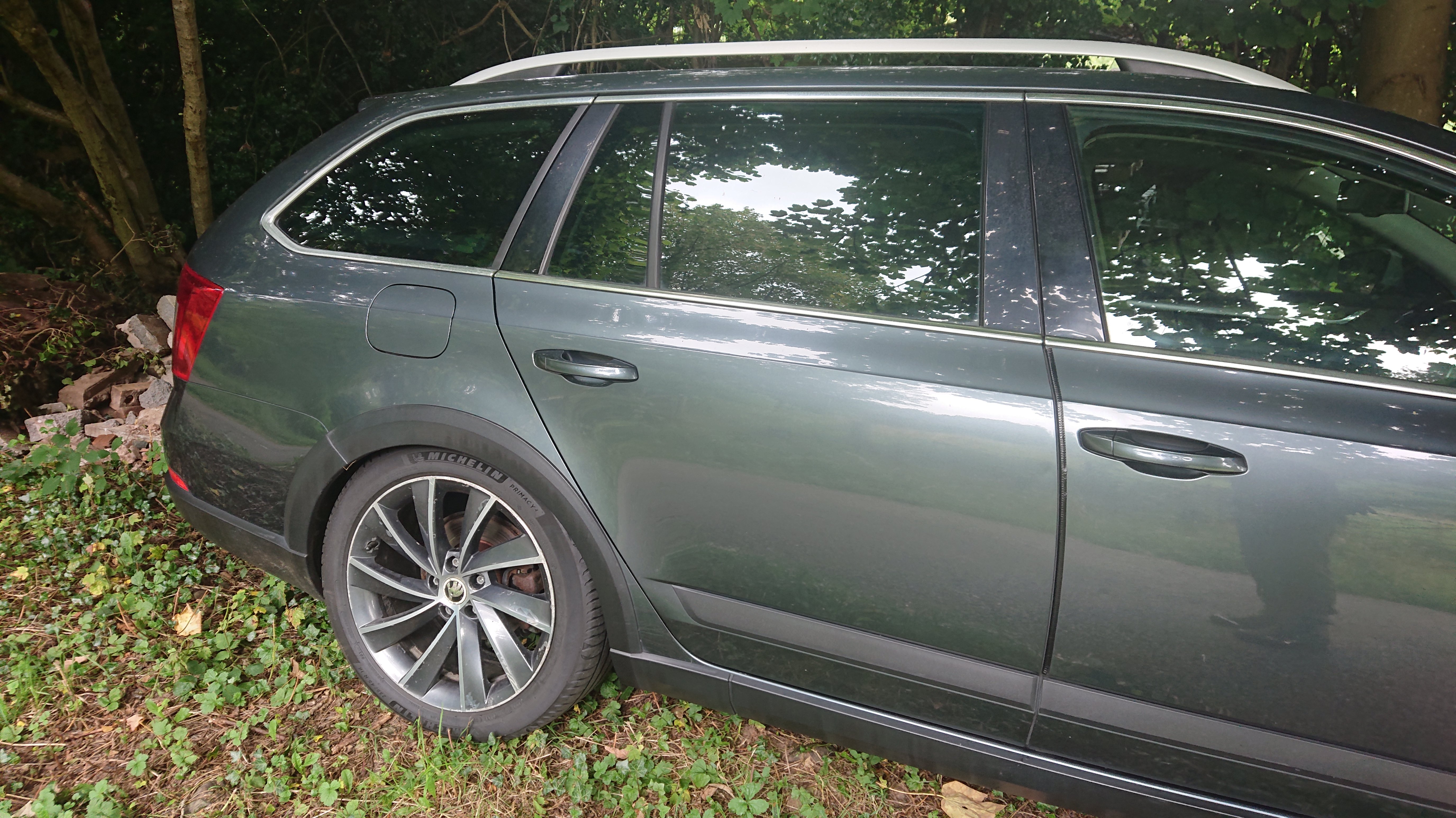

I have already fitted a set of L&K wheels from a Superb with the chunkier tyres they use as standard: 225/40/18 would be my preferred summer option however.

P.S. Photo of the Scout carrying load on uneven ground to show clearance not a problem on the Superb wheels/tyres 👍
225/40R18 tyres have an outside diameter 3.0% smaller than the standard Octavia MK3 Scout tyres, as shown in the chart below. It's probably better to keep closer to the outside diameter of the original 225/50R17 tyres.
