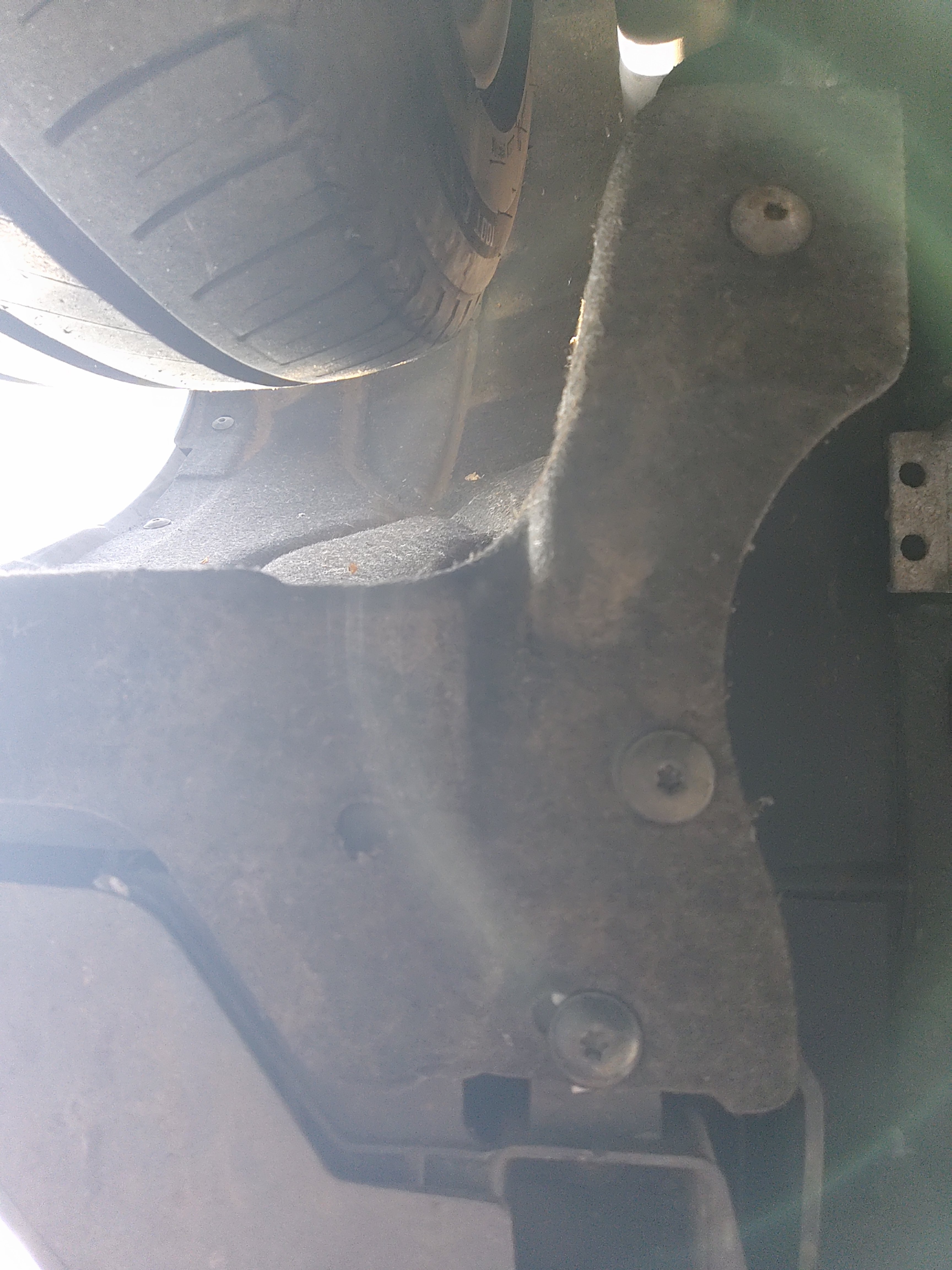

The lower drainage holes aren't visible but if you look at the attached photo , you can remove these three torx screws , pull back the wheel arch dirt guard , and then reach in with your arm. You can feel them rather than see them. Alternatively you can remove the wheel and remove the whole wheel arch guard.

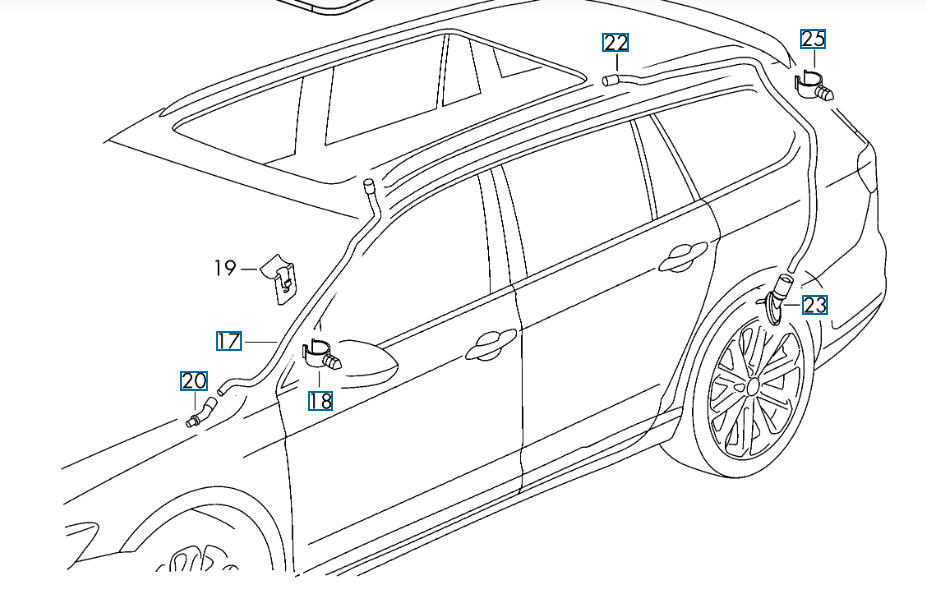

Is anyone able clarify if the front drainage tubes are also behind the wheelarch liners please. I don’t have any leaks as yet, and bought a tool off Amazon for clearing the drain tubes, it’s a long nylon rod with a ring at one end and a tiny bristle brush at the other. I’ve used it on the front drains but didn’t realise there were rear drains too. Being able to see the brush has gone right thru the drain tube would be good.
Edited by logiclee
@logiclee Thanks for the diagram.  The nylon rod tool with a bristle brush at the end goes down the front drains easily and then comes to a stop, which is probably when it hits the wheel arch liner.. I located the approximate 'outlet' position by pouring a small amount of water down the drain tube with a bowl under the car to catch it. Its approximately 8-10 inches in from the edge and in line with the mudflap. The rear drain looks impossible to access with the roof right back. can it be accessed with the roof forward and tilted up at the back or is the only way to clean the rear drains from the behind the wheel arch liner so going up, which would be less effective as it will push any sediment back up ratherthan straight out.
