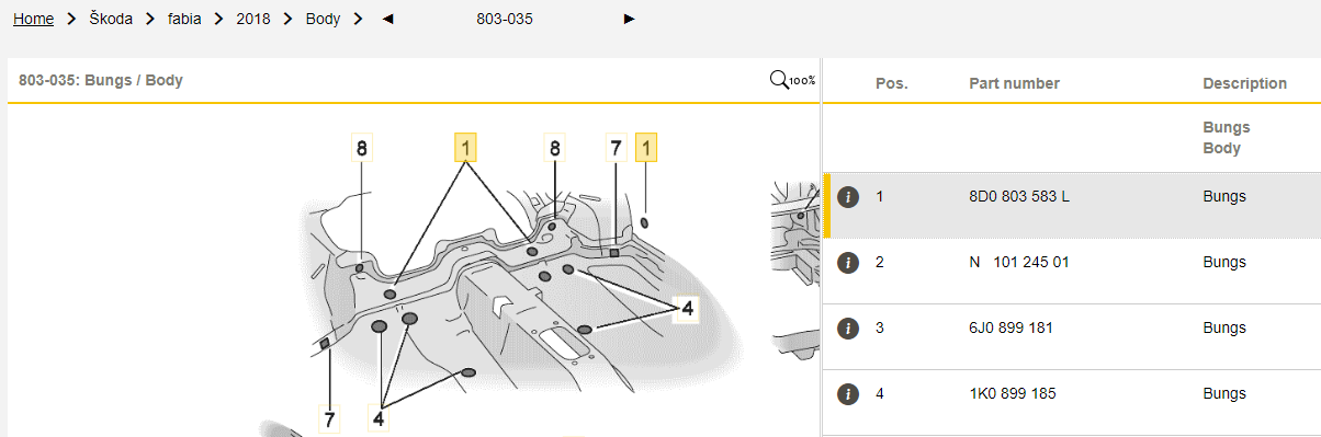

Blanking off one of the holes in the floor stamping as per @pab567 illustration. You may well find a roughly circular wet patch in the carpet.
In the illustration above the bung on the far right appears to be under a door panel?
Is it duplicated on the left hand side?
