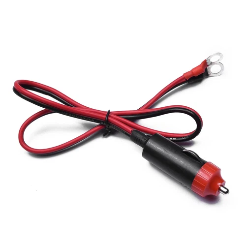

I would just connect a battery charger to the cigarette lighter socket...although this does require patience, but you might find that the car will start after just one or two hours even with a slow 3.5A battery charger, ie. the battery doesn't need to be anywhere near full for the car to be able to start...perhaps just 20% of a full charge.
Something like this would be helpful, but zip tie the red positive lead connector away from the black negative lead connector...or it's easy to short circuit and blow the fuse.

Car 12V cigarette lighter power supply
Car 12V Male Plug Cigarette Lighter Socket Adapter Power Supply Cord Cable 50cm - Picture 5 of 8
https://www.ebay.co.uk/itm/175764521528
