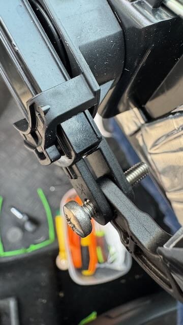

Next- is to remove the handle top half again and check the bolt holding handle to door is tight but it certainly doesn't feel loose. And while it's off I will use actual silicon grease on those little metal clips that hold handle top half onto main handle body, I reckon one of those could possibly be rattling?

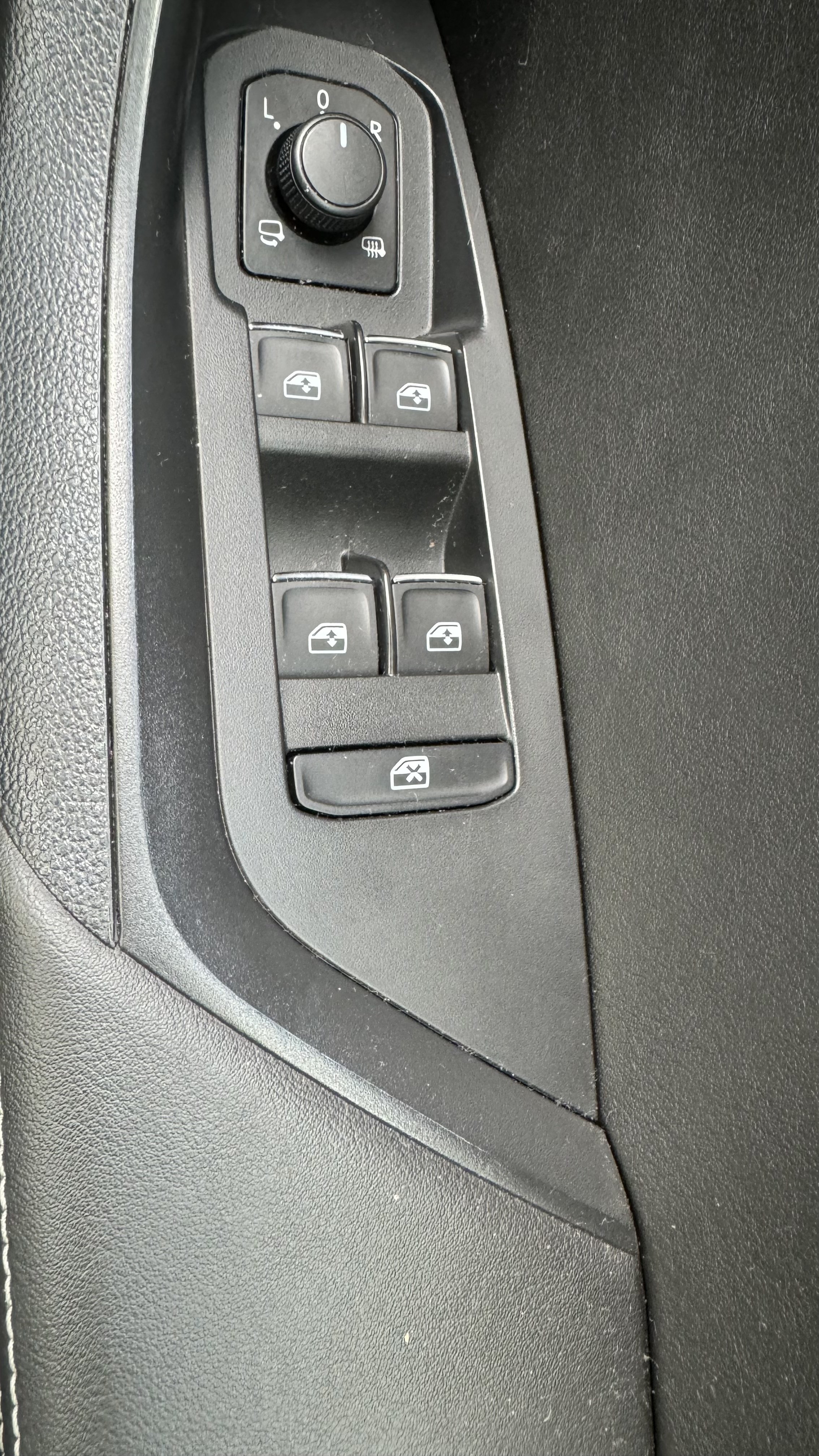

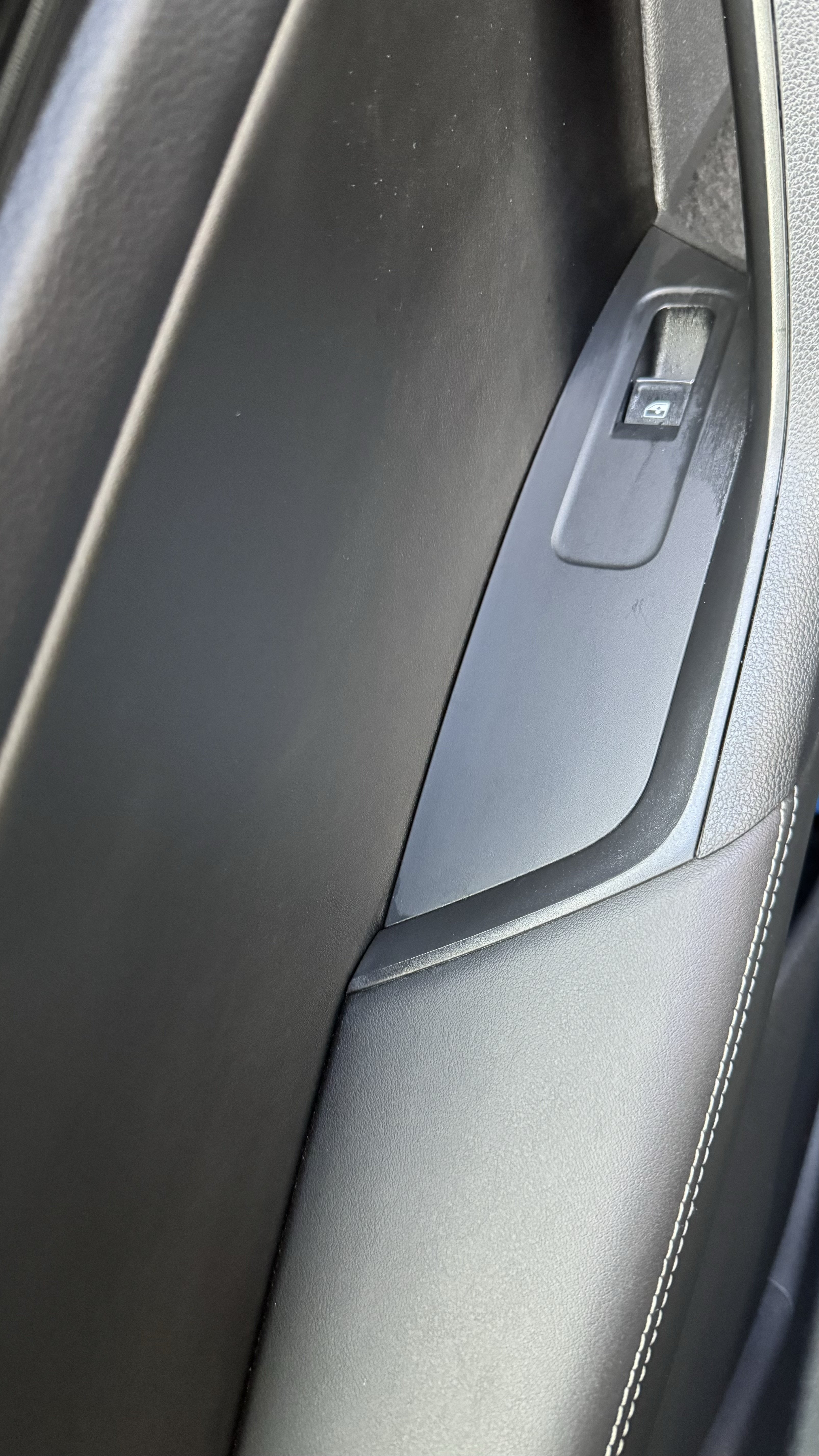

Aha!! Ok so I went back in to wipe things down after the ptfe and waddaya know!!! Looks like the passenger window control panel is blue!! All the others are black!! So possibly a loose or broken clip behind there after previous owner replaced it... Pics attached either a weird optical illusion or there actually is a blueish interior option ?

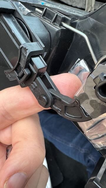

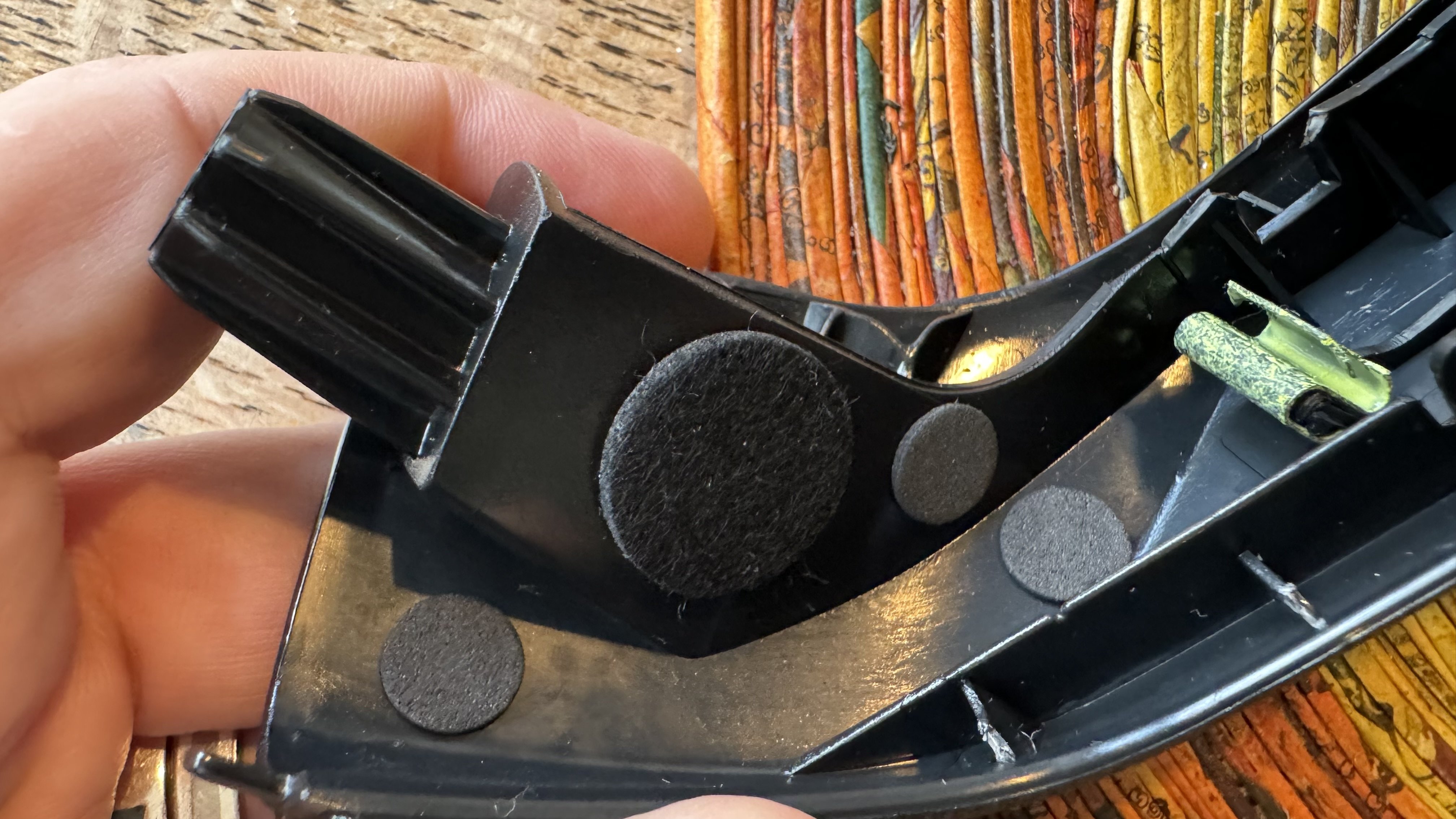

Closer inspection shows that the little yellow metal clips might have room to rattle even when engaged so put tiny foam piece on the tab to hold the clip in more tightly let’s see how that goes
Nope, two clips with foam and no change, will do the others when I get a moment

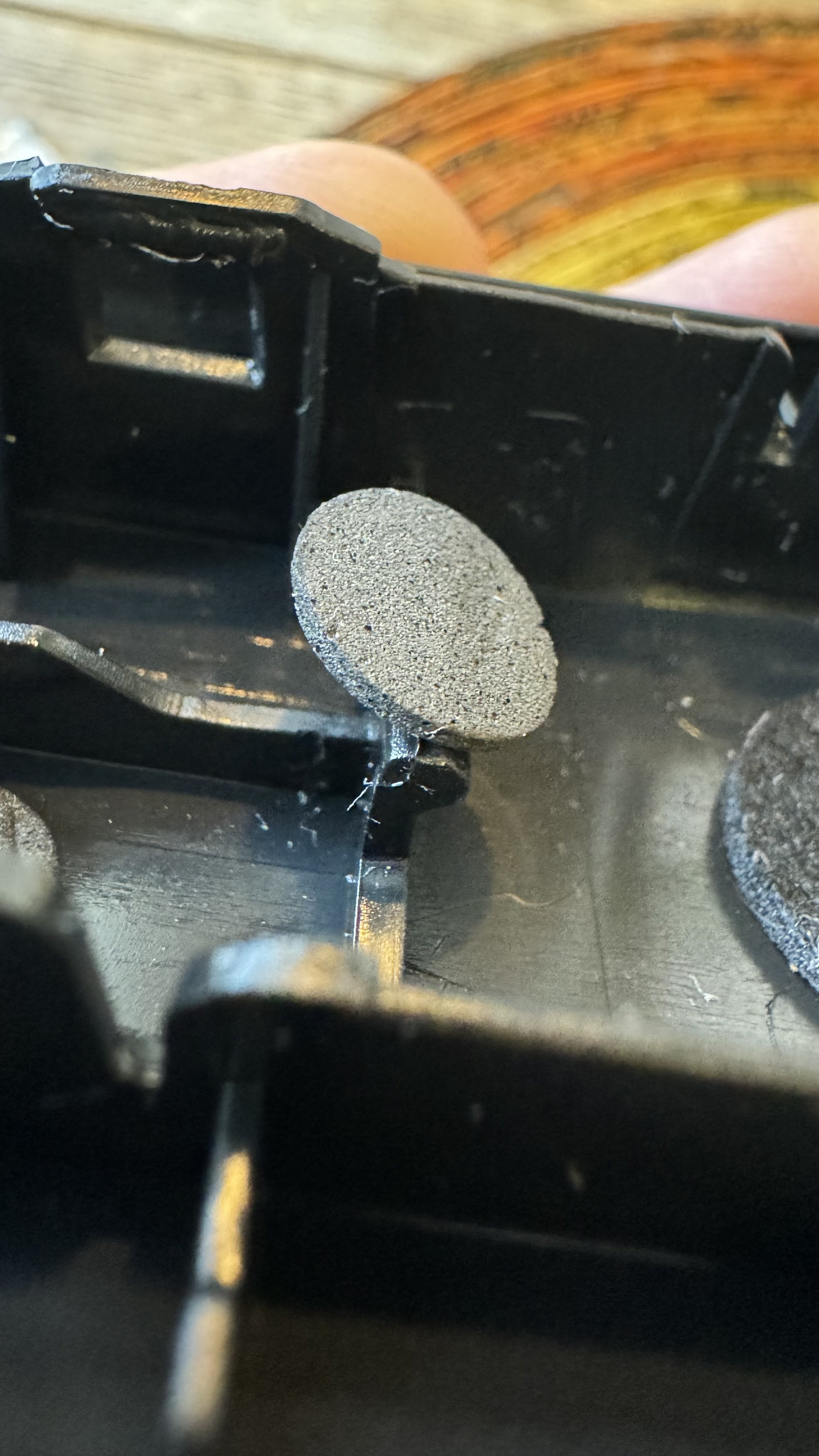

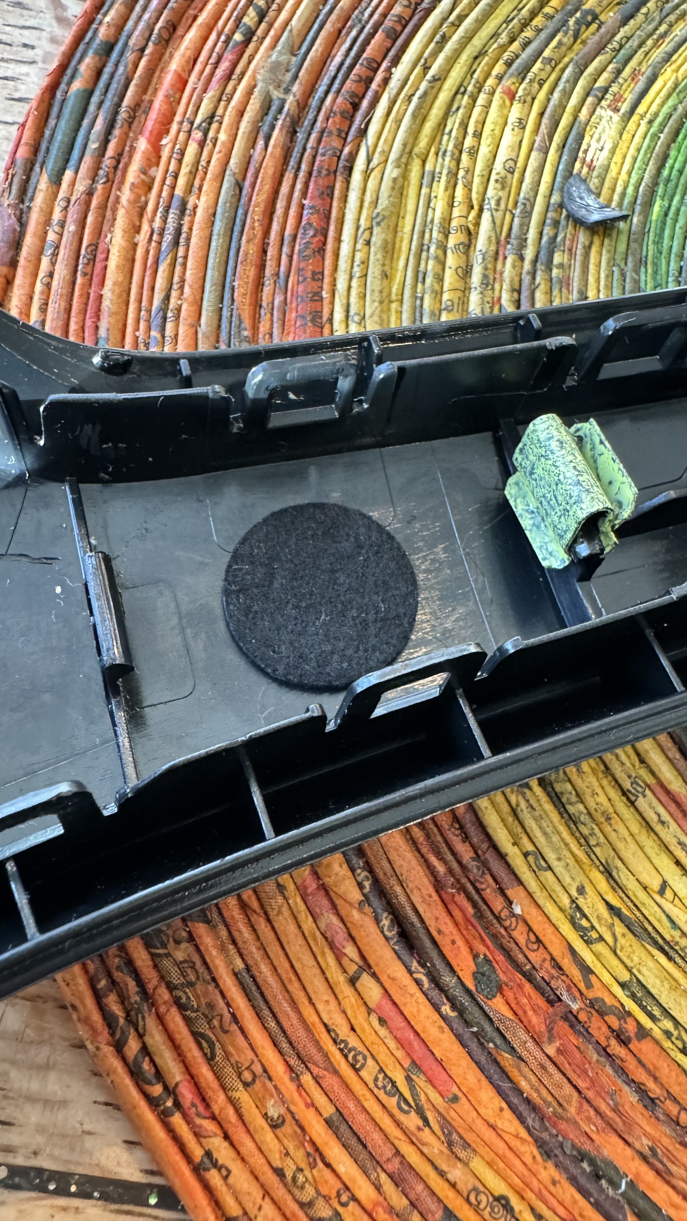

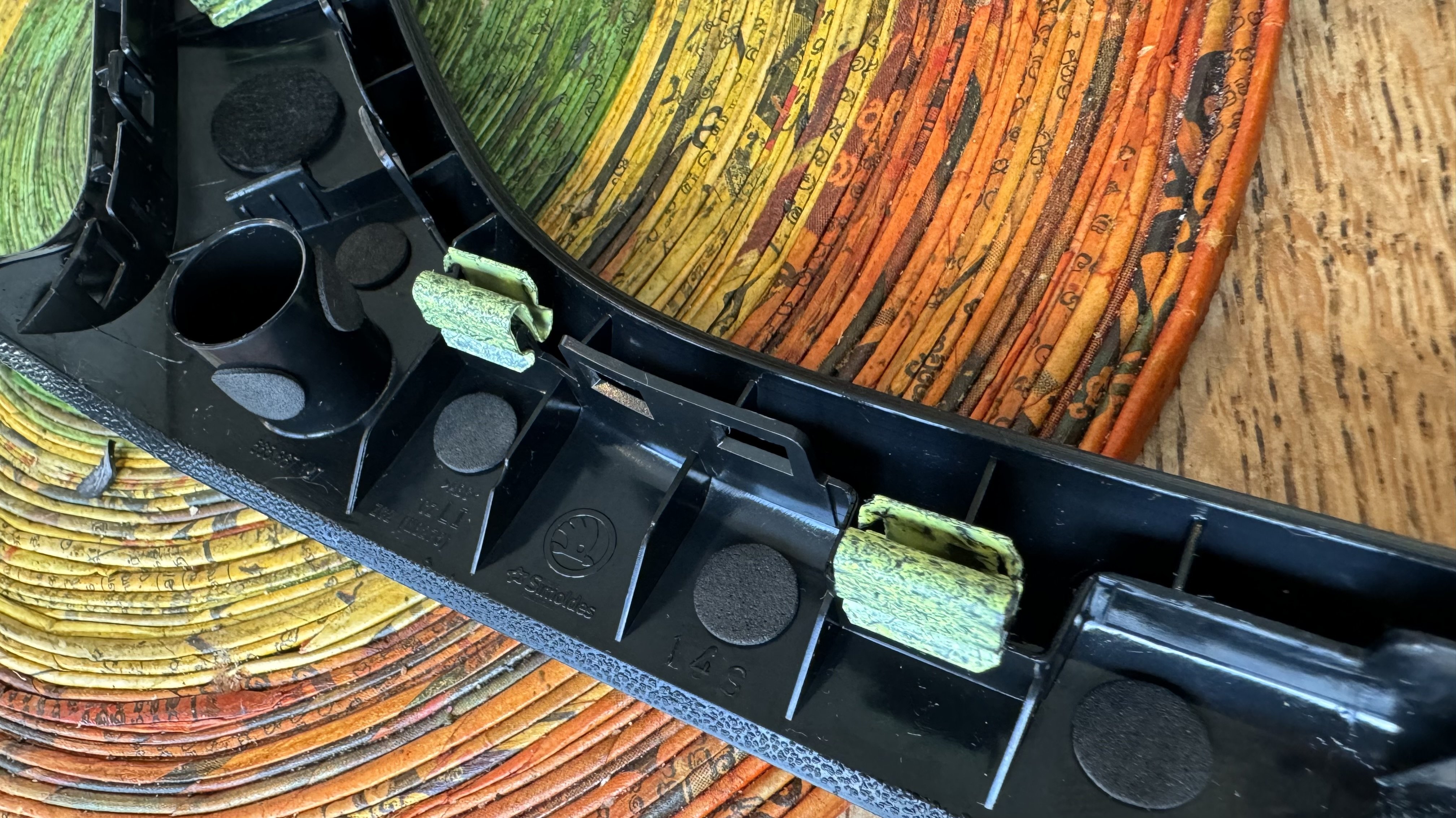

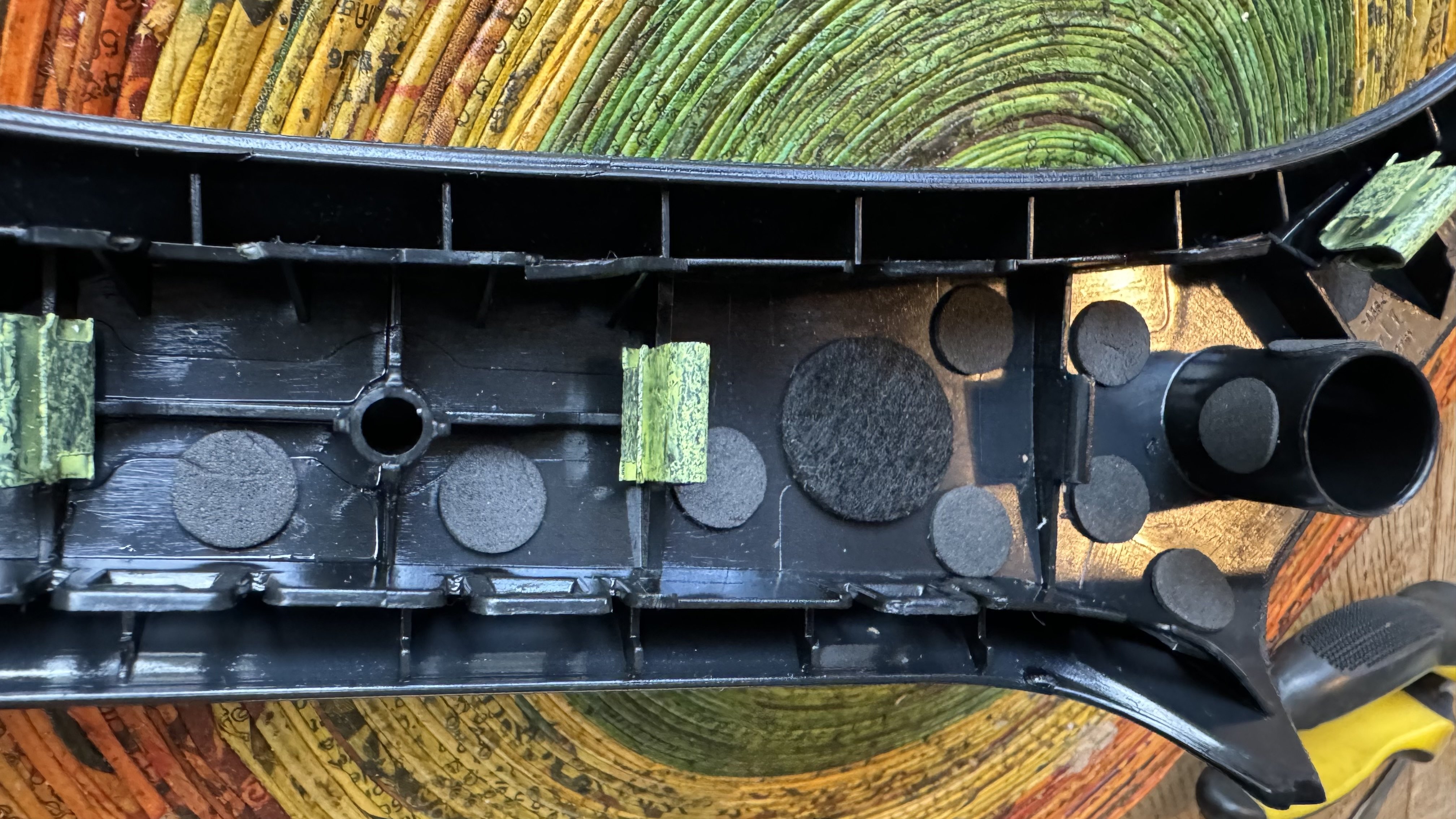

ok! so todays small step was to finish putting small foam pads on the clip mounting tabs, basically a round pad about 1mm thick, self adhesive and 6mm diameter, placed on top of tab then the clip pushed on as normal but with less room to wriggle about.  Then various foam pads stuck to flat areas to help suppress any resonance. will test drive it tomorrow.
foam pad before pushing clip on:

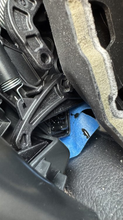

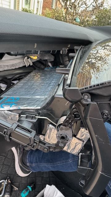

Still going crazy with this, narrowed one down to the resonation of the glovebox layers as @skomaz said , seems to be the knuckle of the hinge making the noise but made louder by the hollow facia. Have some plans to try and will post updates here for posterity.
