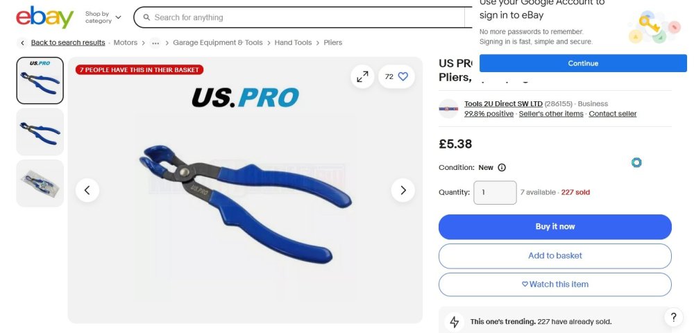

Plugs awkward to get at, buy a spark plug lead remover from ebay, big help as they do stick
