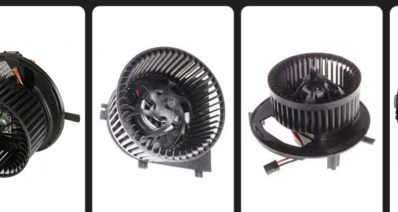

Hello anyone got problem with noisy clima ventilator? When A/C is on ventilator is noisy with high level sounds. Its not the air sound but its more loudly than ventilation. I think its the large ventilator.

You got me curious after seeing the video. So i tried it out and at the first position there is zero sound you can hear. Same with turning it to 1 bar. Only sound i hear is the air moving if you put it higher. So definitely not normal and needs to be checked, That high sound is really odd sounds like a bearing screeching
Yeah i think its the huge ventilator it just started after 400kms 😀
