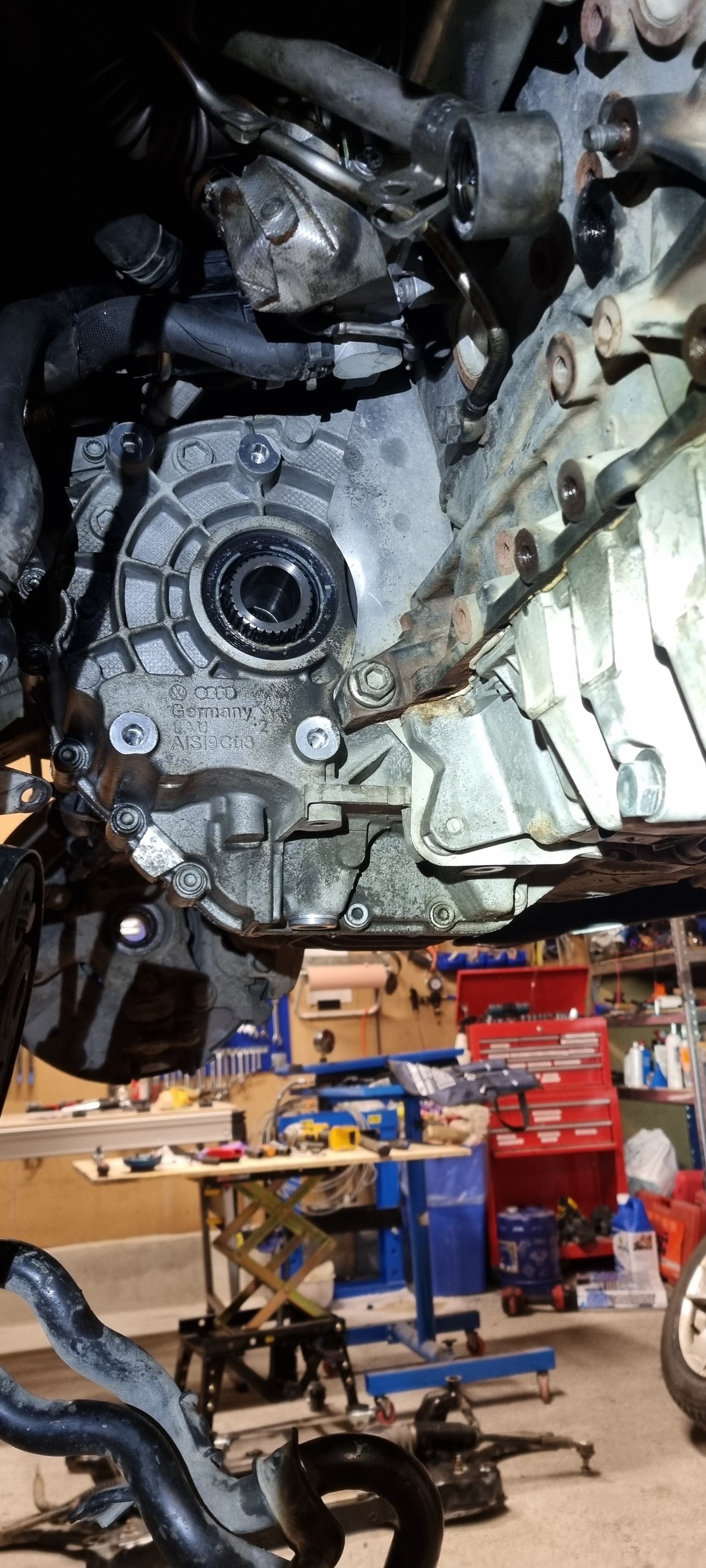

Will try to take out bevelbox in-situ. Borrowed a long round head hex pipe 1/2 to reach the inner 16mm bolt connected to the main dsg gearbox. It is a pita to reach, but time will show. If it doesnt work, there is no other way around than to take down whole dsg....again.

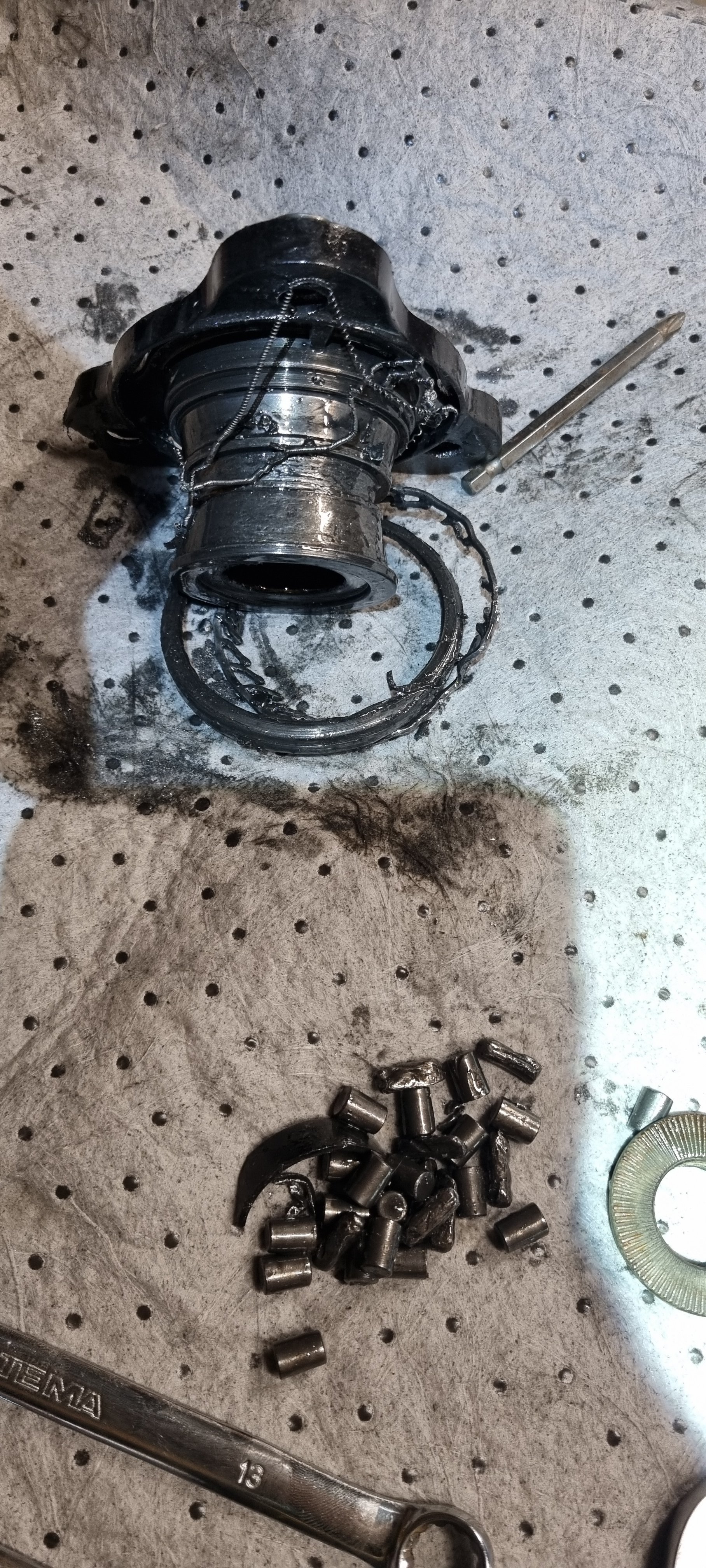

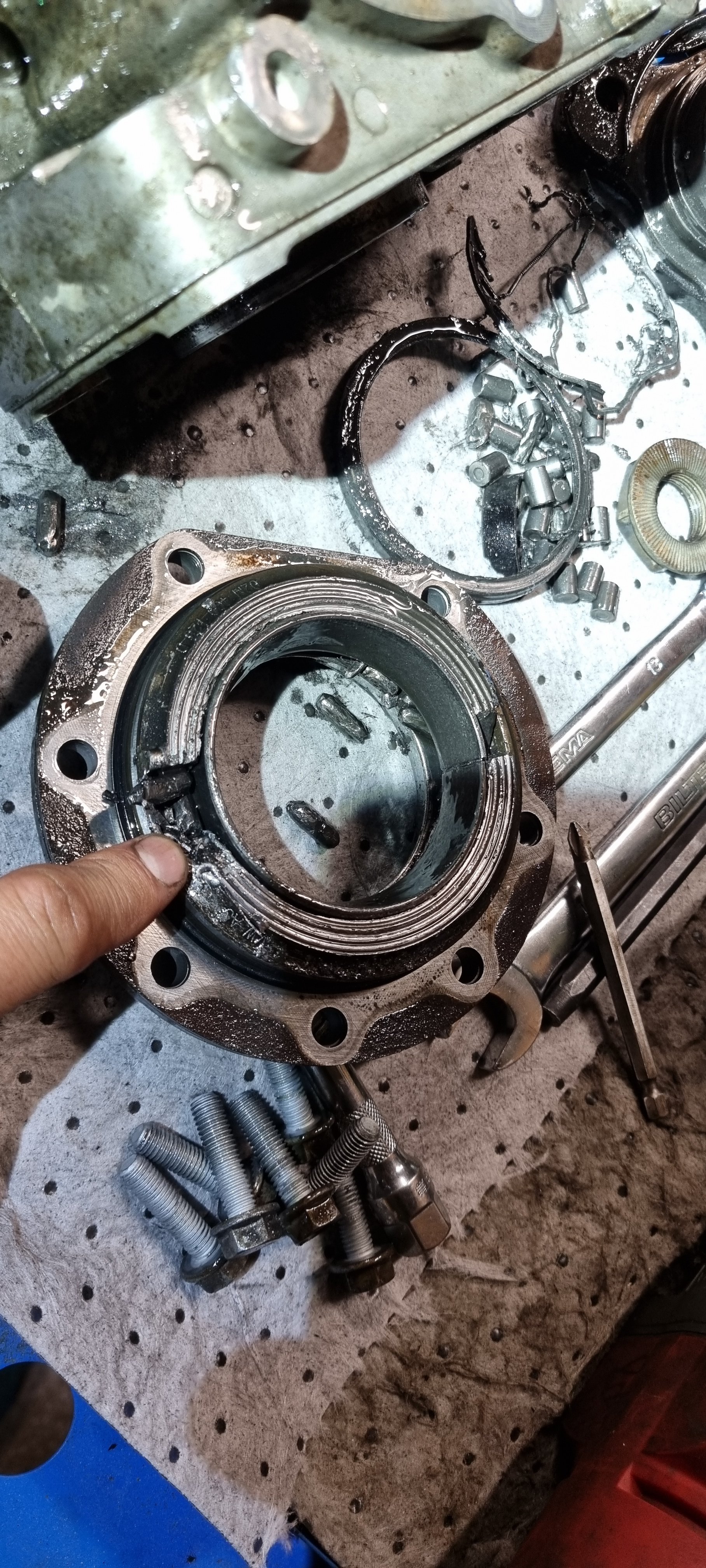

Bevelbox output propshaft needle bearing has totally collapsed, I mean, totally shattered the outer parts towards the proshaft connection. No damage to the left right gearbox axle or the drive axle inner axles.

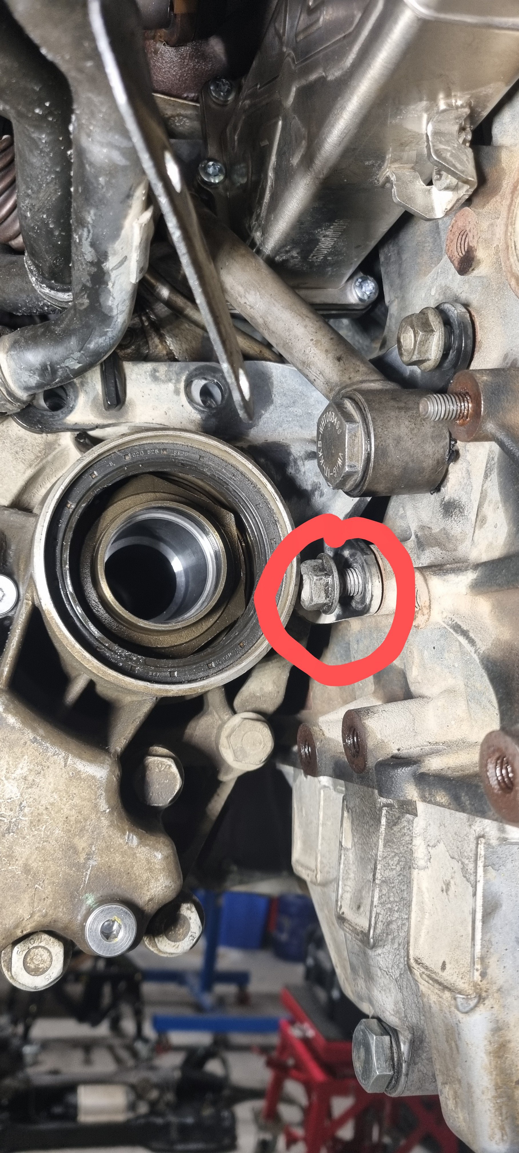

And friends, a tip. If you have a 4x4 tdi with manual trans, it is no problem to replace bevelbox in-situ. Even the last bracket bolt (lower one on engine) is removeable whem the right drive flange is out. But, if you have a DSG, that last bolt makes it impossible to get the same bolt out due to a larger gearbox. The solution without removing the whole gearbox assembly is as follows:

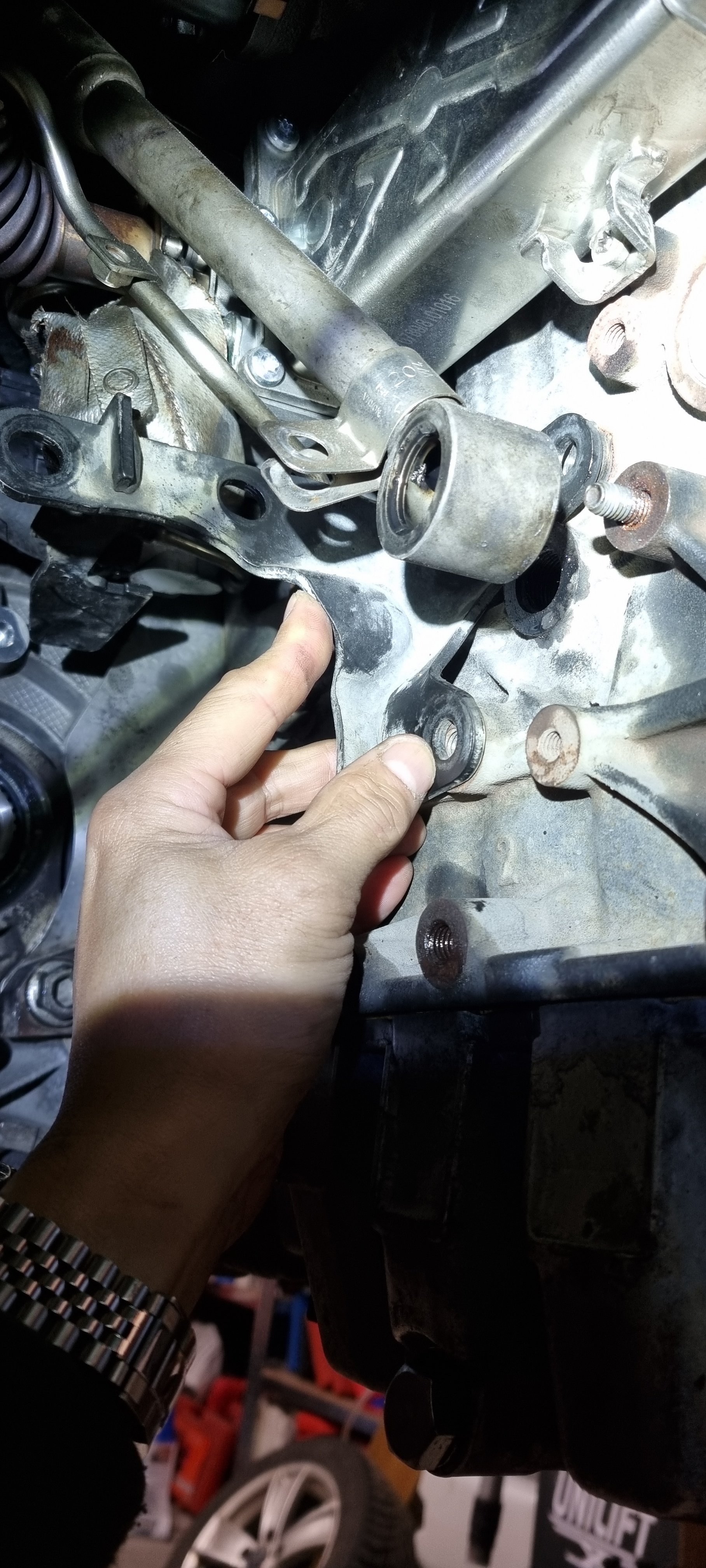

Remove right bevelbox drive axle flange with a loooong hex 6. Take axle out, and remove the 3 bracket bolts. The last bolt needs to be cut off. Replace with a 8.8 M10x1,5 threadsize shorter one, so it can be used with the bevelbox in-situ.
Now, remove the turbo oil pipe bolt with a 27mm wrench and the upper guiding bracket with a T30 bit. Lay pipe aside and now, the bevelbox bracket will come out. This leaves enough room to remove the most inner bolt that fix the bevebox to the dsg transmission housing. Yes it is tight, but use a long 140mm insex/hex 8 round head on that bolt (it is a 16mm bolt, but no way possible to fit a 16mm pipe there). I used a Sonic insex round head no 8 140mm. Then remove last 3 bolts and voila, the bevelbox is loose without removing the dsg. Oh, forgot to mention that you need to remove dpf and subframe first, but that is almost a routine when doing any job concerning dsg, trans and egr cooler on a tdi.
Attached are the pics of my shattered bevelbox.

  4. Buy a Dremel like tool with metal cutter blades. Cut off the above mentioned famous bolt. Replace bolt with a shorter one, M10x1,5 threads. It is impossible to remove that on 2.0tdi with DSG DQ250 if not cut OR if you prefer to take down the whole DSG, be my guest, because that is what VW manual says. Cut it and replace, then remove bevelbox in-situ. Saves at least a couple of hours.
