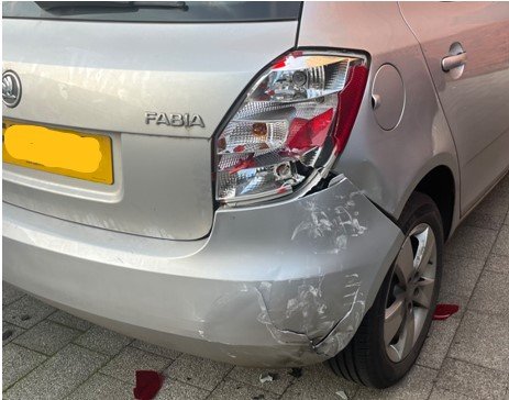

Hi - I am after some advice please - my lovely little skoda fabia was reversed into whilst parked, and damage done to the lights and bumper (see pic). Although the car is 2013, there was nothing wrong with it until it was hit. Does anyone have an idea on how much this would be to fix? Would welcome your opinions, thx

Bumper, light and rear door will all be available, either as new in primer or perhaps used from a breaker.  The expensive bit to replace would be the rear wing where the filler cap resides as it's part of the main body shell.  That said, a good body shop can work wonders with pullers and should be able to straighten the panel.
@Fabiafan6 - What @MikeTheThinker said, with the note that your car will be unroadworthy until the RH rear lighting cluster is replaced.
For a bit more info look HERE for the parts catalogue page for a 2013 Fabia rear bumper.
