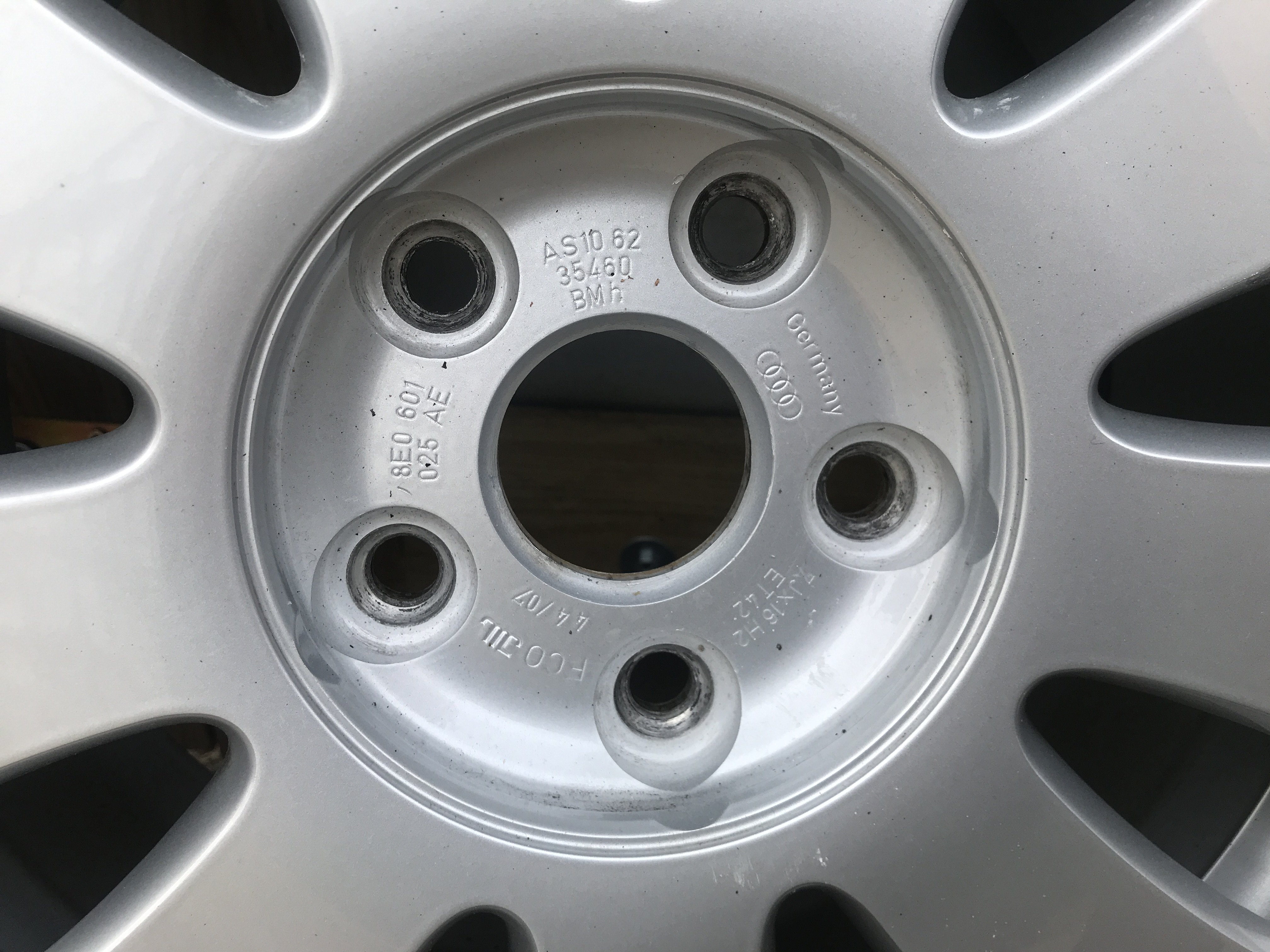

@Ooopnorth Pity you weren’t closer I have 4 16x7 Skoda Spectrum alloys lying in my son’s garage, that I used on my 2 Yeti’s and my son used them on his Karoq.
They are currently fitted with Nokian 215x60 winter tyres, but they are probably too old to use now and would need fresh rubber on.

Will Fabia wheels fit a Karoq?
PCD 100 or 112
ps - I’ve swapped Winter wheels for many years, but I’m now trying All Seasons on both cars this winter
Our Fabia’s winter steels are 15” rims so I think we’d be pushing it! Definitely not Škoda recommended for the Karoq range of wheels.
18 hours ago, BoxerBoy said:
There are too many words above, so …….
PCD 100 or 112
As you can see below, Fabia and Karoq wheels aren't interchangeable due to the different BCD.
BCD (Bolt Circle Diameter)
Fabia 5/100
Karoq 5/112

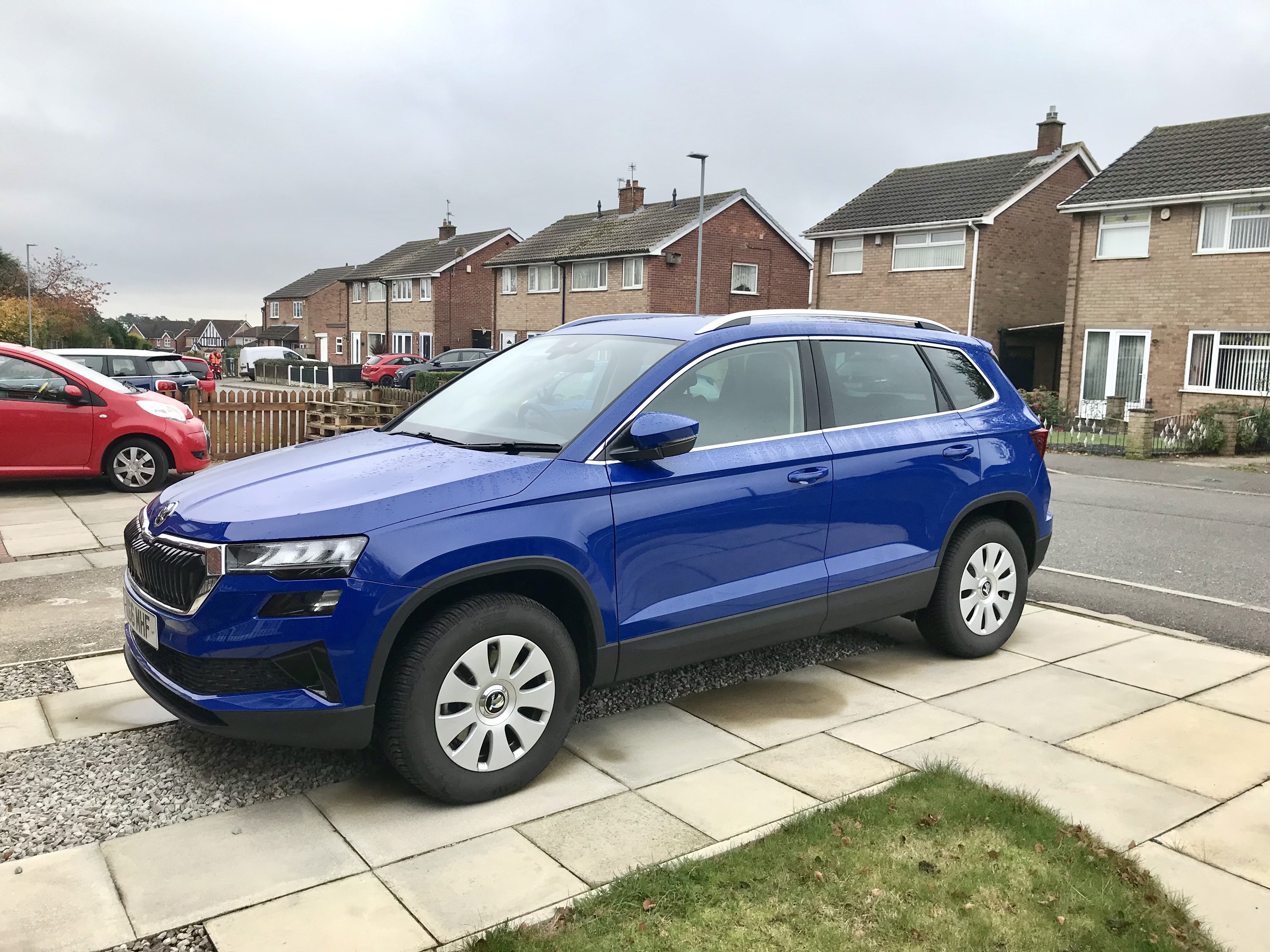

Our SEL Karoq with 215/65 16 Michelin Cross-climates on my trusty old (07) Audi alloys.
What a great choice of colour 👌
If those are Audi A3 alloy rims, the specification will be 6.5Jx16 ET50 which is the same as the standard 16" rims on the Octavia MK2.
The ET50 offset pushes the centre of the wheel/tyre 7mm further into the wheelarch compared to the standard 16" Karoq rim specification of 6Jx16 ET43.

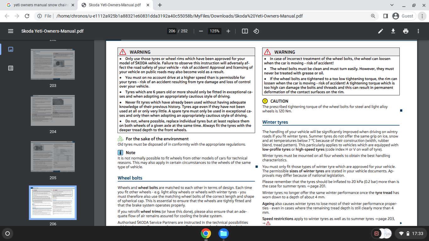

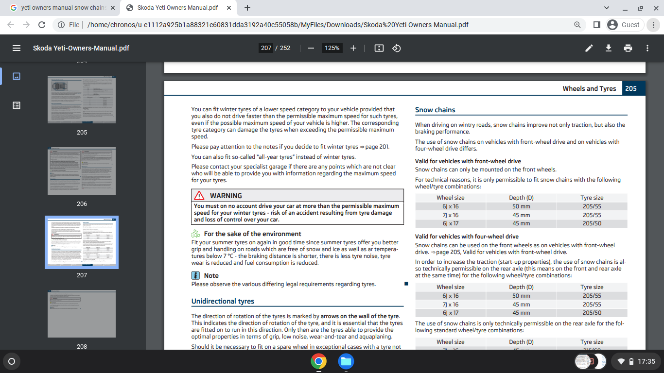

Would that have any implications, such as for using snow chains, etc.?
I seem to recall that on my old Yeti, snow chains could only be used on the rear axe.
Edited by Ooopnorth
I think your memory on that is wrong.
(& there are fWD only Yeti, would they just be getting chains fitted to the rear?)

19 minutes ago, Carlston said:
The specification of those Audi A3 alloys is 6.5Jx16 ET50 which is the same as the standard 16" rims on the Octavia MK2.
Outside diameter of tyre
215/50R18 672.2mm (Karoq front wheel drive tyre size)
225/45R19 685.1mm (Karoq 4x4 tyre size)
215/65R16 685.9mm (2.0% bigger outside diameter compared to 215/50R18) (0.1% bigger outside diameter compared to 225/45R19)
The ET of my Audi alloys is 42 - thus pushing the centre of my wheels 1mm further out of the wheel arch than the Skoda spec - I can live with that.......
There are recommended wheel / tyre sizes for use with Snow Chains, and that is usually the smallest width / circumference that can be fitted.
We only once took the Yeti to the Alps and so had to have snow chains in the car, but didn't have to use them in the end.  However, I'm fairly sure (but I'm not infallible :) ) that our Yeti 4x4 owner's manual said rear fitting only. Unfortunately, the handbook/manual was passed onto the new owners.
I've just checked a few sights to jog my memory and found these:
https://www.yetiownersclub.co.uk/threads/snow-chains.2031/
https://www.kopacek.com/Skoda/Yeti/Yeti-4x4-snow-chains-for-16-and-17-wheels
This vid also shows them fitted only to the rear wheels.
It seems odd, as if you had a 2x4 yeti there'd be no drive to the rear, so they'd be little point!
Edited by Ooopnorth
