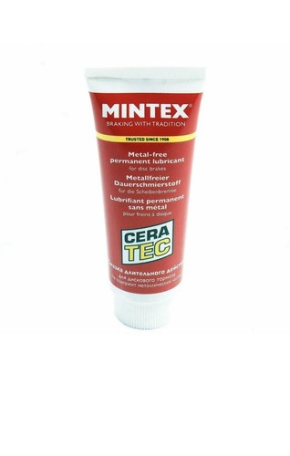

If anyone is interested, I have just cured mine.
Rear discs off, cleaned up & refitted.
Pads cleaned off & assembled up with Mintex Cera Tec & refitted pads.
Still original discs & pads.
The wetter weather seemed to exasperate the problem with the noise.
MINTEX CERATEC ANTI SQUEAL BRAKE PADS LUBRICANT GREASE PASTE 75ML TUBE
Thanks. Will make a note for next time it goes into the garage.
Easy job to do Prezafab.
Pictures available if you need them.👍
