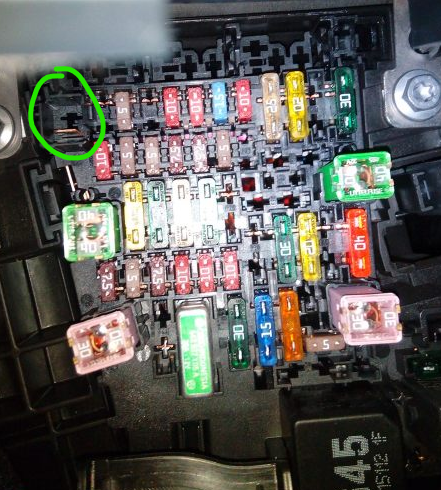

In "cockpit fuse box", place 3 is not populated. But one terminal terminal (positive one) is available.
Can somebody tell me what is the presuppose of that and what AWG is behind? I'm seeking for 12V 20A DC source inside cockpit.
image.jpeg.302f3bc1d0afb04ab8a98777977b9501.jpegimage.png.f348a2570430ae8a172f2a8cb20c9bf0.png

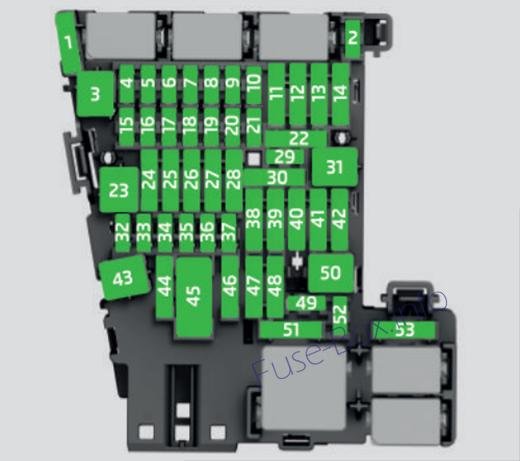

Up to May 2016 it is not used for anything,
From then it is described as follows:
F3 - Fuse 3 on fuse holder C -SC3- 20A - Voltage stabiliser -J532- 30a
30a tells you that it is a permanent 12V supply, and I would imagine that is from busbar/solid link, rather than a wire.

That means that a load of 12V and 20A would be a go? Is that a solid connectio from voltage stabilizer? Or fused over one of the fuses under the hood fuse box?
Looking to connect DC - DC battery charger.

I guess it goes  like this:
Battery - fuse near battery - cabin fusebox - feed to voltage stabiliser at fuse position 3.
The voltage stabiliser fuse, when present, is 20 Amp as shown.

Hopefully you are right. I'm also thinking to pull a line true firewall of AWG 18-16 from engine compartment to DC-DC charger and leisure battery.
