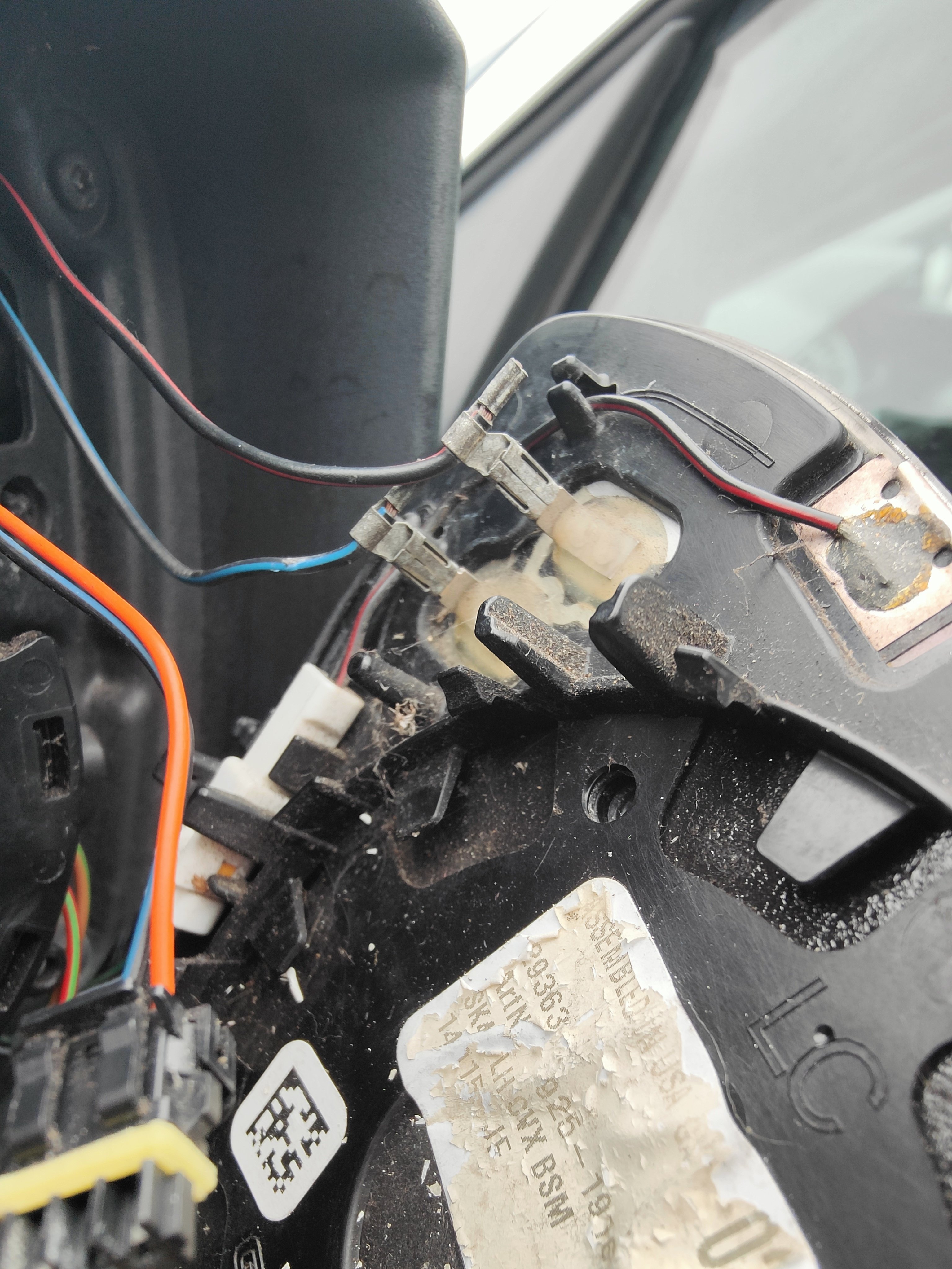

Managed to get the light out. I'm a bit thick when it comes to this. How do I test wether it's the light or the wiring to it? I do have a multimeter not that I really understand it.

It's ok I think I figured that watching a few videos. So I tested the wiring which seems to have voltage and I tested the light which seems to have resistance so I'm happy it's the light that's at fault.
For the wiring I set the multimeter to DC volts put the red cable on the meter to the red wire on the plug and the black to an earth in the engine bay and got just under 12v
For the light I set it to ohms and put a terminal on each terminal of the light and it said 1 which on my meter means there is resistance.
Now what I have cocked up on is what way round the 2 wires go. Both fit on both terminals!!! Can't even find out what they are for.
Took the other mirror off. It's black blue on top so had them the wrong way round!!!
Those cables for heated mirror
