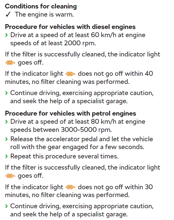

If and when your DPF is blocked then you have this.
Has the car had the Defeat Device Emissions fix & has the Engine Management from that and a airflow device fitted?
