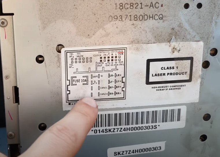

Hello, I own a pre-FL 2006 Skoda Octavia with a Stream HU, without a CD changed in the boot. Since the only options for playing music are either CDs or radio, I searched for an aux/bluetooth option that would look OEM and be cheap, as the car wont be in my possession for much longer and I dont have the money and/or very limited options of procuring a different Skoda HU where I live.
I stumbled upon this video for an aux to bluetooth adapter: https://www.youtube.com/watch?v=YcW0MFloMeM

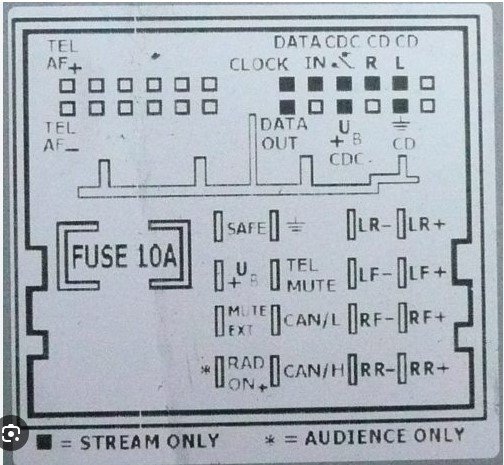

So I bought it, but upon removing the HU I noticed that there even though I have the AUX on/off option in the menu, unlike on the wiring diagram on the HU in the video, mine doesnt have the AUX letters on it. So before I started cutting wires I decided to make sure if it will work by browsing the internet and the various topics here on this forum, but I couldnt find a definitive answer to my question.
So my question is: can I somehow make this work? Do I really not have a way to enable the dongle through AUX or is there a way to make it work by using the CDC inputs, seeing as I dont have an CDC in the car itself but the HU itself has it as an option?
(screenshot taken from the video tutorial)
(found this image from google, but its similar to how my wiring diagram looked, no AUX label on it)

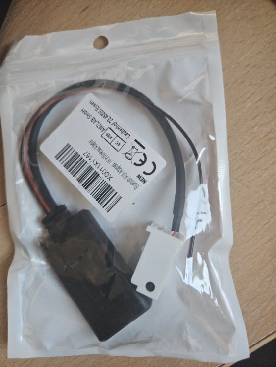

(the adapter)
