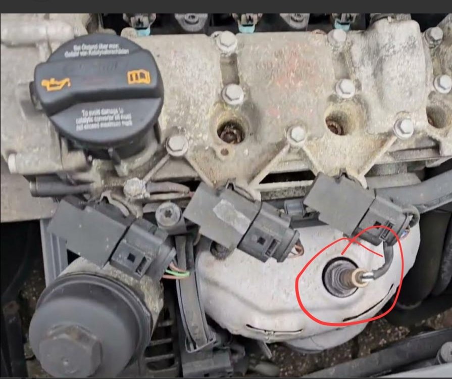

Hello, I just had the chance to remove the oxygen sensor. Upon inspection, there doesn't seem to be any issue with the wires. I've attached the pictures as well. The head of the oxygen sensor was dusty.
  • Sponsor
Well done.
Any sign of damage to the wires coming out of the other connector, the one that you unplugged it from?
@Breezy_Pete No, there didn’t seem to be any visible issue. I just noticed that it felt a bit damp.
In the new photo I shared, two clamps are holding the cable tightly at the marked section. I couldn’t understand why they are there.
Edited by BlueJays

Hello again,
I had removed and cleaned the sensor, but unfortunately, the warning light came on again today. So, I’m considering buying and installing a new oxygen sensor. My question is: can I do this on my own? When I look at the product images, I notice the cables and socket assembly. Do I need to assemble these myself?
Thank you for your guidance.
  • Sponsor
Buy one with the correct connector already on it.
Part number to match is probably stamped on the existing one.
