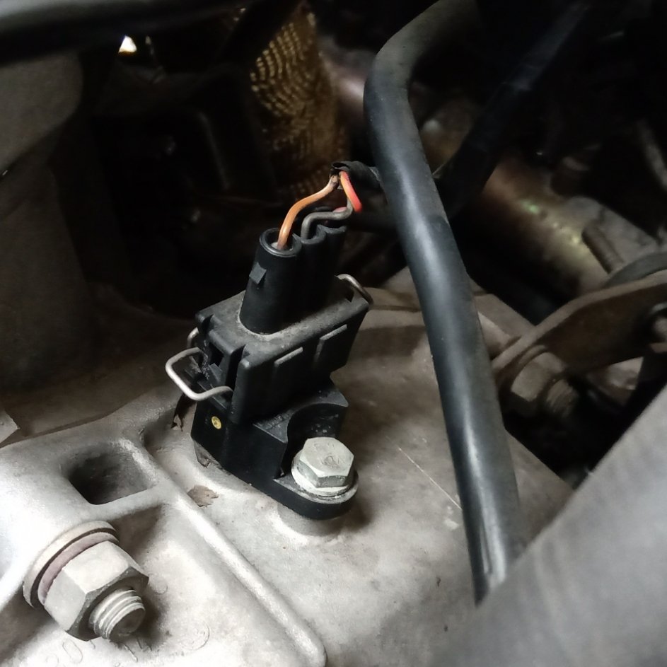

Hello, if you could please send me a photo of the Skoda Felicia MPI 1.3 Crank sensor cable order and connection, I would appreciate it.
Merhaba, Skoda Felicia MPI 1.3 Krank Sensörü kablo siparişi ve bağlantısının fotoğrafını bana gönderebilirseniz çok sevinirim.

The parts code is 047907319A
The harness is here
https://webautocats.com/etka/skoda/fel/101/971200/
and here
https://webautocats.com/etka/skoda/fel/101/971000/
but i doubt if you can find separate parts individually as ''new'' and not used as ''set''.
I will try to take clear photo from my crank sensor and i will describe the colours too.
Brown-Black-Orange.
