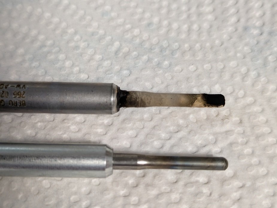

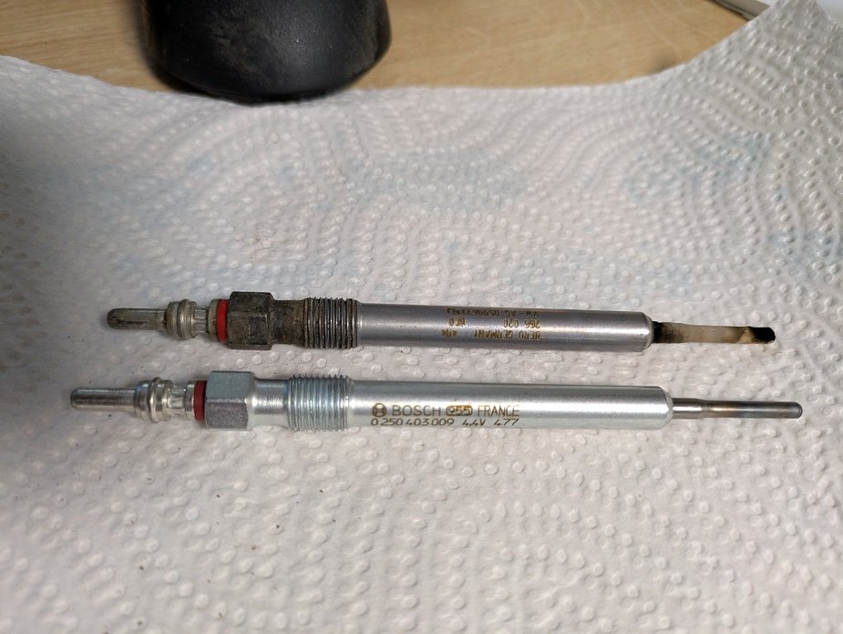

I managed to source a glowplug while I was back in the UK for Xmas for £12 incl postage.
B&B Components – B&B Components if anyone is interested... They have an eBay & Amazon store front also.
I went for the Bosch (GLP194 Duratherm)...
Fitting went smoothly & actually the difficult part was popping off the electrical connector.
Luckily cylinder 4 is the easiest to access & it came off after being a bit more brave & hard tugging with a pair of pliers.
The glowplug itself came out with around 20Nm and a short "crack" on a hot engine. The thread itself & shaft were completely clean which I assume helps.
New one greased & installed with 13Nm torque.
DTCs cleared & MIL light is now gone & no more fault codes... Will keep an eye on it for a few weeks but I am quite pleased with the outcome....
£25 for glowplug & a big tube of ceramic grease as apposed to 60CHF (~£55) just for the part from Skoda.... I'd guess the fitting would be hundreds.
