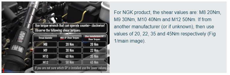

>>There's no such thing as an 'undoing torque' value in my experience. <<
Well, it is quoted by the manufacturer as per link below, and easy enough to conform to if you have a torque wrench that clicks both ways.
https://www.autoresource.co.uk/resources/ngk-the-process-of-glow-plug-replacement/#:~:text=To assist in avoiding glow,Fig 1%2Fmain image).
I would go no further than 35Nm for removal (M10 plug), try first 25Nm and 30Nm on a fully warmed up engine, you do not want a broken off plug.
Also note new NGK glow plugs (No 49) are marked with "10Nm - 15Nm" tightening torque on the box, so the 17Nm Skoda manual quotes might be on the high side. I tightened mine to 15Nm ~3-4 years ago on both engines,  no issues, and one of these spends 1/3rd of its life with oil cooking at 110-115deg...
From experience on 3 cars, I quite like NGK glow plugs, they are lighter than BERU so glow hotter, on older models (V6 BDG TDI) they would take less current but start better, and seem to last at least as long if not longer as factory fit.
If the glow plug doesn't unscrew at the max recommended torque, what are you supposed to do?
