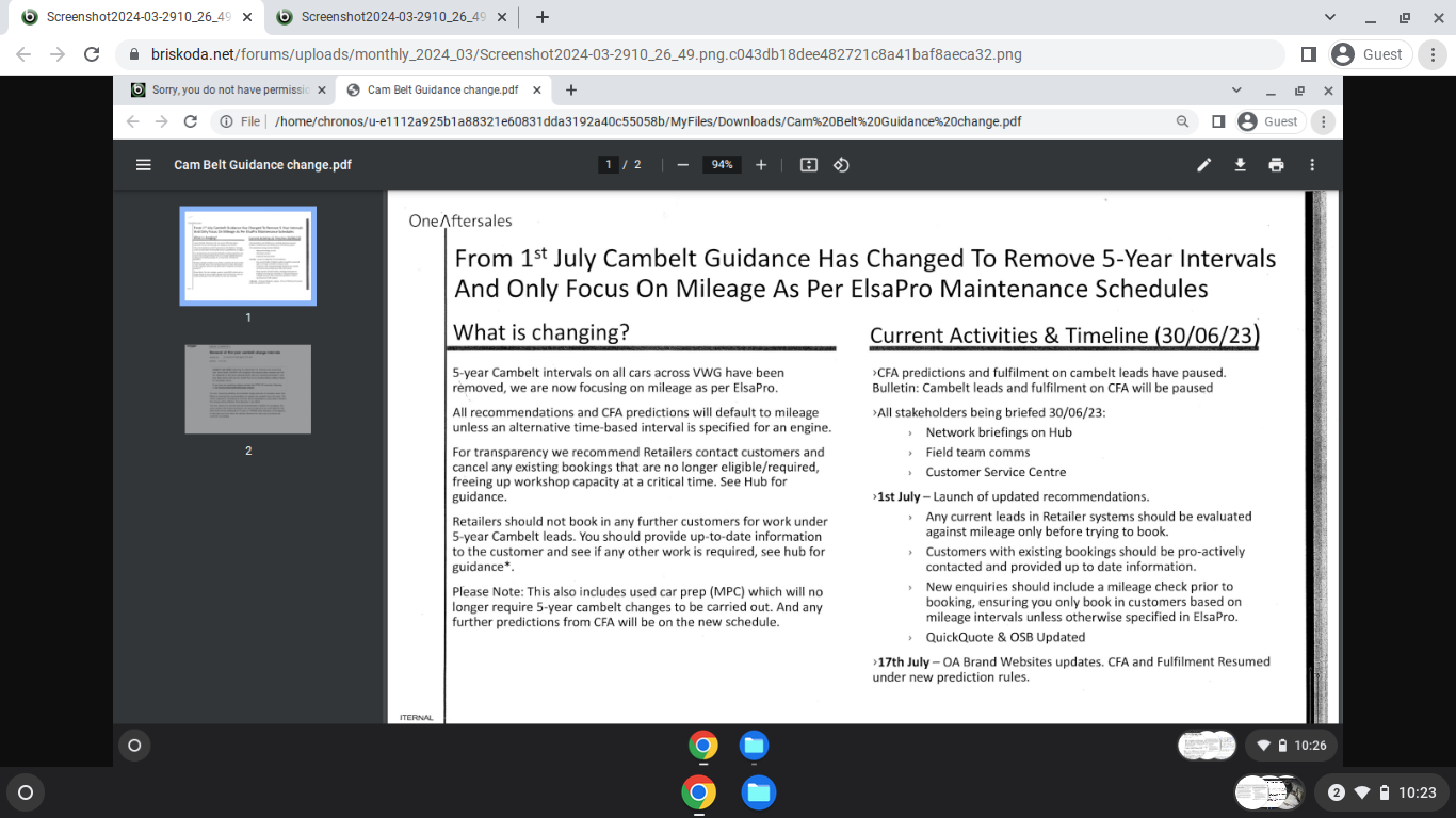

@gm73 You did not have it done on a 1.6 TDI did you.  You have a 1.5 TSI ACT.
But what ever, sooner maybe better than later.
This might not include 1.6 TDI,s.

For the past 22 years, I have always stuck to Skoda Auto belt servicing intervals, ie distance based belt change, no 5yr time limit (that was Skoda UK "invention"). Skoda Auto might have had 10 years limit on I think 1 car (don't remember which one it was, sorry). Took a lot of flak for this on this very forum for publicising the fact that SUK invented their own service schedule contradicting Skoda Auto, but it seems the 5yr nonsense is finally going away.
