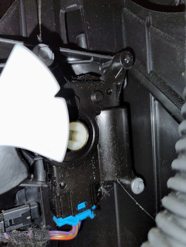

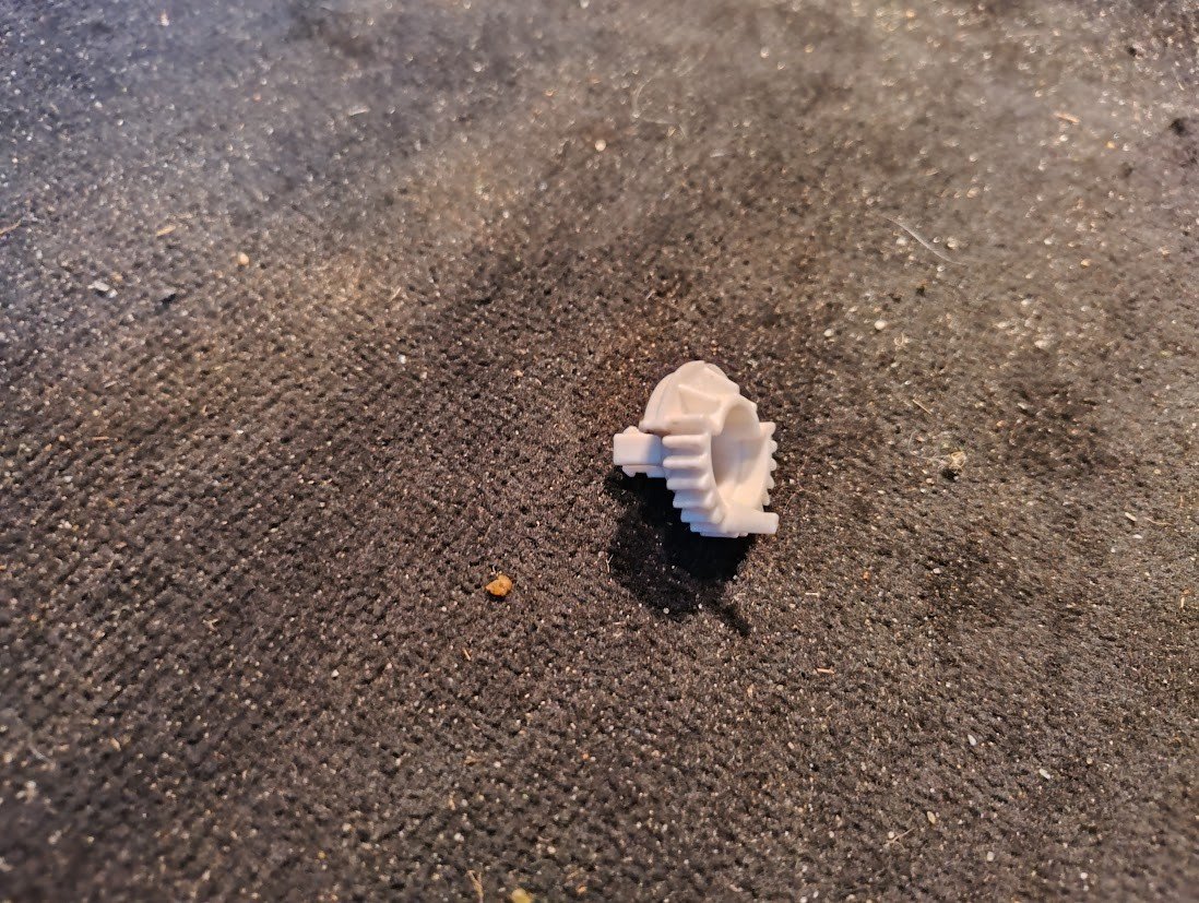

I tried to access the blower, and when dismantling the covers this bit fell out - I can see that it has to go in a socket in the left side (european car)  but I cant figue out how! can anybody help?
And how do I get the blower out if that doesnt solve the problem with the heater - I cant find any obivious way to unscrew it?

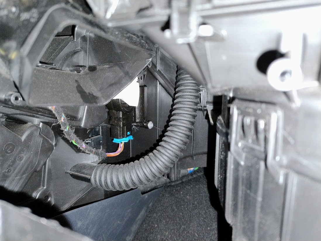

I took another picture - I can see that the fitting goes in here behind the white fitting. but I can't figure out how? And also how in came off?
Does it affect the blower in generel, or is only for some flaps?

This is the temperature flap control motor. The part that fell out is one of the pinions.

I assume you put back the white gear pinion that fell out, just for the sake of not having another set of issues beside the blower.

I did put the pinion (3 on your fine picture) back in place and the adjuster (1) - the pinion hardly move though when I press the control! If I understand it correctly this mechanism controlls distribution of air?
