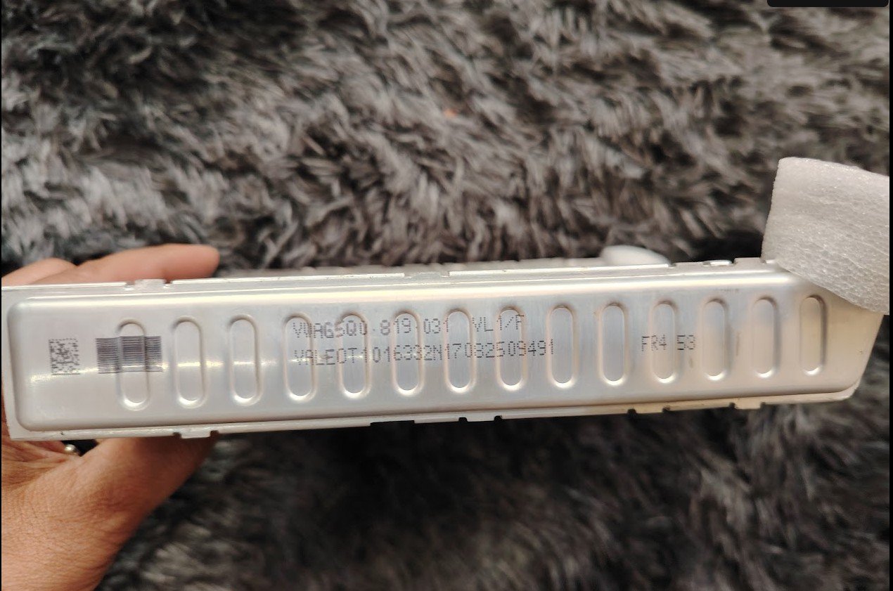

Can anybody tell me the part number of my Heater Matrix. I tried to find it from autodoc but they are saying there are two types and i have to know which one is mine.
thanks in advance.
You'll need to check mate. Its either a valeo unit or denso unit. Take off the trim piece in the passenger footwell and check.

I've just ordered a heater matrix for my 2018 octavia, you either have a denso or valeo system and they are different pipe layouts.
This video shows you how you can gain acess to the matrix to find part numbers for your vehicle.

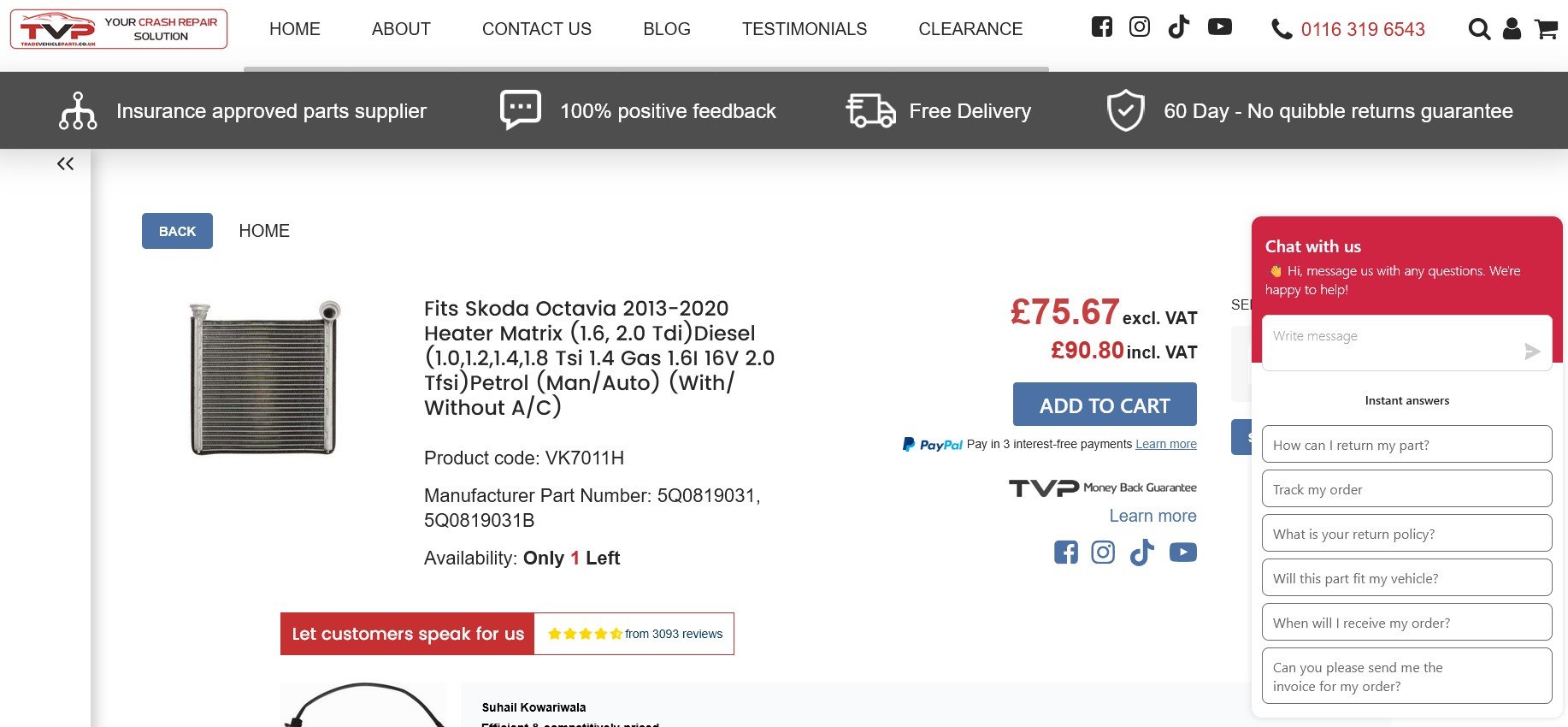

For me, I’d go for the cheapest option. I found one on Amazon for £90.78. Spoke to the sellerover the phone and they said, they source it from a reliable dealer. So the quality doesn’t seem compromised. My coolant was already flushed as a first step in diagnosing the issue. My mechanic showed me one of the hose pipes being colder than the other, which is how he pinpointed the heater matrix blockage. Did you try checking the hoses and feeling the temperature difference? Might help confirm the issue. 🤔🚗
N.B: I've checked the video. the part was given to me doesn't match with this one.  My car is 67 plate (auto). Well, even if my part doesn't fit, at least i can give the old one a try unblocking with oneshot(haha) and then return the new part.

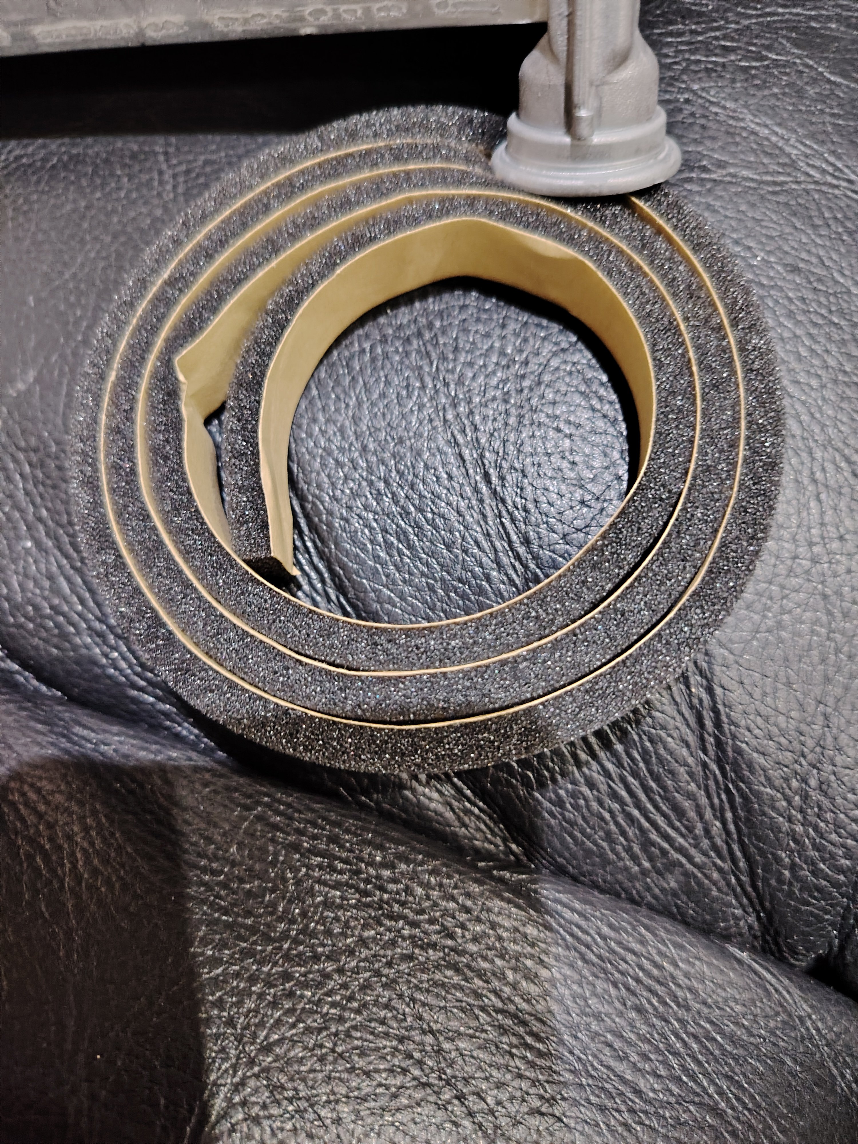

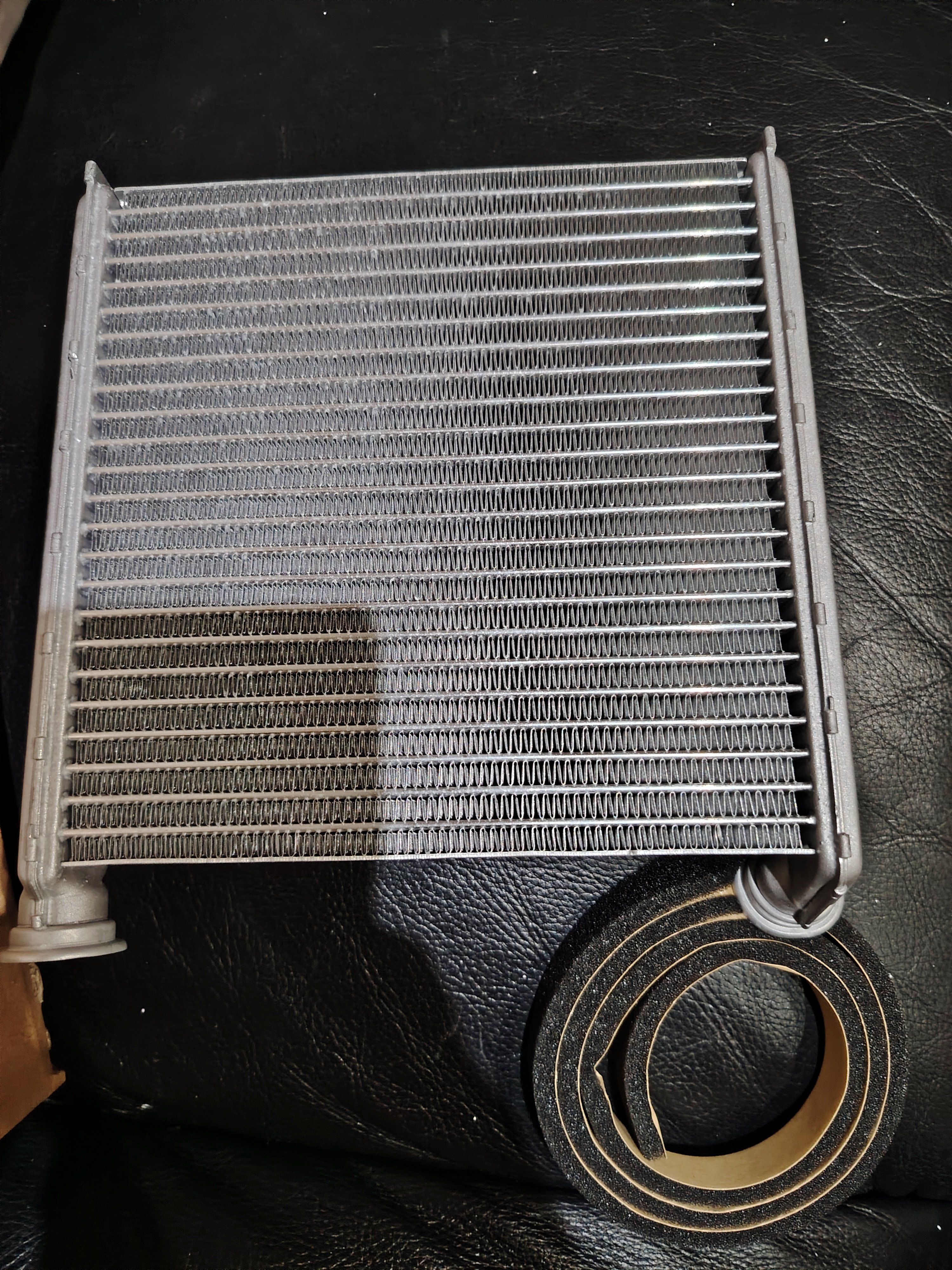

The heater matrix has arrived, along with a foam strip—guessing it's there for a snug, rattle-free fit! Now just waiting for a dry, sunny day to get this swap done. ☀️🔧🚗

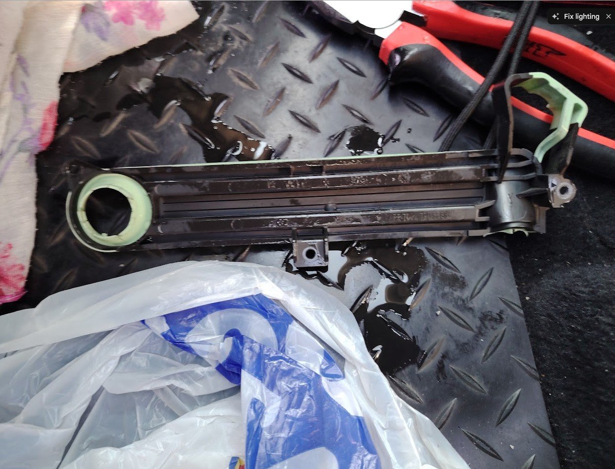

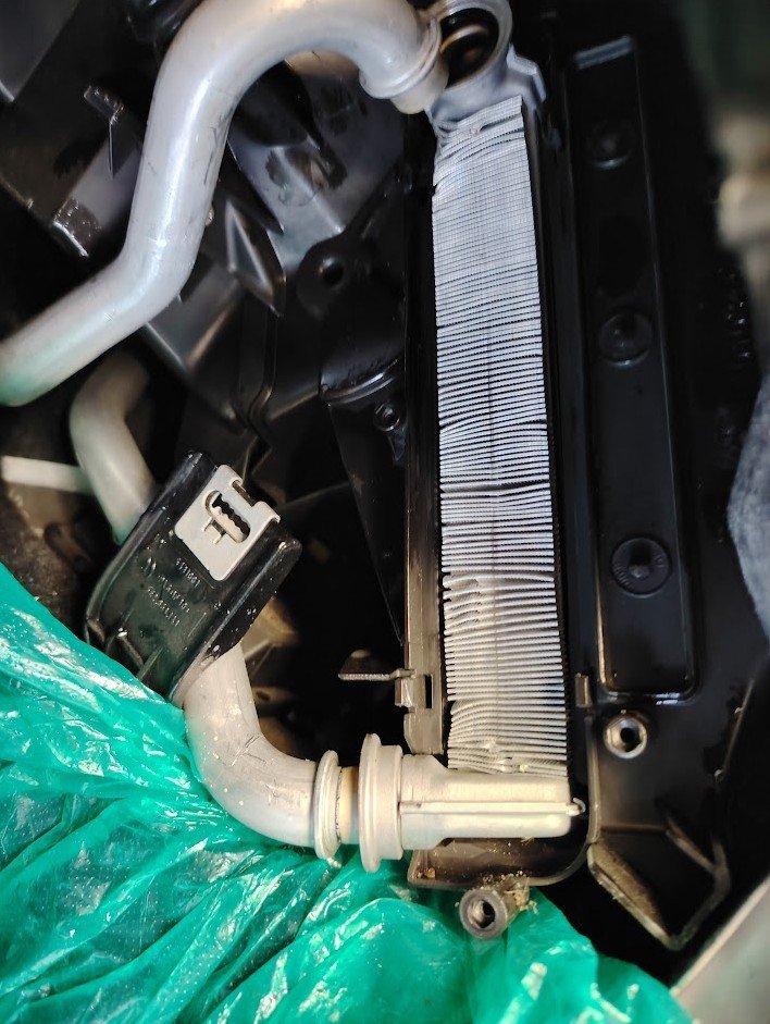

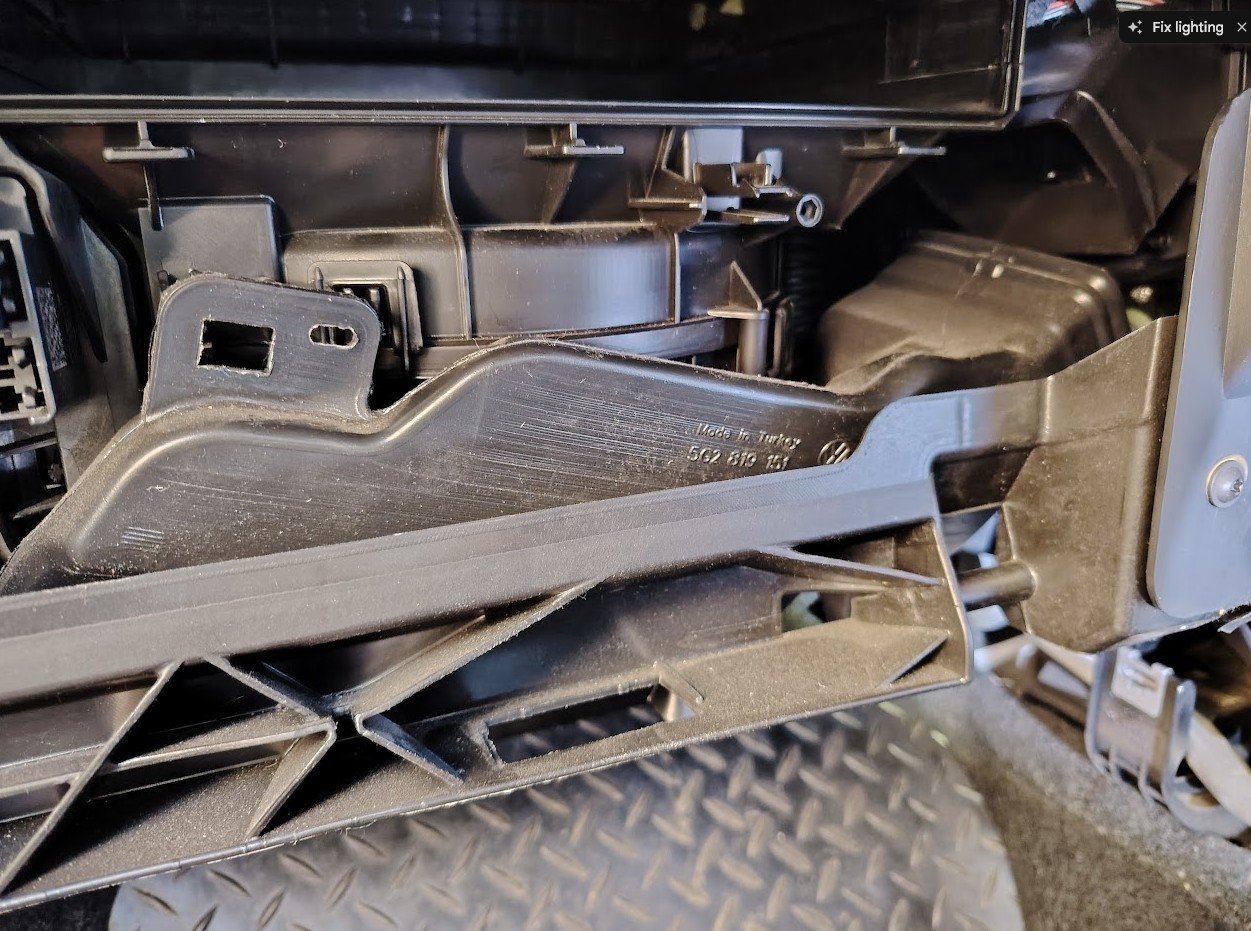

Finally got around to replacing my heater matrix today! Found an exact video on YouTube that matched my car, and wow, it was a lifesaver. My original heater matrix was partially blocked, and now, with the new one swapped in, it’s blowing hot air like a champ! 🥶➡🔥

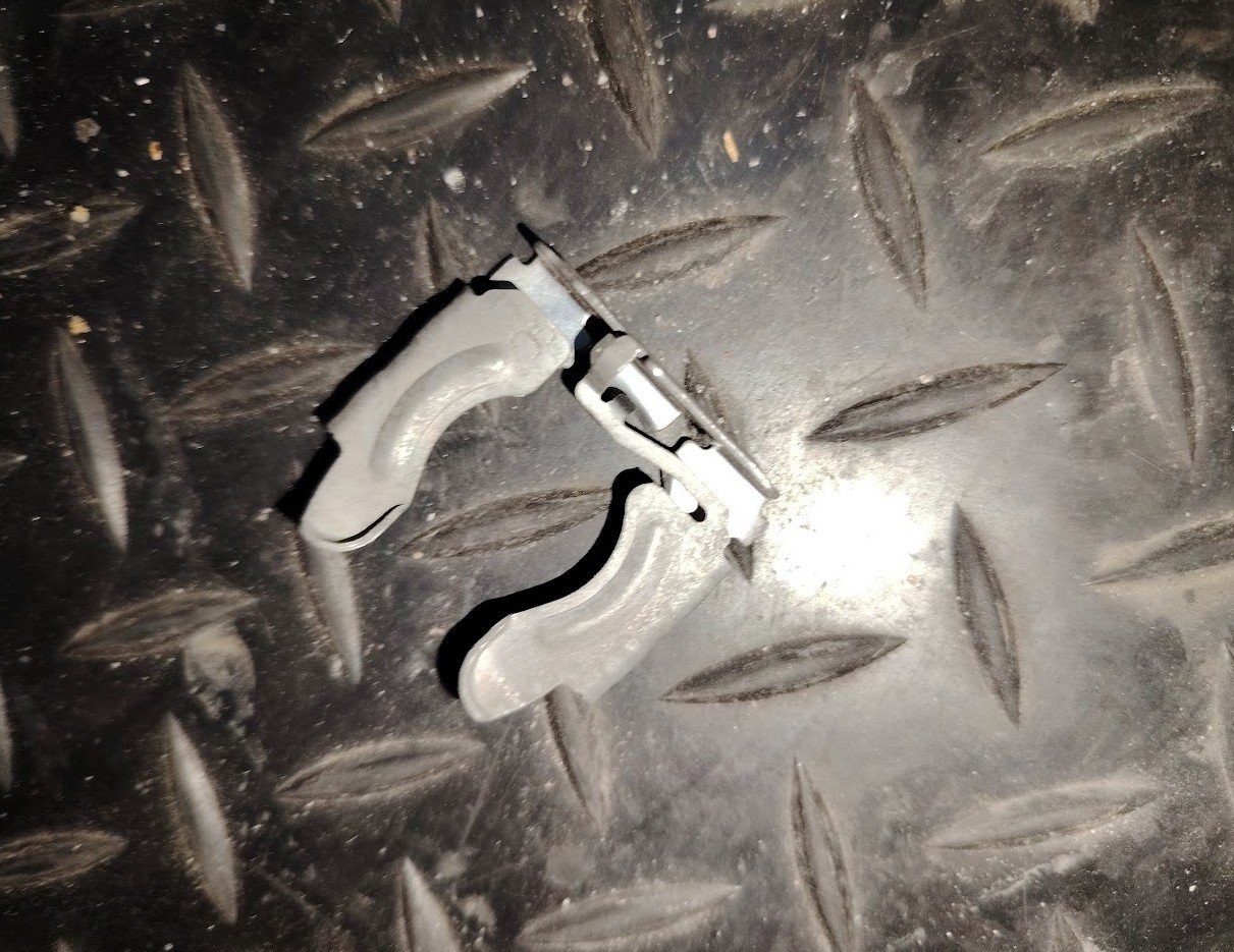

Had to remove the blower motor—just three Torx screws, so no big deal. But... I unnecessarily bent a clip too much and snapped it. 😩 Oh well, it’s still solid with the screws, so I’m not stressing over it.

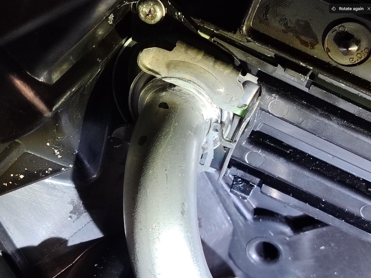

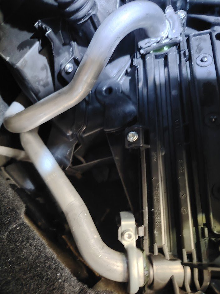

The only thing bugging me now is the heater matrix connections. The top one clips in (see pic), and the bottom one is a push-in with a ring clamp. Never seen this clip before! When pushing the bottom one in, I got that satisfying click, but the top one? Nothing. Then I realised the clip holds both parts tightly together. Hope I got it right! 🤞
Let’s see how it goes! Uploaded some pics—no video, though.
