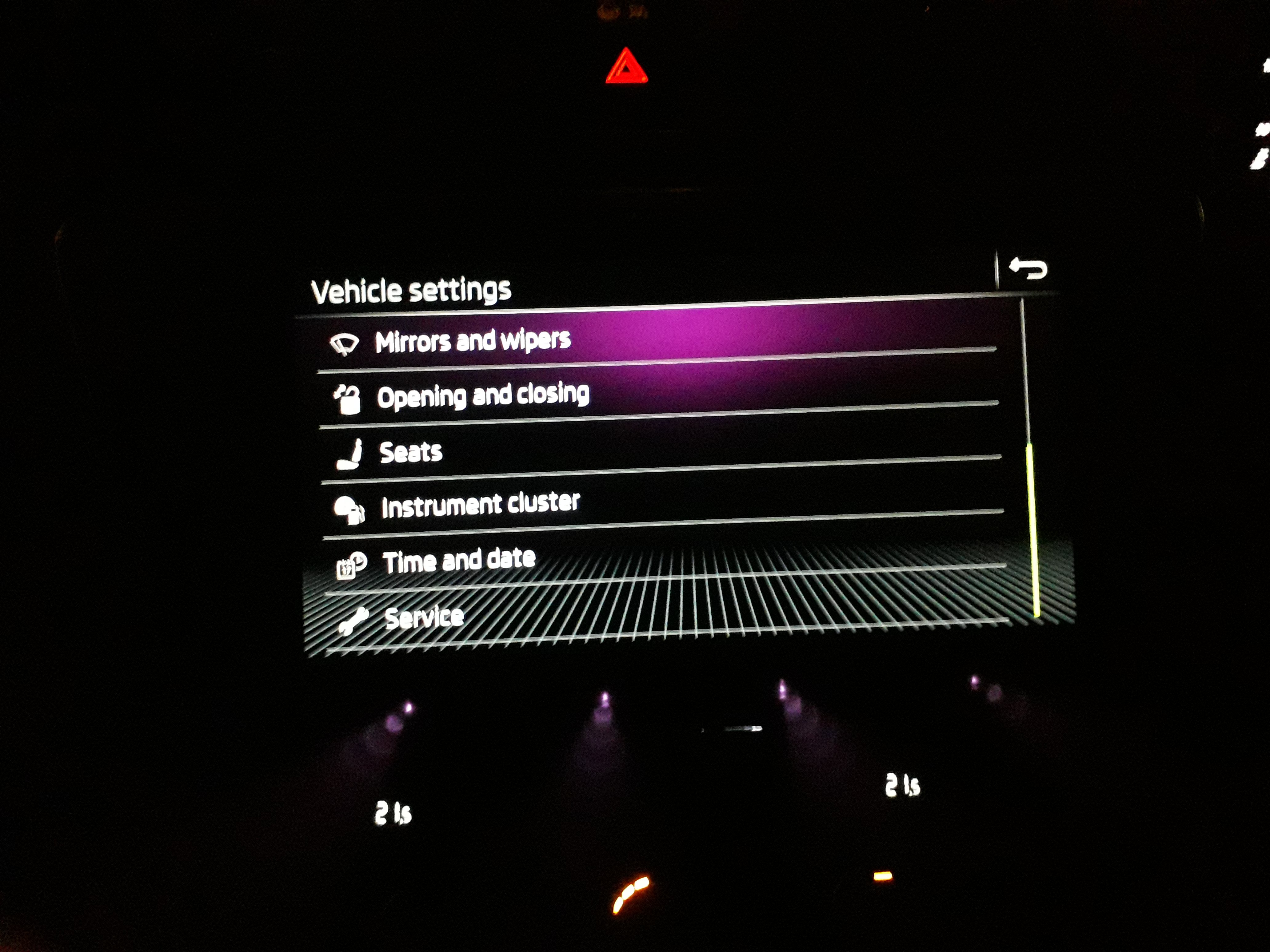

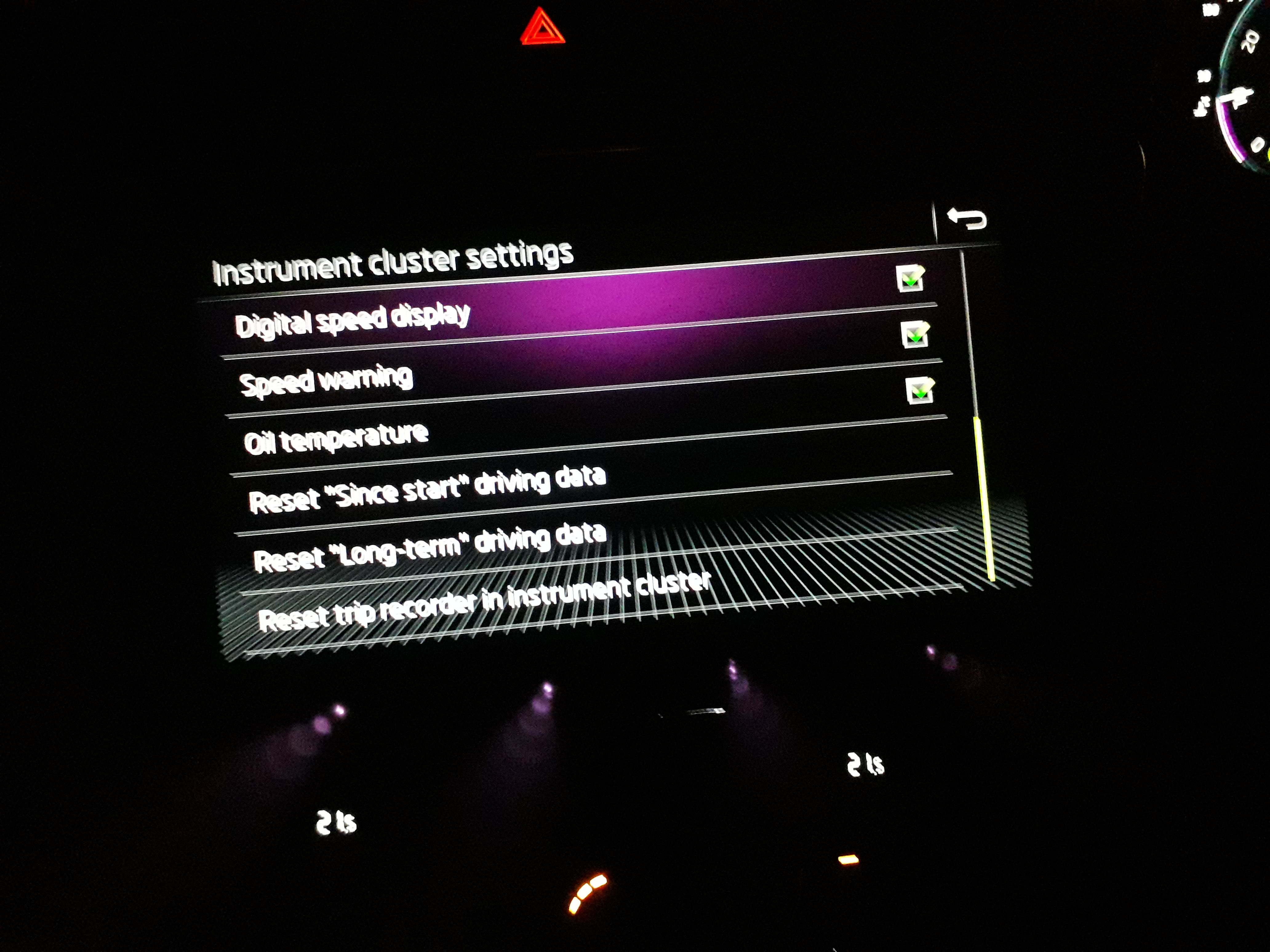

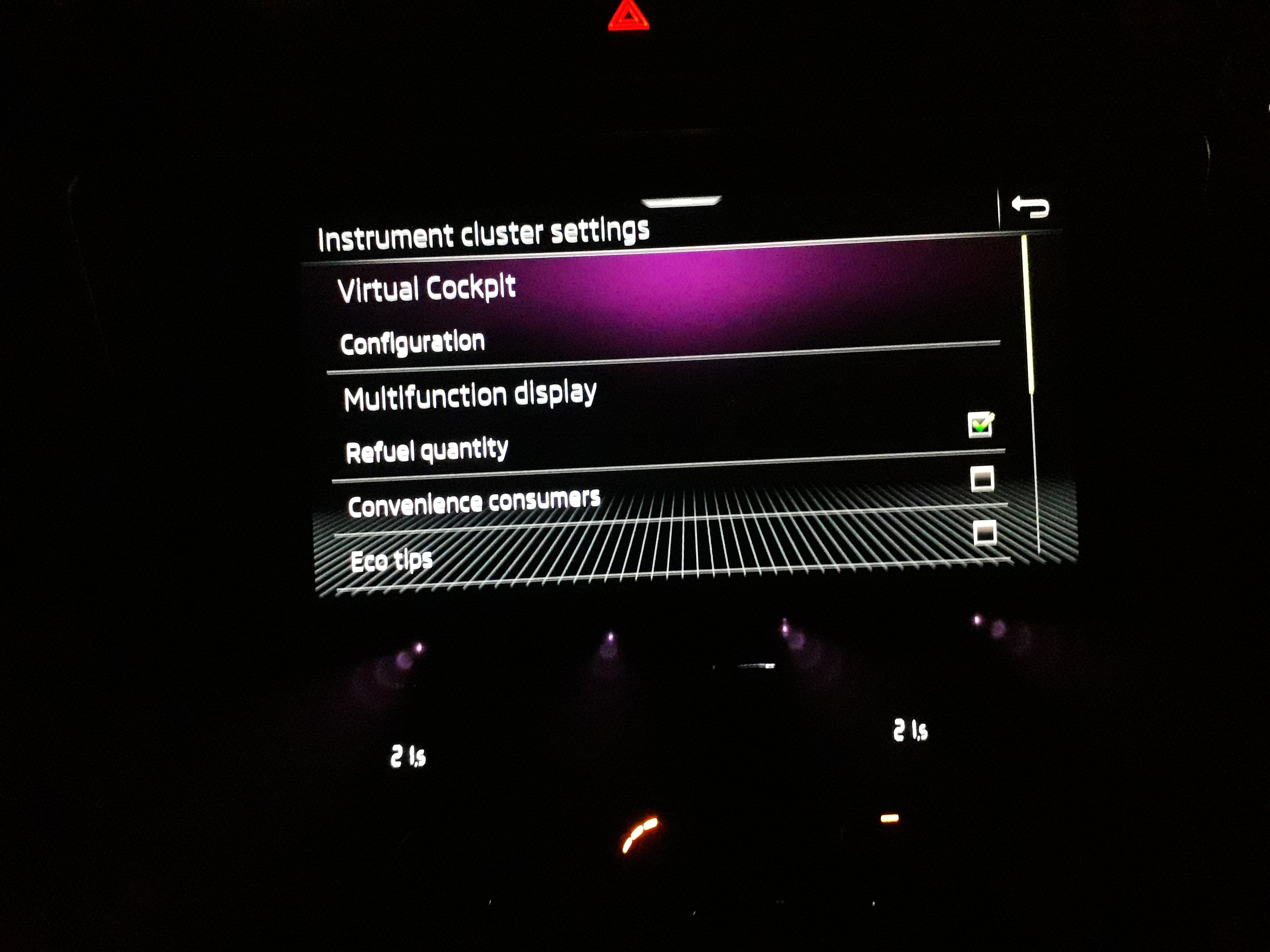

Hi,
These are pictures of the vehicle settings and instrument cluster settings.
20250131_171722.thumb.jpg.4b1bcba6b39bcafce7fd6404a17e641e.jpg20250131_171714.thumb.jpg.3ba3b7b416bf88ef0a99d3defa86e97f.jpg
On mine is here between Time & Date and service.
