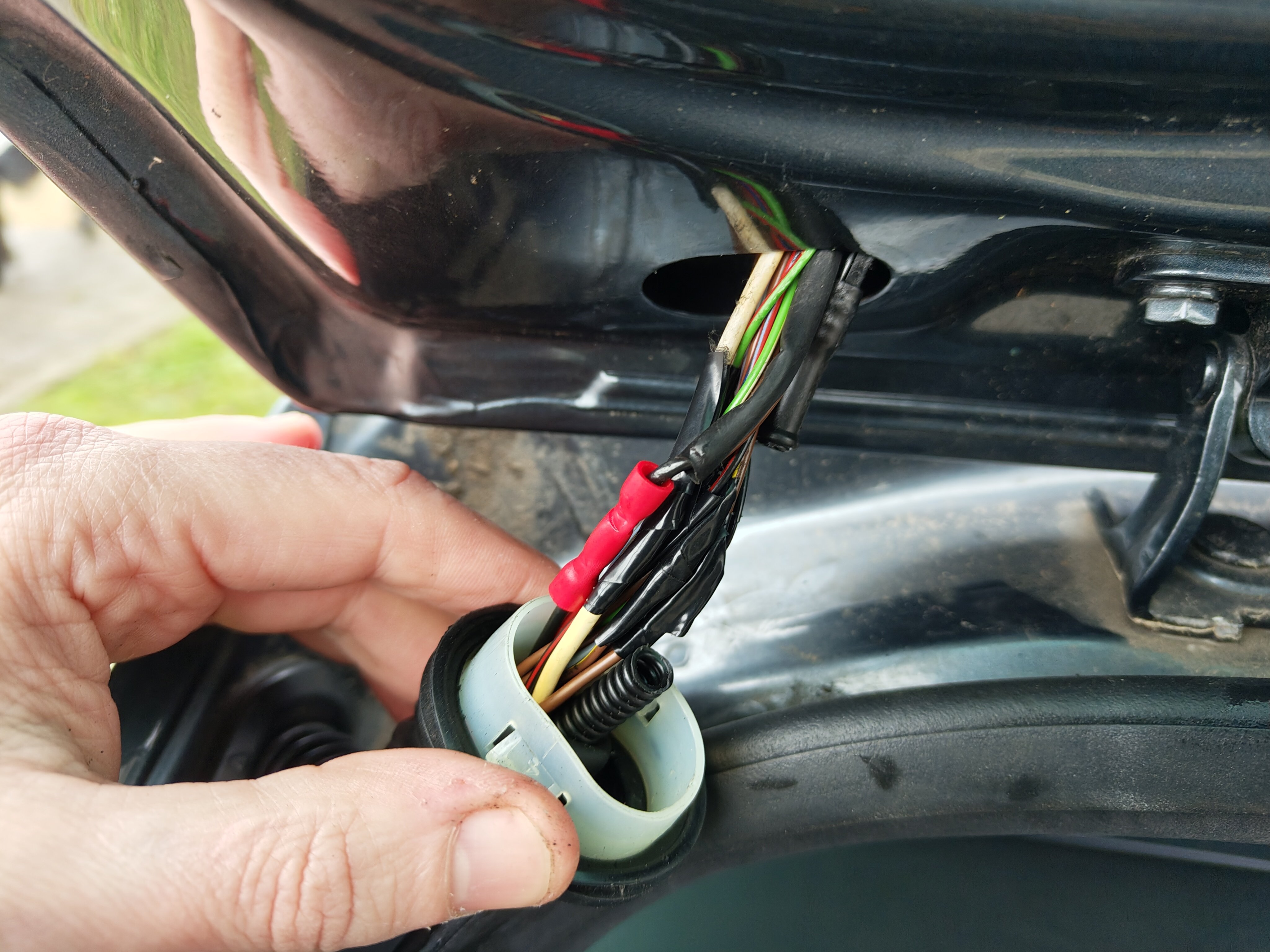

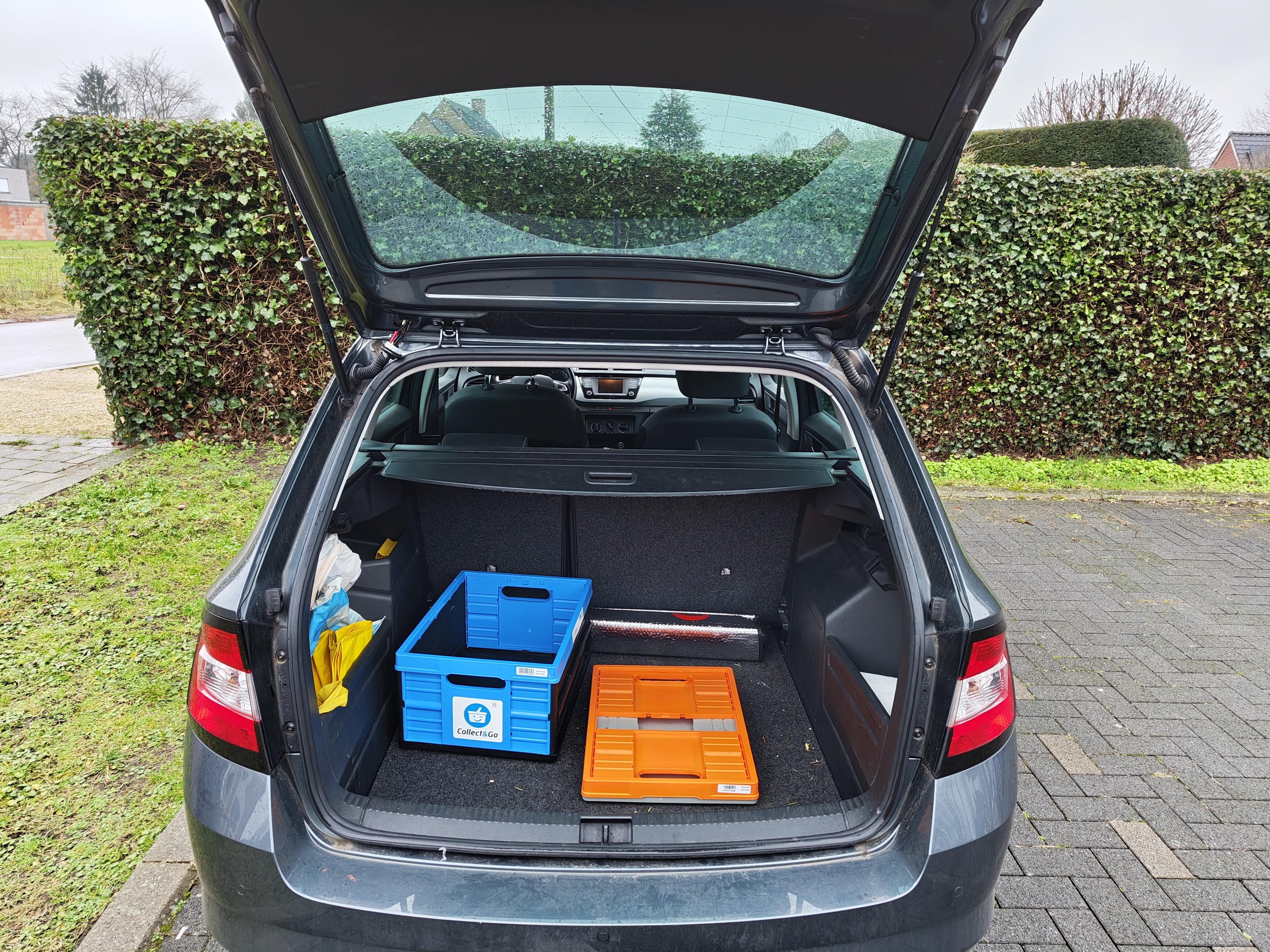

The tube for the windshield washer fluid of the rear window has broken off (see pictures). At the local car part shop I bought a fuel hose with an inner diameter of 7 mm; but the outer diameter is too big to fit into the rubber cover...
At the local workshop I was advised to remove the cover of the C pillar, and try to connect to a new tube there, all the way to the end of the existing tube (thus replacing it as from the new hose).
Does anyone have any experience with this issue? Or with removing the C pillar of this model? I found this YouTube video, but it's about a Mk 1 Fabia, not a Mk 3 Combi...
Thanks in advance for anyone's feedback!
(The sharp edges of the broken tube had damaged the insulation around the electrical wiring, and my trying to get the fluid to the window caused the fluid to run over the exposed wiring, hence the tape around them...)

None of the taping on the wires looks great but if the wires are securely joined and protected then OK.  The red crimp connector has different levels of indent in the connector so check the wires are fully working before completing the job.
There are all sorts of connectors and tubing available on the internet are you sure there is nothing available to successfully bridge the gap on your washer tube connection without having to remove c-pillar cover.  HatBoyHarvey's videos are usually very good pity he has not got a Mk3.

One late comment I'll make here, I'd never ever fit a crimp joining piece within the area of this wiring that gets flexing when the hatch is being opened - that might just be what caused the pipe to separate at that point, always make two repairs to any wires that get damaged for broken within that flexing area, one within the car's body and another within the hatch body.
Also fitting a general purpose "crimp joining piece" is just being very lazy, there are better ways to effect a wiring repair so that the repair lasts long enough.
