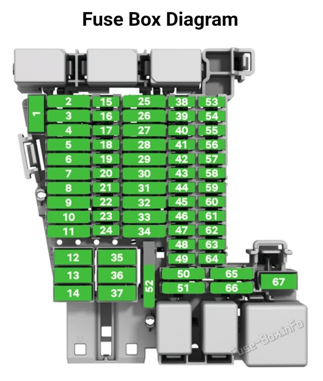

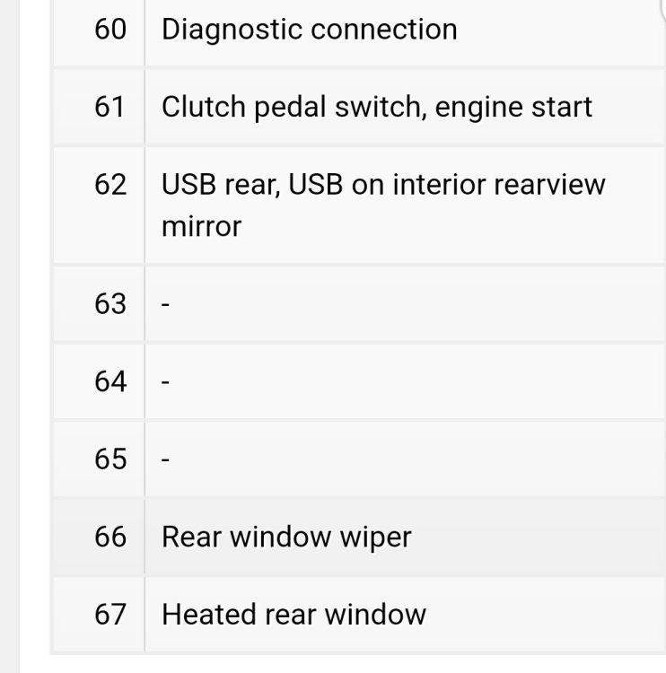

I just noticed that you were asking about the rear wiper, that has a fuse located in the fuse box behind the glovebox.
According to my records, the Rear Wiper fuse is number 66. I would try looking at that first. Good luck.
