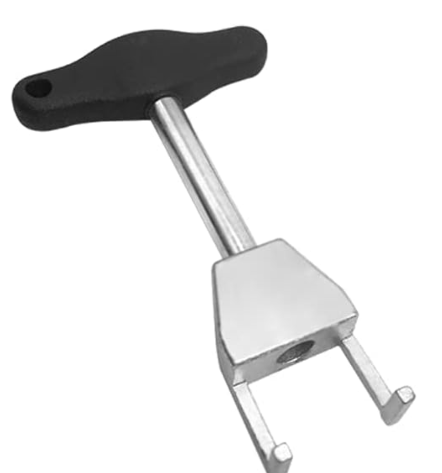

Someone may find this useful Shout out to my coil removal tool (VW T10094A) makes the job a lot easier
