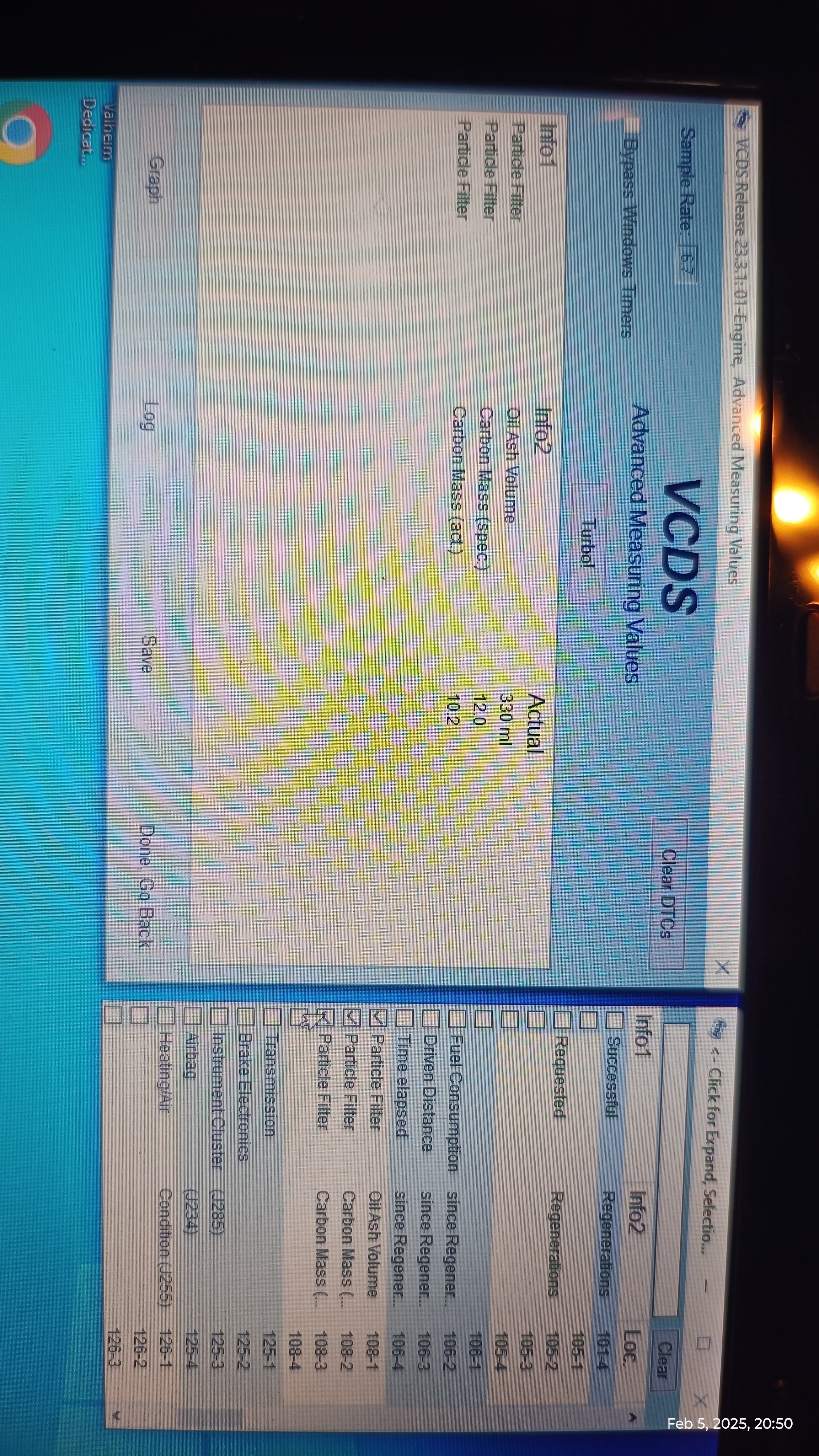

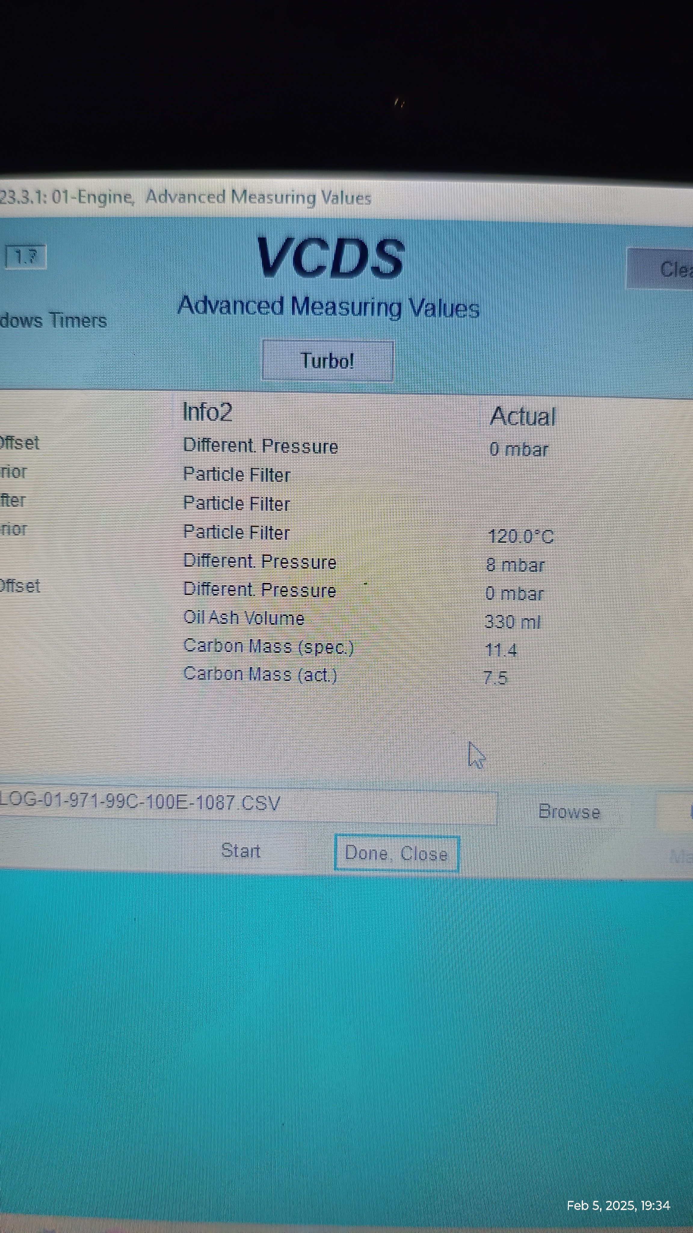

Hello,
Recently I started noticing more regens, mostly due to not driving too much on the highway.
I checked with VCDS, but can't make heads or tails of these readings.
Sorry for low quality pics.
I drive each week on the highway at 3k+ rpm, and it seems to help, but daily I drive 10km in the city, and almost every week I get regen cycles starting in the city.
Even after a long drive 200+ km, when I park, it still wants to spend another 20 minutes finishing a cycle.
Is my DPF full?
I dont have a max volume ID, or I am not looking in the right place...

A lot have said 250ml ash volume = full DPF.

Its getting close to 470.000km
Idk about the oil ash volume, so far it seems to be a static value in VCDS, never seen it change, but the other two do change and I need to have the spec above 36g to trigger an active regen manually, the ECU will not let me otherwise, and I've never been able to catch it at that high value.
Since this started after I stopped adding additives, I started again.
In addition to Metabond Megasel, I've thrown a bottle of DPFCC, and it worked...
I've refilled 4 or 5 times since then, and I've allways added 4-5ml of additives per 10L of premium diesel.
Still smokes a bit when cold starting, but nothing excessive, and especially when its cold outside.
A bit of moderate smoking when the active regen is close to finishing, but only did it once so far, after approx 600km, in the middle of a trip.
I've also felt a slight increase in power, as it started screching its wheels when flooring it hard from stop.
Noticed this in an intersection, I still have winter tires and the road was dry, and I have really grippy tires.
I guess short hops and cold weather did a number on my dpf, but it still says 300ml, even when the other values are 5mg for spec and 0 for calc.
