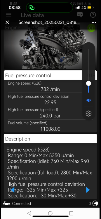

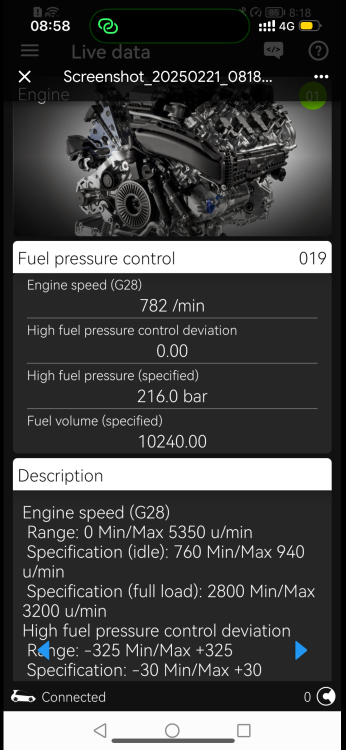

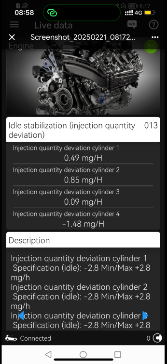

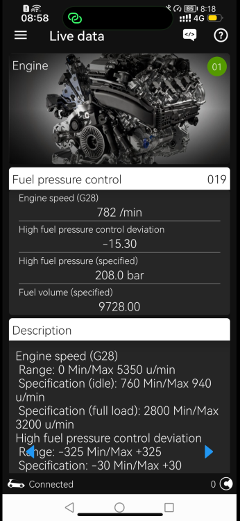

Hey there, i have a skoda octavia mk 2 vrs from 2008 2.0 tdi CEGA CR , yesterday after a short drive the engine started vibrating and some smoke came from exhaust , Er code : rail pressure to high
on vcds it the injector qt are all messed up … and the high fuel pressure control deviation keeps jumping from -20 to + 30 on idle
Mentioning that the injector seals where changed like 1.000 km ago, and everything was all right till yesterday
What should i expect from it ? 🤨
Thanks
