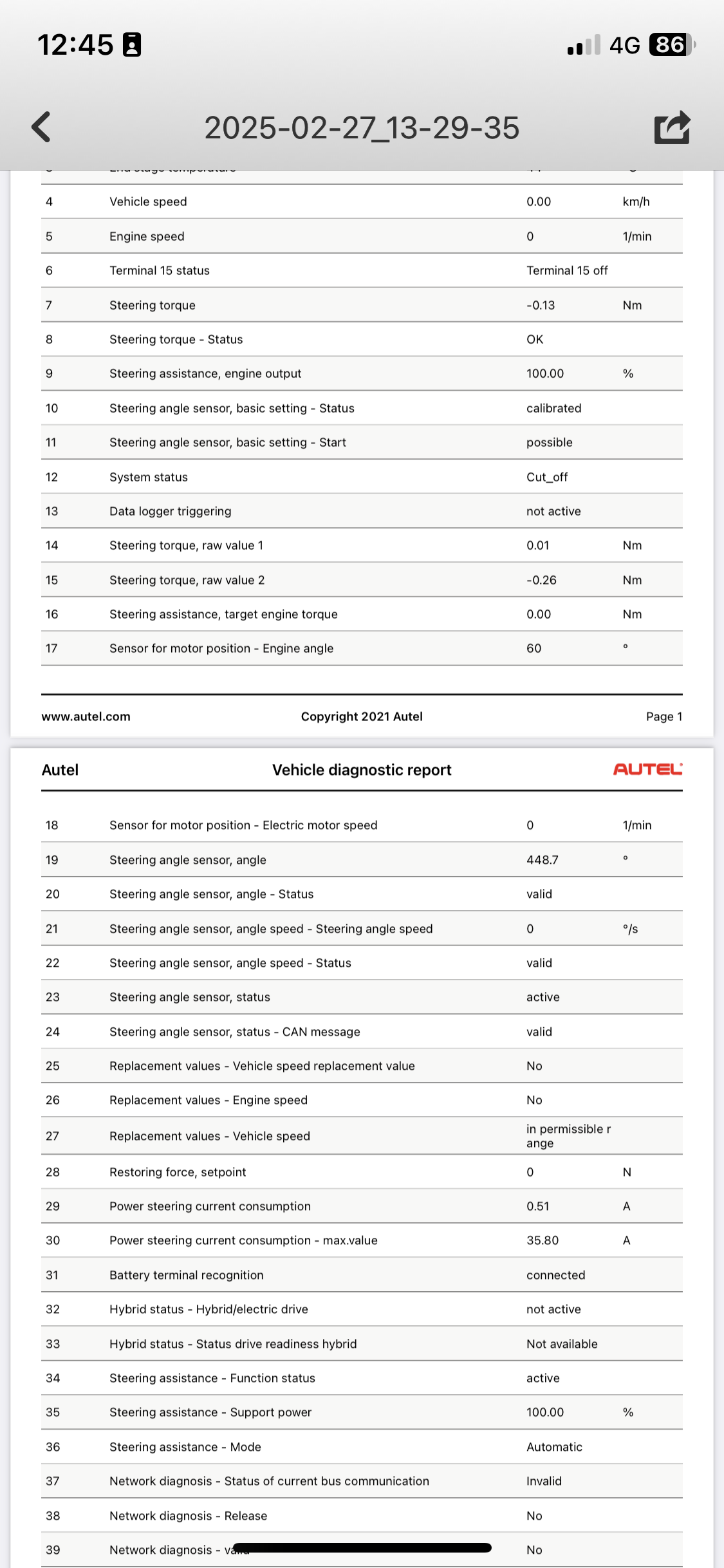

Cheers pal, The steering angle is set not sure if it can be calibrated better using the in car procedure
I can set the steering centre to 0.0 using autel however how could i delete the Steering angle and start over Disconnect battery?
Also looking at the picture the steering assist is set to Automatic
again i feel the steering end stops were a definite stop at the rack before, now its feels like the stop is at the tie rod possibly stresses the tie rods to pre-mature failure
No idea if this has been done intentionally or not, How can changing tie rods effect the electronics? Or does the rack detect / lose steering pressure thus resets to default idk

Your report doesn't show car (or tool if appropriate) battery voltage and I've not really looked too hard at the report but I did wonder at 19. steering angle sensor, angle  448.7 degrees if your steering wheel was dead ahead.

Your report doesn't show car (or tool if appropriate) battery voltage and I've not really looked to hard at it but I did wonder at 19. steering angle sensor, angle  448.7 degrees.

Btw the steering wheel was most likely turned when i screen shot this diag
