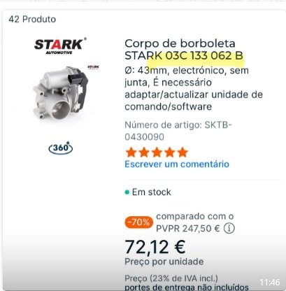

The car has this problem, when in motion I press the clutch to change gear it accelerates, I went to the mechanic and he said it was the throttle body, it needed to be changed, a lot of money, it would be easier for me to change it

As I mentioned I went to an Auto Mechanic! and he told me it was the Butterfly body, I went to two mechanics, my only doubt is whether after putting another butterfly body I need to use a Scanner, or if disconnecting the car battery will make it normal

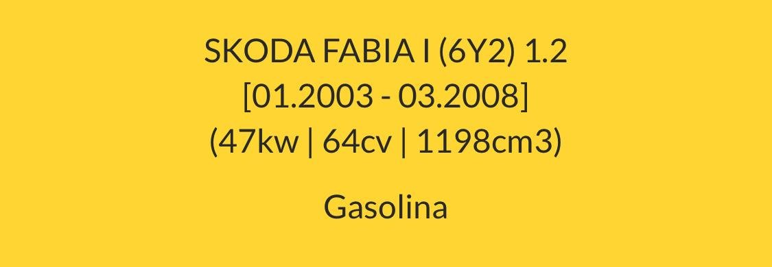

Good morning, I changed the Throttle Body for Skoda Fabia I (6Y2) 1.2 (47w | 64KW | 1198cm3 USED Gasoline and the problem remains the same whenever I press the clutch to change gear the revs go up, it accelerates without touching the accelerator, do I have to put the scanner in?

I did this and it's ok I'll buy a new one thanks for the help
