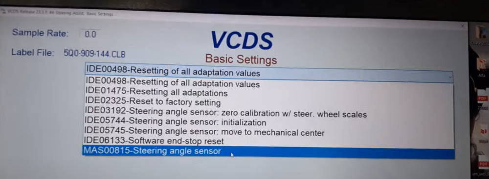

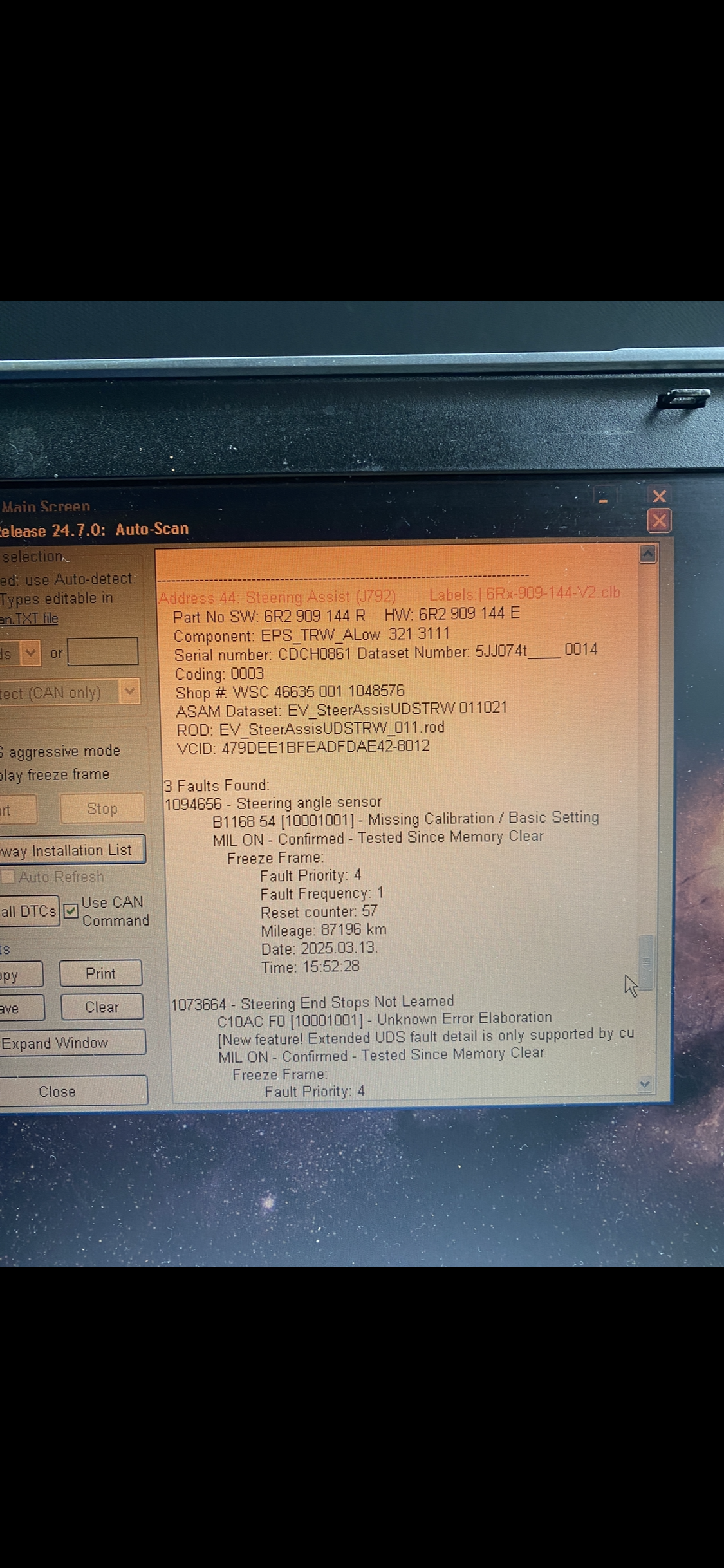

44 - steering Reset to factory
Previous to this car had no faults or warning lights
Reset to factory settings now i can’t set steering angle or enter measuring blocks etc
Fault codes are
Steering Angle not set
end stops not learned
However VCDS states error or malfunction when trying to calibrate in Basic settings?

When trying to set steering angle VCDS state malfunction or error in 03 -ABS or 44- steering
Ive just took it for a drive, it feels like the drivers side end stop is software controlled now but the passengers still feels like the tie rod end is taking the brunt of it
Assisted steering seems working fine on dynamic
Obviously feels unstable while driving as the Electronic stability fault light is still illuminated
Steering angle is still not set and stays at 0* while monitoring values

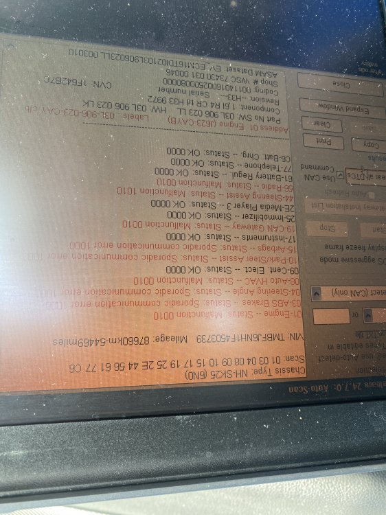

In future, just post a full autoscan using copy and paste rather than pictures. It will give a fuller story and is easier to read 🙂
One bit of advice I can give, generally hold your photo so that you get a landscape instead of portrait photo generally this gets more information in the photo for car matters and if you can narrow the left sidebar on the VCDS screen box the full line could be seen on "10736664 - Steering End Stops Not Learned" (SIC?) especially in landscape.
6 hours ago, langers2k said:
Have you done the obvious?
  • Check the steering angle output is plausible (0 in the middle and changes as you move the wheel)
  • Steering angle sensor basic settings (either in ABS or Steering)
  • Moved the wheel full left, then right, then center

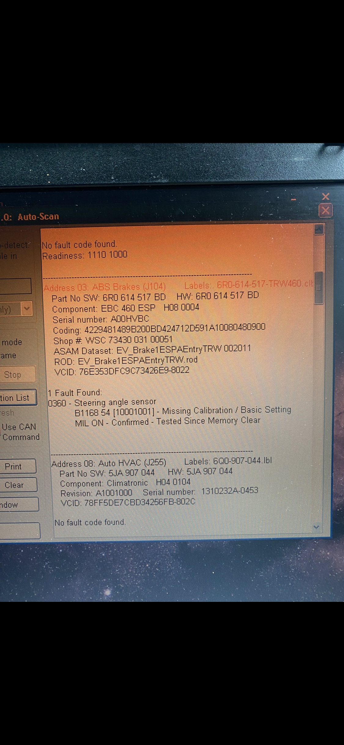

original car was steering perfectly, decided to fit new arb bushes & while on the ramp renew tie rods lower arms etc
alignment done
yes, previous to me resetting the steering angle would move from 0* + & -
no fault codes or lights
However i reset because when i looked at VCDS the steering assist was set to Unknown instead of auto comfort or dynamic
And the steering was still somewhat heavy,
after reset the steering assist is set to dynamic
however now the steering angle doesnt move from 0* & fault codes / amber lights

2 Faults Found:
0360 - Steering angle sensor
B1168 54 [10001001] - Missing Calibration / Basic Setting
MIL ON - Confirmed - Tested Since Memory Clear
0349 - Steering Angle Sensor
B1168 F2 [10001001] - Not Initialized

Address 44: Steering Assist (J792) Labels:| 6Rx-909-144-V2.clb
Part No SW: 6R2 909 144 R HW: 6R2 909 144 E
Component: EPS_TRW_ALow 321 3111
Serial number: CDCH0861 Dataset Number: 5JJ074t____ 0014
Coding: 0003
Shop #: WSC 46635 001 1048576
ASAM Dataset: EV_SteerAssisUDSTRW 011021
ROD: EV_SteerAssisUDSTRW_011.rod
VCID: 479DEE1BFEADFDAE42-8012
3 Faults Found:
1094656 - Steering angle sensor
Freeze Frame:
Fault Priority: 4
Fault Frequency: 1
Reset counter: 59
Mileage: 87269 km
Date: 2025.03.13.
Time: 10:39:31
1073664 - Steering End Stops Not Learned
C10AC F0 [10001001] - Unknown Error Elaboration
[New feature! Extended UDS fault detail is only supported by current gen. interfaces]
Freeze Frame:
Fault Priority: 4
Fault Frequency: 1
Reset counter: 59
Mileage: 87269 km
Date: 2025.03.13.
Time: 10:39:31
1073920 - Steering End Stops Not Learned
Freeze Frame:
Fault Priority: 4
Fault Frequency: 1
Reset counter: 59
Mileage: 87269 km
Date: 2025.03.13.
Time: 10:39:31

Somehow the steering assist setting was corrupt displaying “unknown” instead of comfort/Auto/Dynamic ~ no idea why this happened
There was no fault codes or dash lights until i reset the steering assist module in VCDS
I’ll try and double check the vin/coding to the module’s if i get the chance however if ODIS can do this easily then i’ve had enough these new 2000’s cars are terrible bring back mk2 golfs
Good & bad news lol
Car EPS/ABS was fixed using ODIS
Steering was stronger less road vibration through steering wheel, ABS & traction control working, slight veering to left though? Steering Torque?
However Driving back the car felt not great
checking the autoscan it had faults everywhere nearly every module (as the photo)
So I cleared the DTC’s and back to square one dash lights back on
Lucky i saved auto-scan before clearing anything, nothing seems different apart from an extra fault code B200500 & WS number
