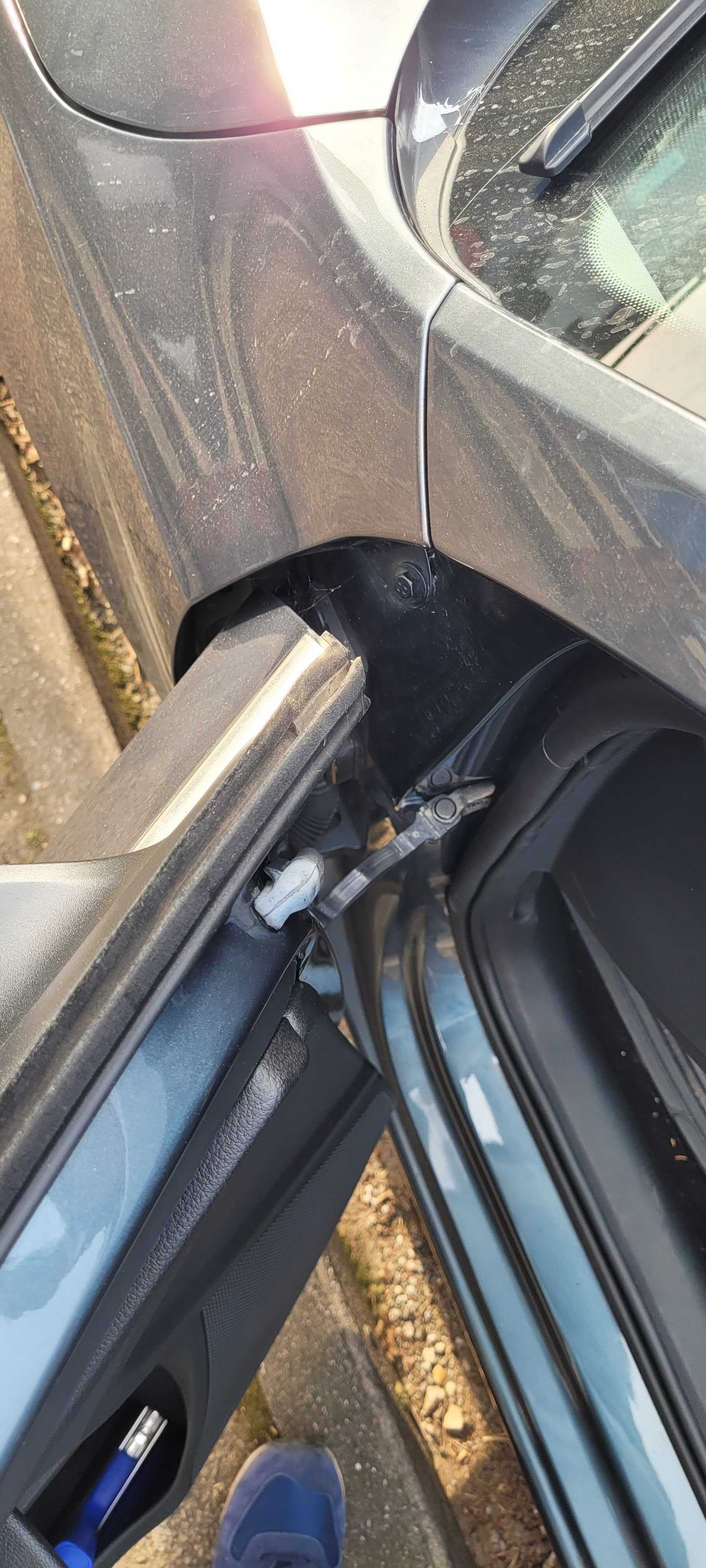

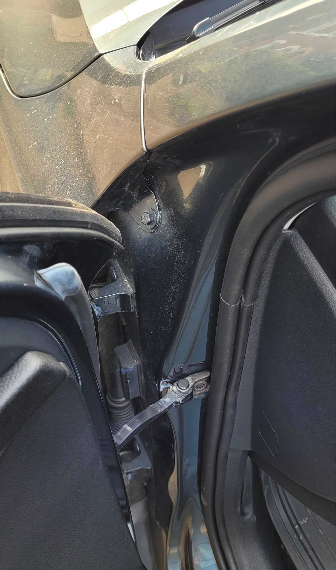

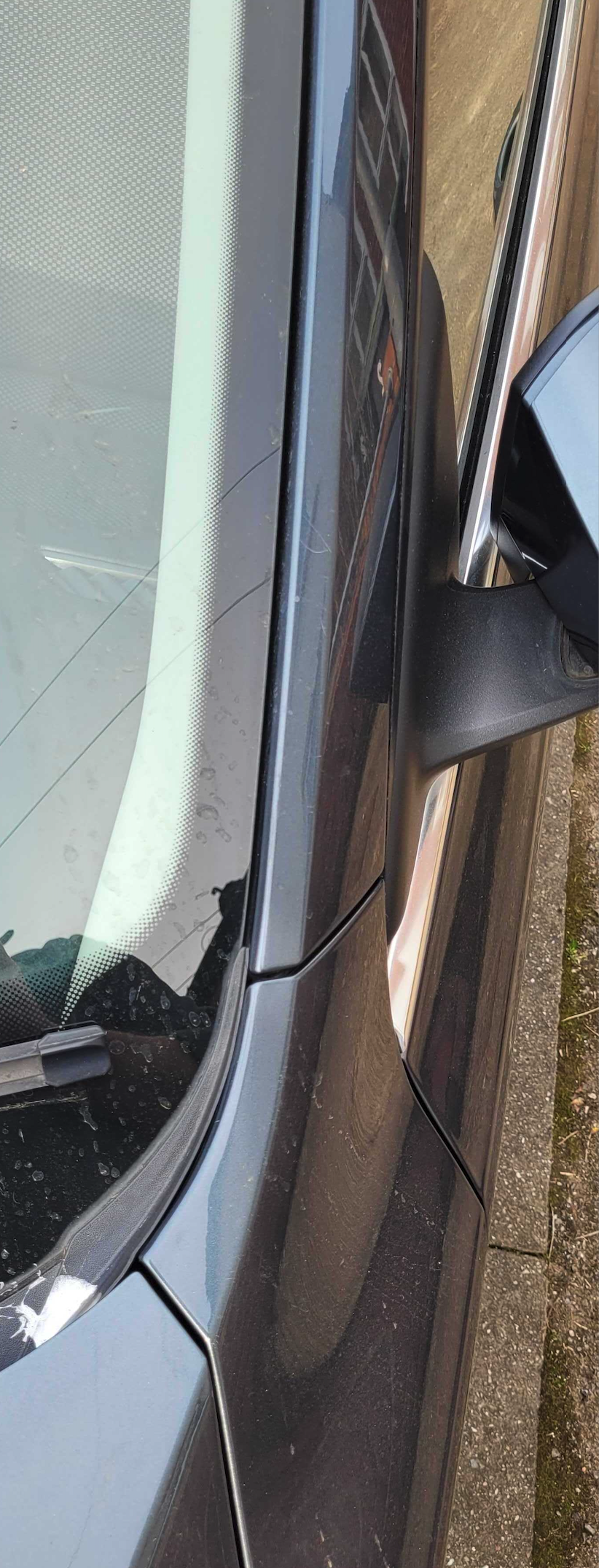

Pics posted in case someone can spot something unusual..

Is the window glass original? If it has been replaced/smashed in the past, the metal gap in which the window sits can be uneven and allows too much acoustic vibration.
Aside from taking all door trim off and evening out the window slot (lots of work without guarantee of success), a much easier thing that you could try beforehand is to put a couple 10mm wide x 1mm-2mm thick sponge neoprene rubber strips (sticky on one side) inside the outer window seal grooves. This will press the window more firmly against the other window seals when the window is fully up. If this reduces your noise a lot, it's a cheap fix. If not, the precut sponge neoprene rubber is cheap so little harm done other than 10mins lost to put in / pull out the strips.
I had a similar problem on driver side (window smashed/replaced before I bought the car, I actually replaced the glass on both sides with original Skoda glass a short while later), except in my case it's above 100mph... autobahn runs. Now largely addressed for some years by the said neoprene strips, though still driver side marginally noisier than passenger side. I did replace the door trim and the window seals on the side where the window had been smashed, and noticed the window gap was quite uneven. In hindsight, I should have tightened it further and evened it out, but could not be bothered to take the door trim off again at the time.
Thanks dieselv6 - I'm not sure if the glass has been replaced as I haven't owned it from new, but that's another good avenue to explore. Thanks for the tip. Neoprene strips arriving in a couple of days!
