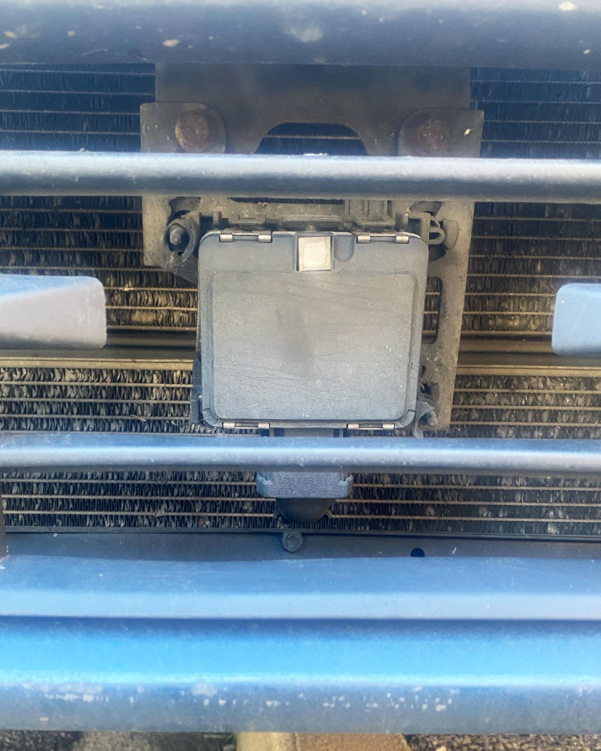

  • Eyeballing it, the face of the sensor doesn't appear to sit perpendicular to the road surface. This may well be by design – I only mention it because I saw someone reference this in another thread
  • The top lift leg of the mount wiggles back and forth easily. Is this normal? Someone else mentioned this exact issue in another thread so, again, this may be by design
  • On that note, any pictures of a working setup would be appreciated so I can compare it to mine

There should not be any movement in the radar sensor, check that the mounts haven't been damaged or broken.
Hopefully the sensor will be undamaged if it's just been displaced in a parking bump.
Radar will almost certainly require recalibration if the mounts are replaced.

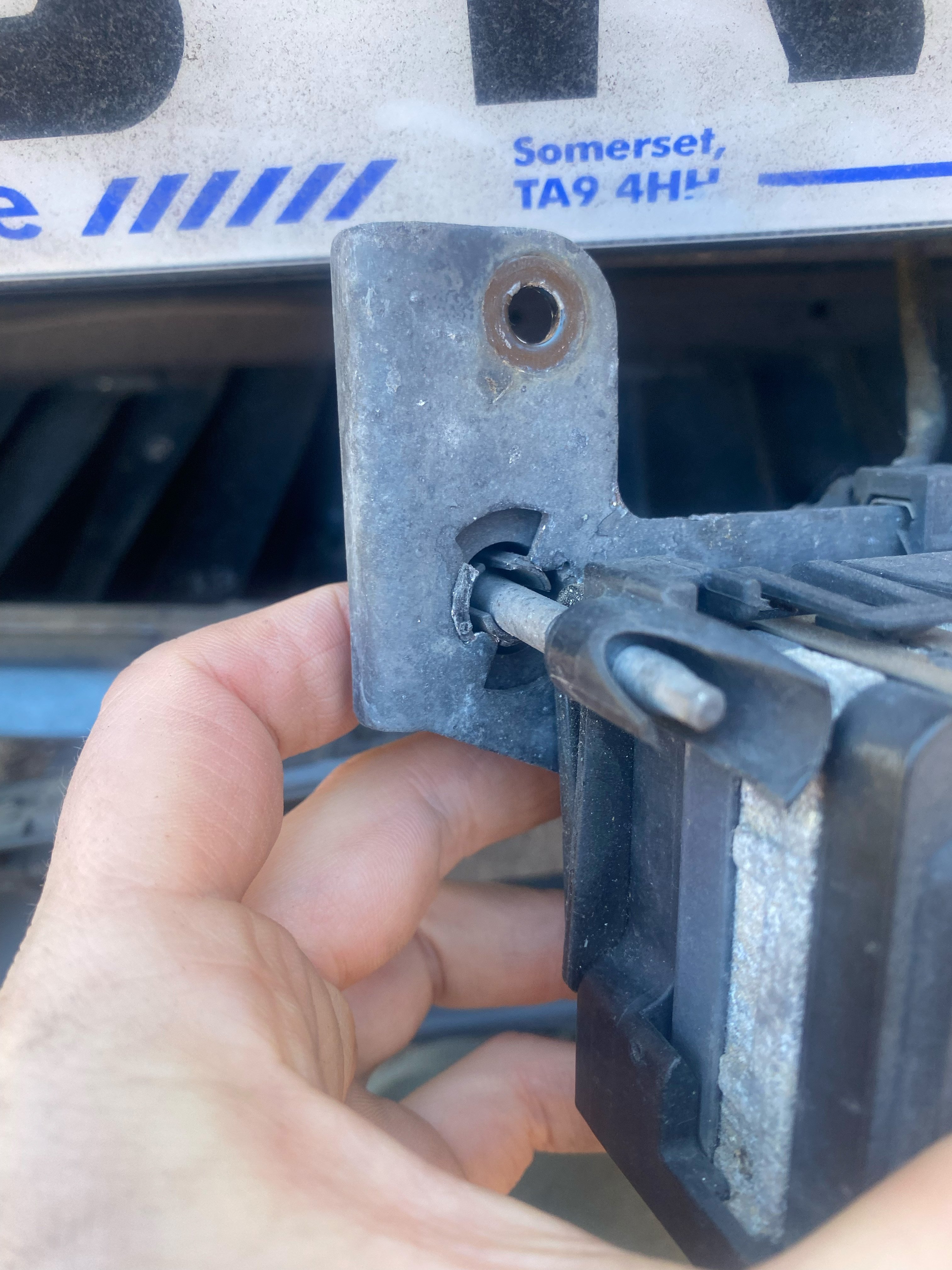

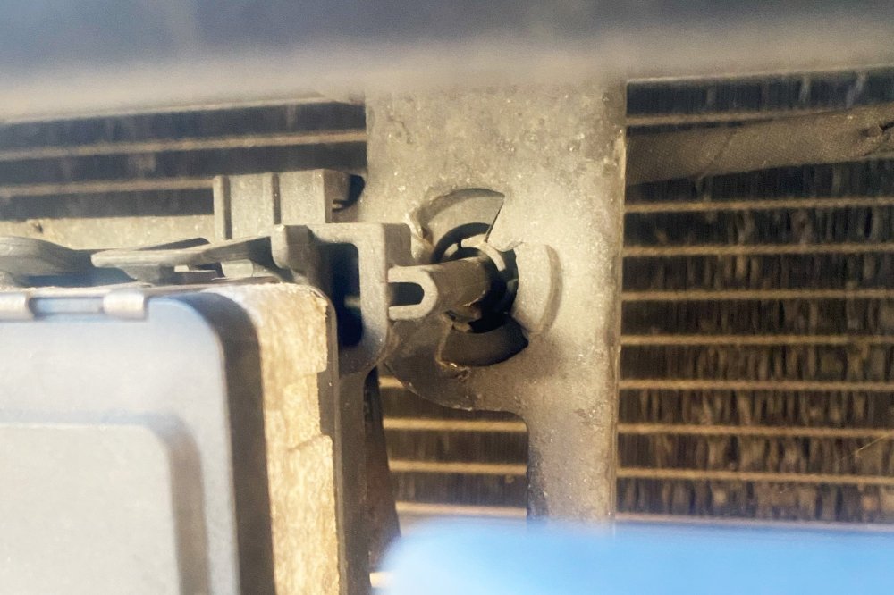

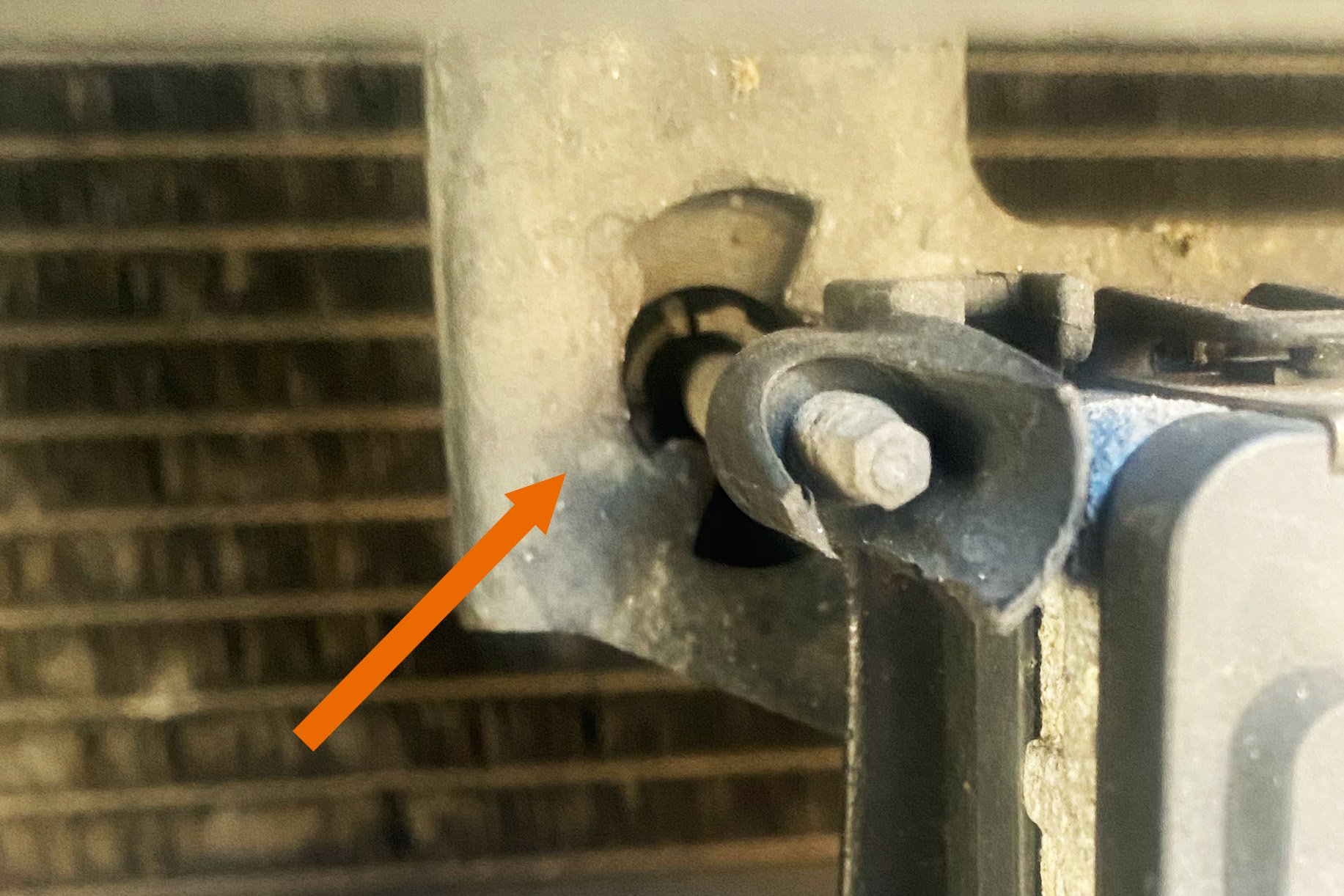

I've had a good look at the mount in the cold light of day. The top left plastic pin/mount is sitting behind the metal mounting bracket.

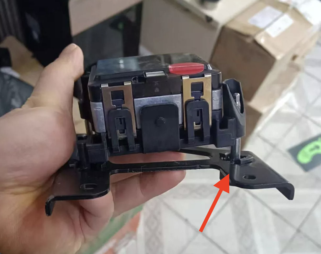

Comparing this to images of mounts on eBay, it appears this is broken, or has been pushed behind the bracket.

Likewise, the right-hand mounts on the bracket of my car look as per the eBay image.
Otherwise, the mount and radar system look fine to my untrained eye.

It does appear that your mount is broken, most likely that the grill has been nudged in a parking manoeuvre, deflecting it sufficiently to push the sensor back. I would think it's possible to confirm the radar sensor functionality with VCDS, but certainly worth replacing the mount and getting the calibration checked.

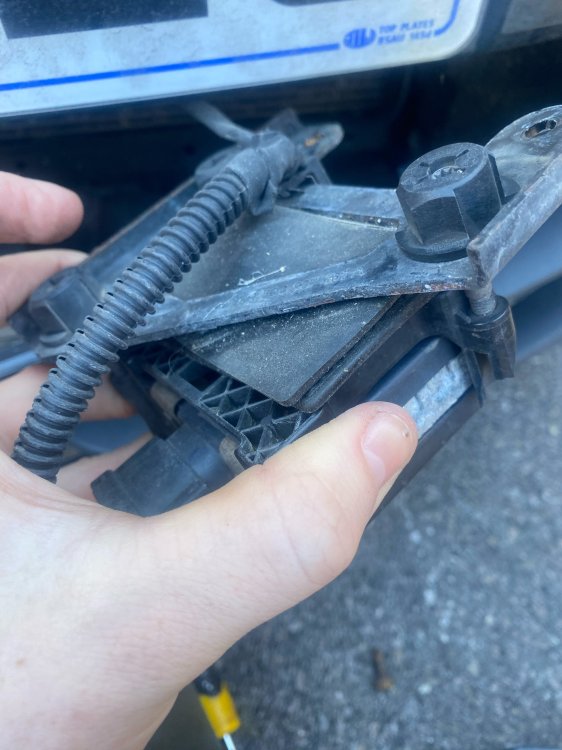

I suspect you're right. Looking behind the lower vent grill – which itself is a little damaged – a section of EPS foam is missing. No matter, none of it looks especially serious.

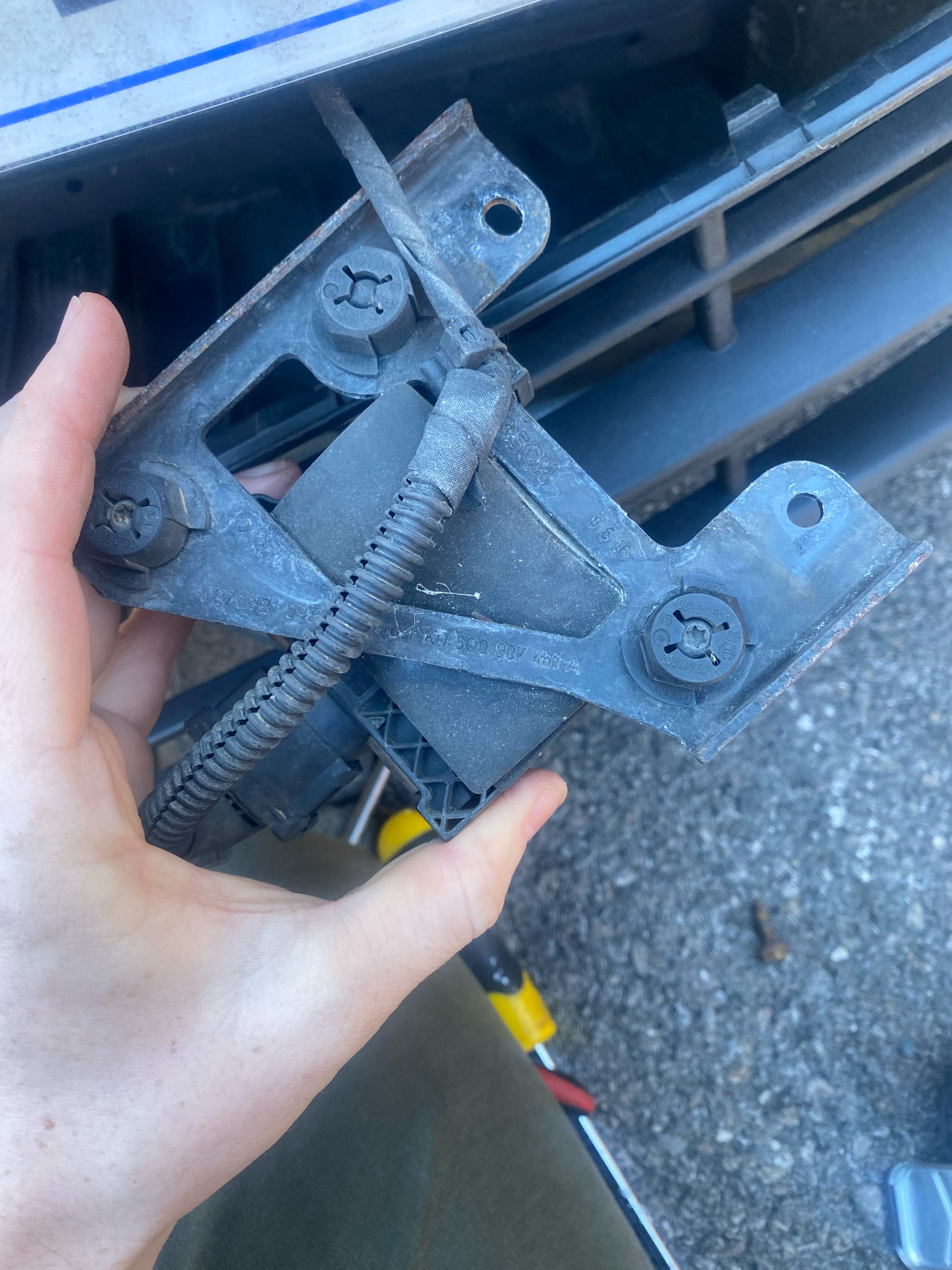

I've removed the sensor and someone has already tried to fix this issue by stuffing a rubber anti-slip mat behind the unit to push it forward. High-tech calibration!
I tried twisting the clip into the right orientation but unfortunately – and perhaps unsurprisingly – that didn't solve the problem. I'll wait until the new mounting bracket comes and have the unit recalibrated.

Is the sensor wiring ok? in the second image you have attached, it looks a little odd.
I think it looks odd because I've pulled the sensor out of the body and didn't undo the guide clip to the righthand side of the sensor, so the cable is pulled taut. I couldn't see any exposed core or wiring, so hopefully it's all fine!
