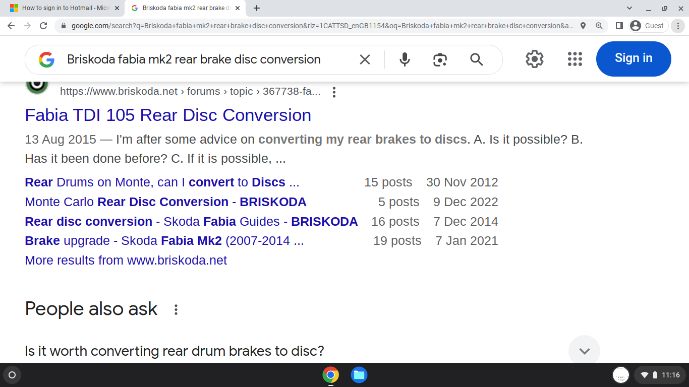

There are more threads than these posted over the past 15 years if you look for them.

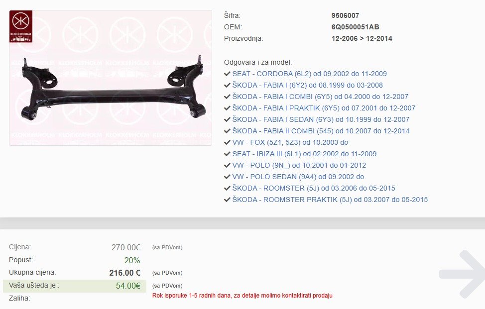

That makes me think the easiest thing to do is pull a full beam with the brakes on off an old Ibiza/Polo/Fabia.
I've not tried it on one of these cars, but on my old Polo, there was quite a bit of adjustment left in the compensator before the back end was anywhere near to going twitchy.
