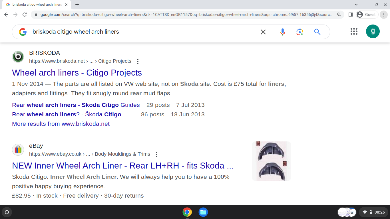

Anyone bother with the Rear wheel arch liners....not paint affected on the petrol filler but aware they cheaped out here and was thinking of giving it a good clean and fit these might be a good idea ?
A very very good clean and rust inhibitor applied before fitting, and check if the Fuel Filler area is already rusting from behind or has been painted.
