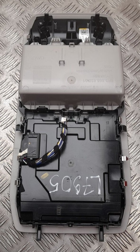

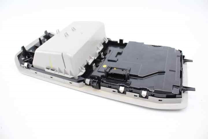

Looks like you need to start with the two clips at the rear. Then keep working along to disengage the two big clips halfway along the side. Then withdraw the unit to the rear after disengaging those two long prongs at the front.
1765686_luz-de-tejadilho-plafonnier-frente-skoda-octavia-break-de-2020-a-0-5e39595615e3868837a.jpeg
Edited by inspectorman
Clarity
You have to push the big plastic clips away and start at the front where the sunglassesholder is.. than you have to push the plastic clips at the side to release them..
